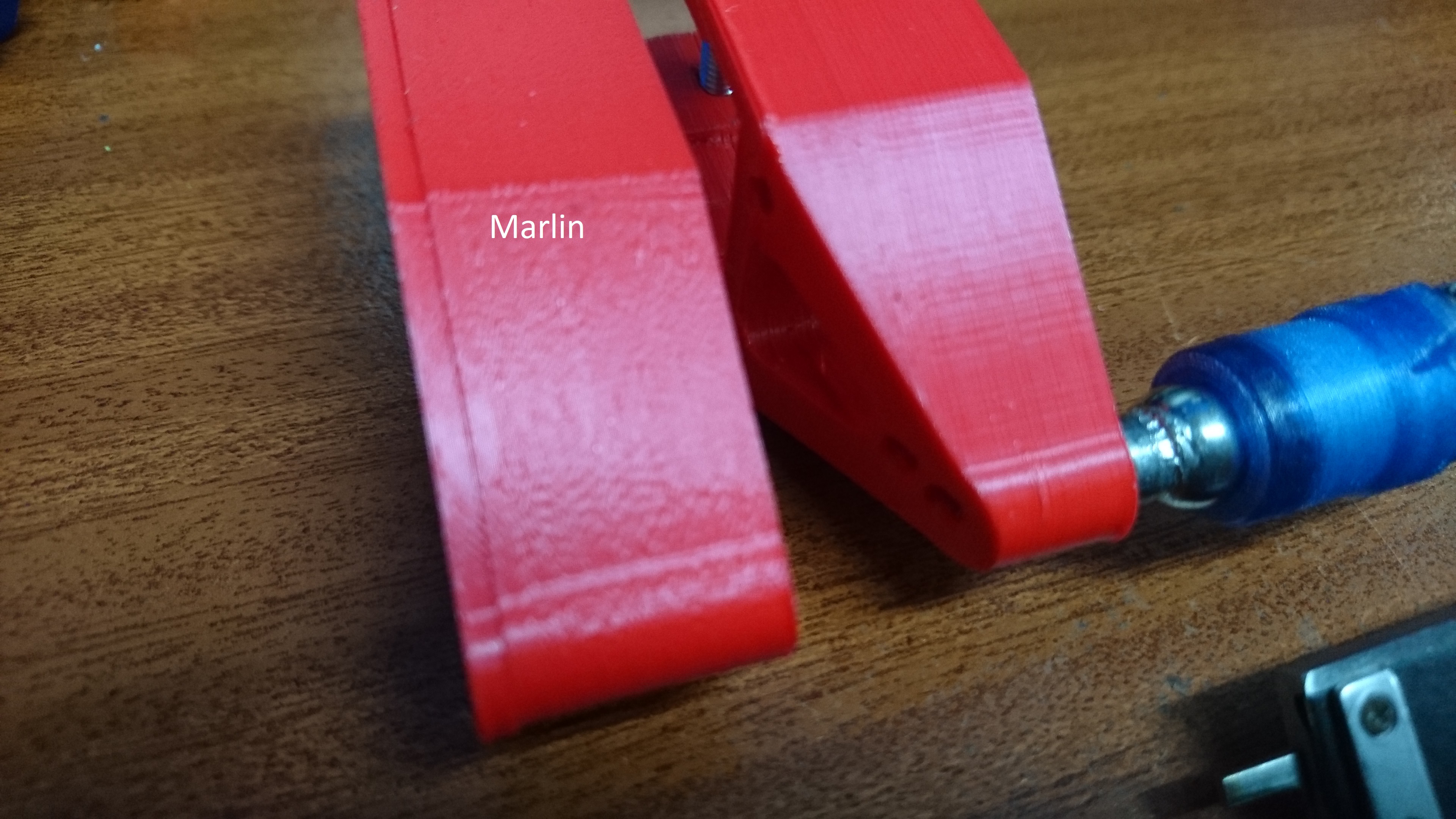

I use this tool to calibrate X Y Z steps.
CalibratorSTL.stl
(759.55 KiB) Downloaded 914 times
Calibrator3DS.rar
(39.22 KiB) Downloaded 860 times
Calibrator3DM.rar
(208.21 KiB) Downloaded 860 times
this image shows the difference between repetier and Marlin calibrated the steps x tower. 0.25mm nozzle
