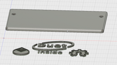

I am trying to get some understanding of Fusion, because that seems to be what a lot of people use. Coming from an graphic design angle (CorelDraw), I find the learning curve pretty steep. Nevertheless I was able to get this done already, although I must admit I cheated and made the tracing and sketchdesign of the logo's in CorelDraw and imported it into Fusion as an SVG.
This is a frontplate for my V2, which I converted to Duet recently. My intention is to have the logo's centered on the frontplate, and I want to try a live colorswitch for the first time. But I can't seem to move the logo's to the top of the buildplate (or move at all). I youtubed for two nights and found that many many people suffer the same lack of understanding. Nearly all solutions have something to do with unfix/fix, but I tried that and it makes no difference. Now I did the whole design over, and there isn't even an unfix/fix option to be found anymore.
Can someone explain in simple English what I do wrong?
The plate and the logo's are separate sketches in the browser already.

I generally try do do everything I can in a single sketch, and then extrude the different body parts separately - I think that's the easiest (since you have access to the dimension tool, constraints, fix/unfix, midpoints, etc.). So...
1. Draw everything out in a sketch: Your frame, logo and icons exactly where you want them placed on the finished piece.
2. Extrude the frame rectangle -say 4 mm
3. Extrude the logo and icons in the same direction as you extruded the frame - say 6mm. Make sure that the extrude result is a 'join'
Y
ou should now have a rectangle, with your logo and icons embossed 2mm on top of it.
Anyhow, back to your issue... When you do the 'M' (move) - are you sure that you have 'Move Object' is set to 'Bodies' (not 'faces' or 'sketch bodies')? This should allow you to move/position the logo on top of the face plate, where you can then do a 'modify-->combine' and 'join' the pieces into one. I just tried it, and it works fine for me.
Hopefully I interpreted your problem correctly... Let me know if I didn't and I'll try to help.
Rich.

If they started as two different sketches that were saved separately (AKA designs), you need to use the component mode on the move tool (Which I mostly find annoying). If you want to move the extruded 3D objects, move body. Otherwise move sketch (I cannot think of a lot of justifications for move face, which it seems to default to now, as it doesn't allow you to warp the figure with arbitrary movements like say Maya would). Another option would be to export the two as STL's, and co-position them in the slicer, which also usually works.
