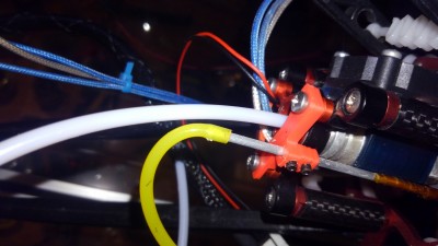

2 - I'm looking at Xenocrates pipe mount, but I'm not exactly sure how it fits on the 713 mount. Anyone have a picture?

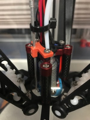

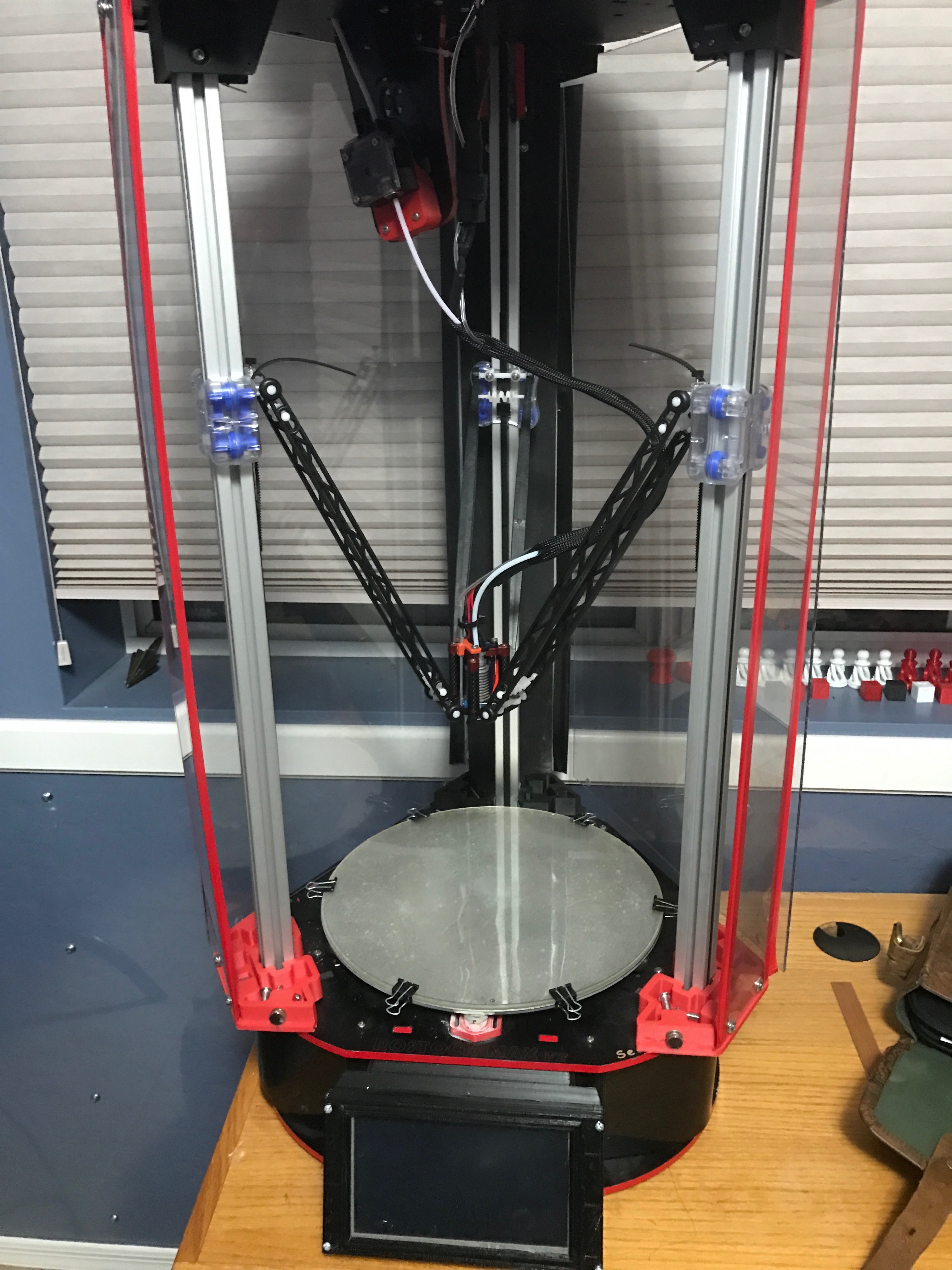

Thanks. I put on the flyback diode and used the Makerhive interface board. Works great. They were very helpful. 713maker mount is here and looks great.
The only think that has come up is that the set holes in the pipe mount don't fit my 3mm set screws... hmmm 4mm looks to big. I'll have to find a solution to hold the pipe more secure.
Thanks guys
Oops - that Zip tie needs to be tighter so it can't slide down over the tube. Its meant to control the loop in the clear tube loosely, but that's too loose!
Nice clean look to the machine. Love the ability to run without fans for part cooling.
Thanks guys
