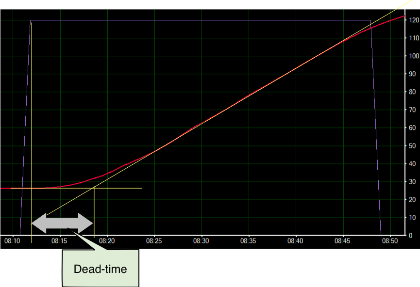

A dead-time heat manager is implemented in Repetier. It takes only two variables, which effectively describe the thermal inertia of the system. Overshoot is minimized or eliminated, and there's no oscillation around the set temp.
The idea is to figure out the "knee" of the temperature curve. Once the temperature is climbing at a relatively steady rate, you project the slope of that down to the temperature where you started. The time it takes to get from start to that intersection is put into the dead-time variable. The second variable is called "PID drive max" in Repetier, and that tells it how much power it needs to maintain the temp in a steady state. That's all it needs to know!
If I have time, I would like to try implementing this algorithm in Smoothie. (I asked the devs about this once - they were not interested in doing it themselves.) This algorithm worked very well for me when I was using Repetier. I honestly like it a lot better than PID. It seems to acknowledge that the goal in heating a radiative mass requires a precise, gentle fall-off as the set temperature is approached from below, and then "just enough" to keep it there. PID is more general-purpose, and might be the better algorithm if we were driving a heat pump (like a Peltier) rather than a heating-only circuit. It was originally designed long ago to control the rudder of a large vessel, so it would correct for current-induced drift and keep the vessel on course. The rudder on a ship can turn in both directions, but our heaters only go in one direction.

I was very content with dead time on my Rambo for the bed. I am not so sure that it works the same wonder for a hotend because of the very low thermal mass.
Because of the conversion to a duet board, I had to find a different method. Although bang-bang on the duet works much like dead-time on the Rambo, I have found PID to work even more precise. After some manual fiddling with the manual in another thread here I reached an oscillation of not even half a degree in both hotend and bed. Nice about the duet is that the PID switching frequency for the heatbed channel is only 10 Hz so any SSR can handle that. Sorry 626pilot, I know you are a Smoothie guy ;-)

When I was still on Repetier, I used the dead-time control for both the hot end and bed, and it handled both of them quite well. With my PID tune on Smoothie, I am seeing a bed oscillation of about 0.2C. I imagine the SSR is a little slower to fully change state than the relatively small MOSFET on the controller. Before I added the SSR, the heated bed was dead flat, less than 0.1 degrees C of variation. I know that Smoothie's PWM is high-resolution even for the heated bed because the bed used to "sing" when I was using GeckoTek build plates. That sound was how I knew it was done heating up! Maybe a per-channel max switching frequency would be in order, to help compensate for switching delays in the SSR.
One thing I am noticing is that setting max PWM applies to the heat-up phase as well as the steady-state phase, so I'm having to set M301 Y255 when it's heating and M301 Y130 when it's done. If I leave Y at 255, it will oscillate by about half a degree when it's hot. It bugs me, but I don't know how much it really matters. Mostly, I don't want to hear the fans accelerating and decelerating because of swings in current consumption.
