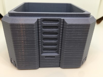

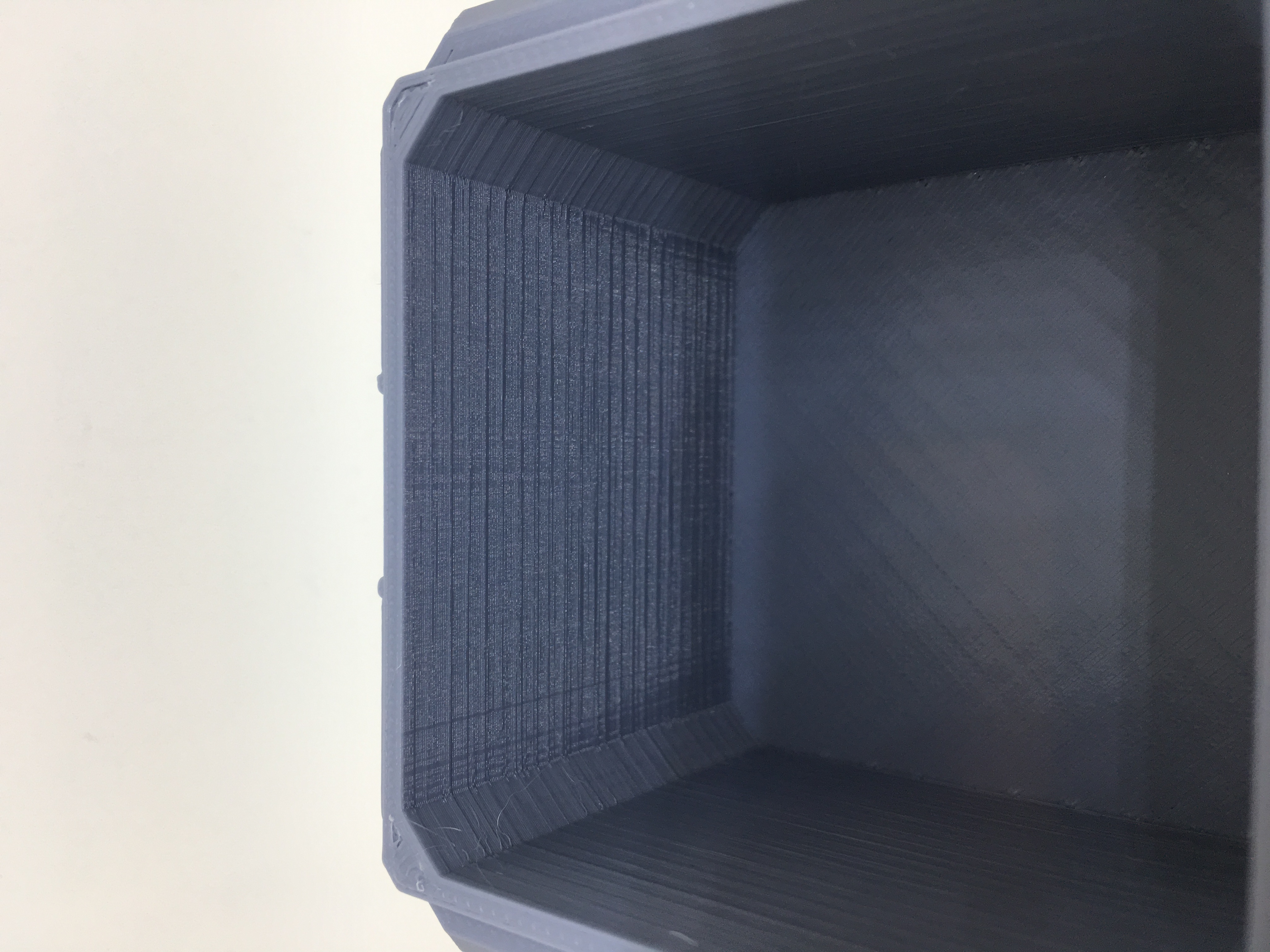

Hi All,

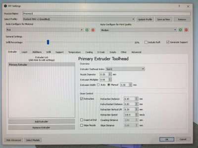

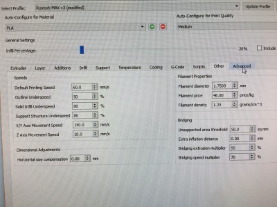

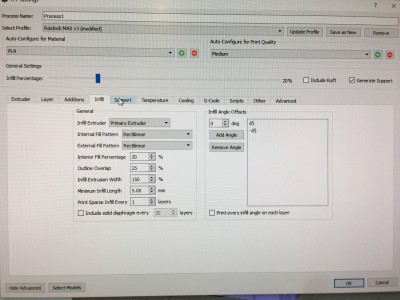

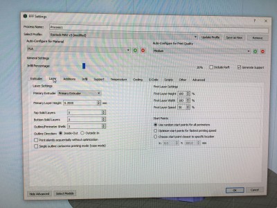

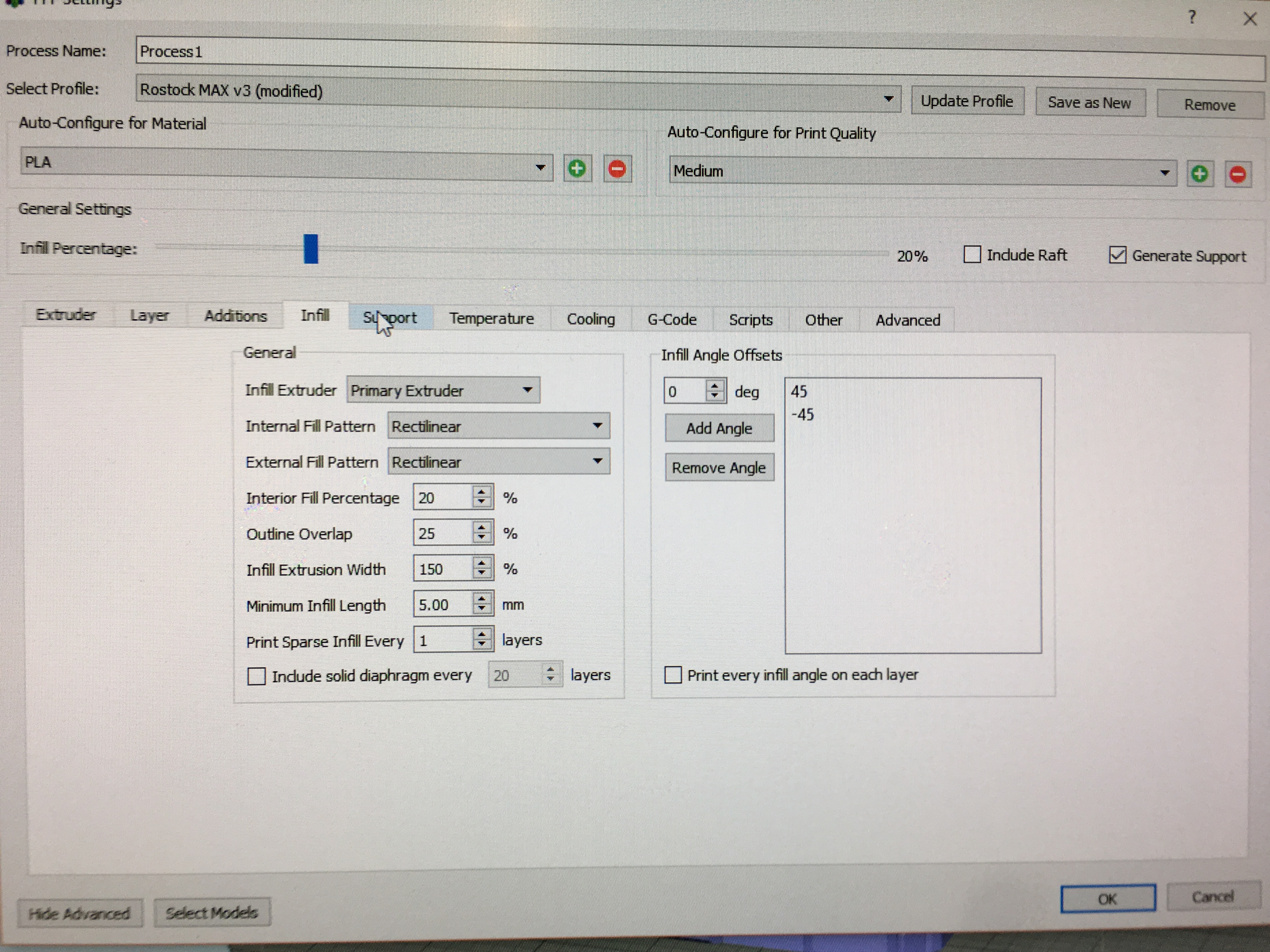

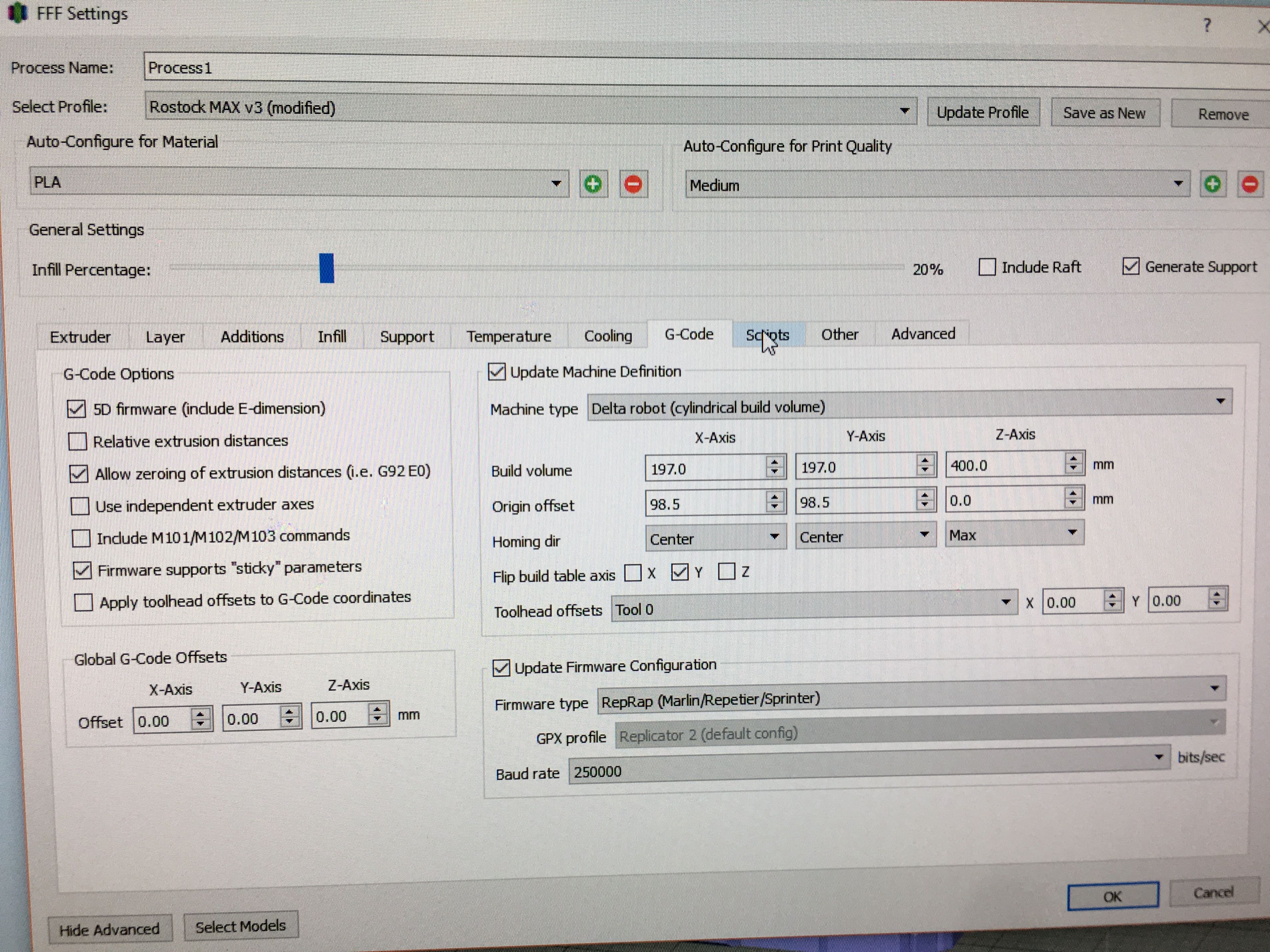

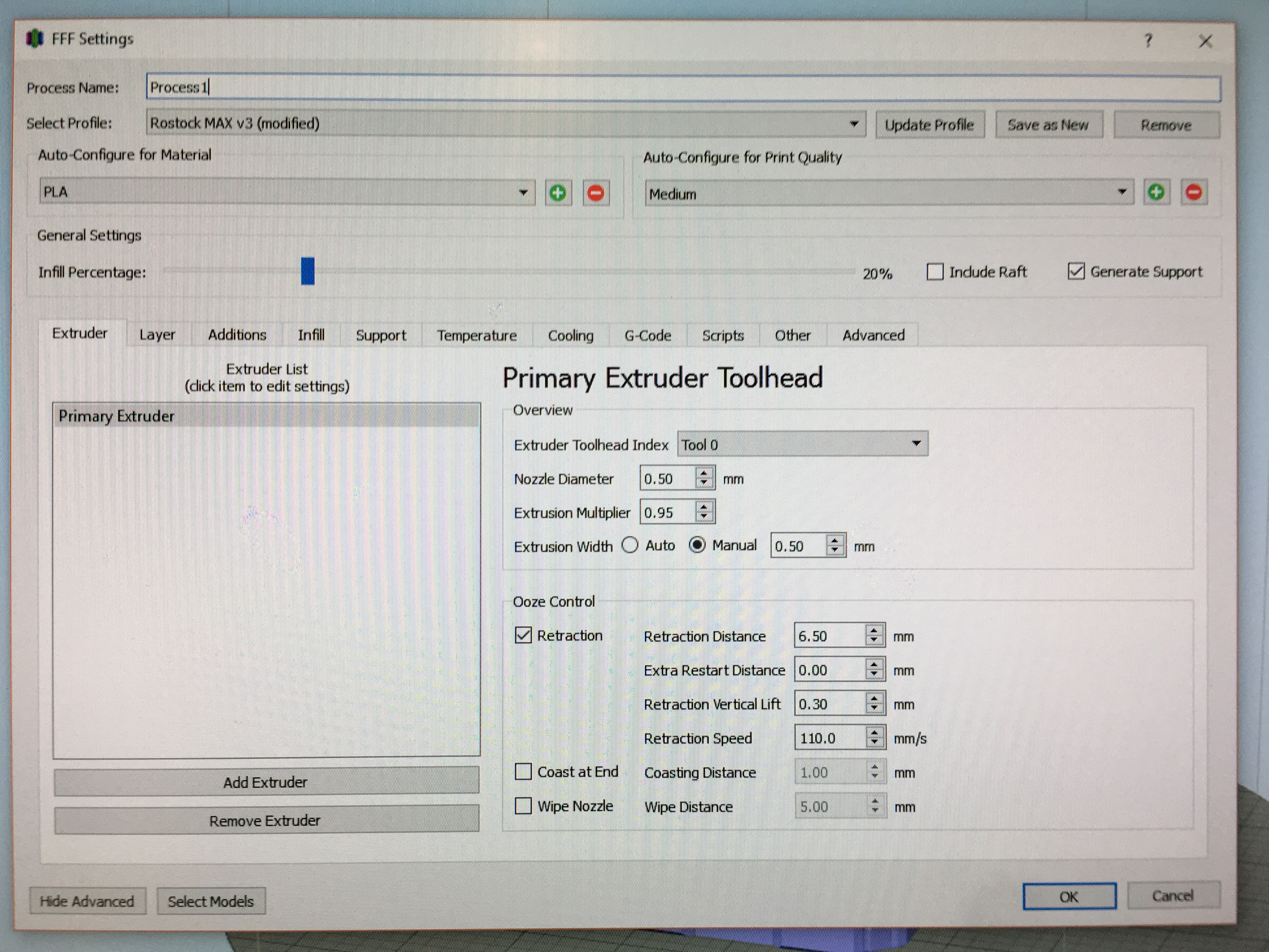

Have a weird layer issue going on with my new Rostock Max V3. I've attached pics of what it looks like and pics of my Simplify3d settings. I didn't notice it in my first set of prints which were all calibrations and benchy's, but it is showing up in anything larger than a calibration cube.
The box in the pic is 3.25" all around for reference. I can troubleshoot the heck out of some Cartesian printers, but this is my first Delta rodeo so I'm head scratching st what could be the cause of this.

Given how it changes frequency as the perimeter changes, but otherwise is regular, I'm wondering if it might be flex in the bed due to oscillations in temperature or power delivery. Do you think you could graph the bed temperature, or use a gauge on the printhead to watch for the flex? In extreme cases, this has been visible without magnification as a sorta breathing effect, but it doesn't look that bad here.
Re: Rostock Max V3 Weird Layer Issue
Test print a simple cube - say 50mm or so - with a face parallel to the y axis. Then rotate it 45 and print. I wouldn't rule out a mechanical issue like a loose pulley, loose belt, or other issue with part of the drive train. The test above will help isolate if it is correlated to a specific tower.

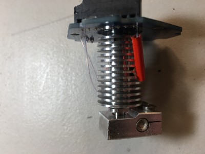

Thanks gentlemen, I will try both out just as soon as I fix my hot end. I broke PLA off in this heat sink doodad and can't figure out how to get it out. Attached a pic, smack dab in the middle is a nice chunk of broken PLA.
I forgot to mention earlier that the layer lines are uniform on all four faces. Not sure if that helps troubleshoot. Thanks!!!

Scratch that filament issue, I took the hot end apart to get to the heat sink, clog gone. Of no fault of SeeMeCNC, but this build has taught me tons of things I never knew or had to deal with, mostly due to my own stupidity.

Just to follow up and embarrass myself even more, the layer issue was ultimately because I didn't tighten the top portion of the Z tower down. The bolts and t connectors were all loose and flopping around. Another reason why I'll never pull an all nighter to build a printer again.
