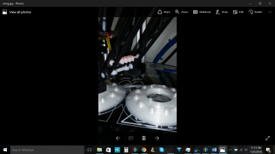

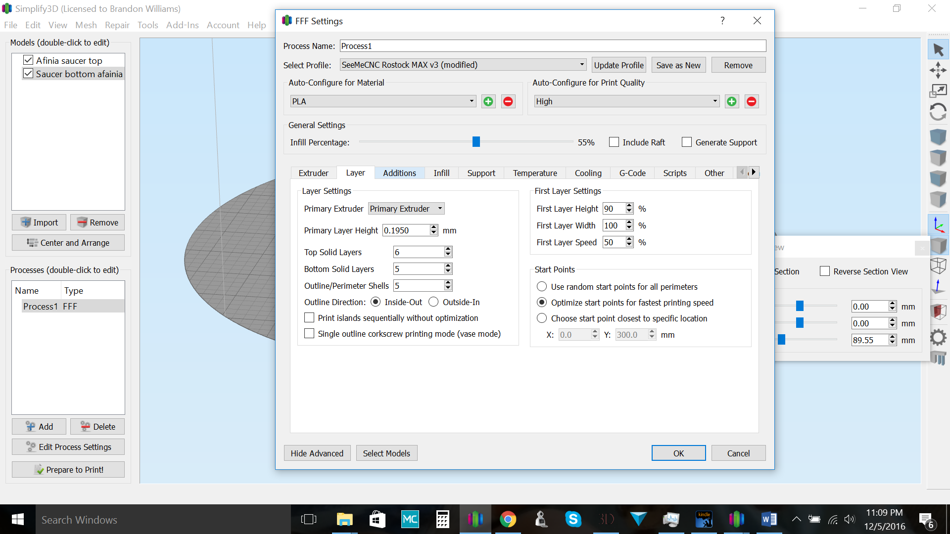

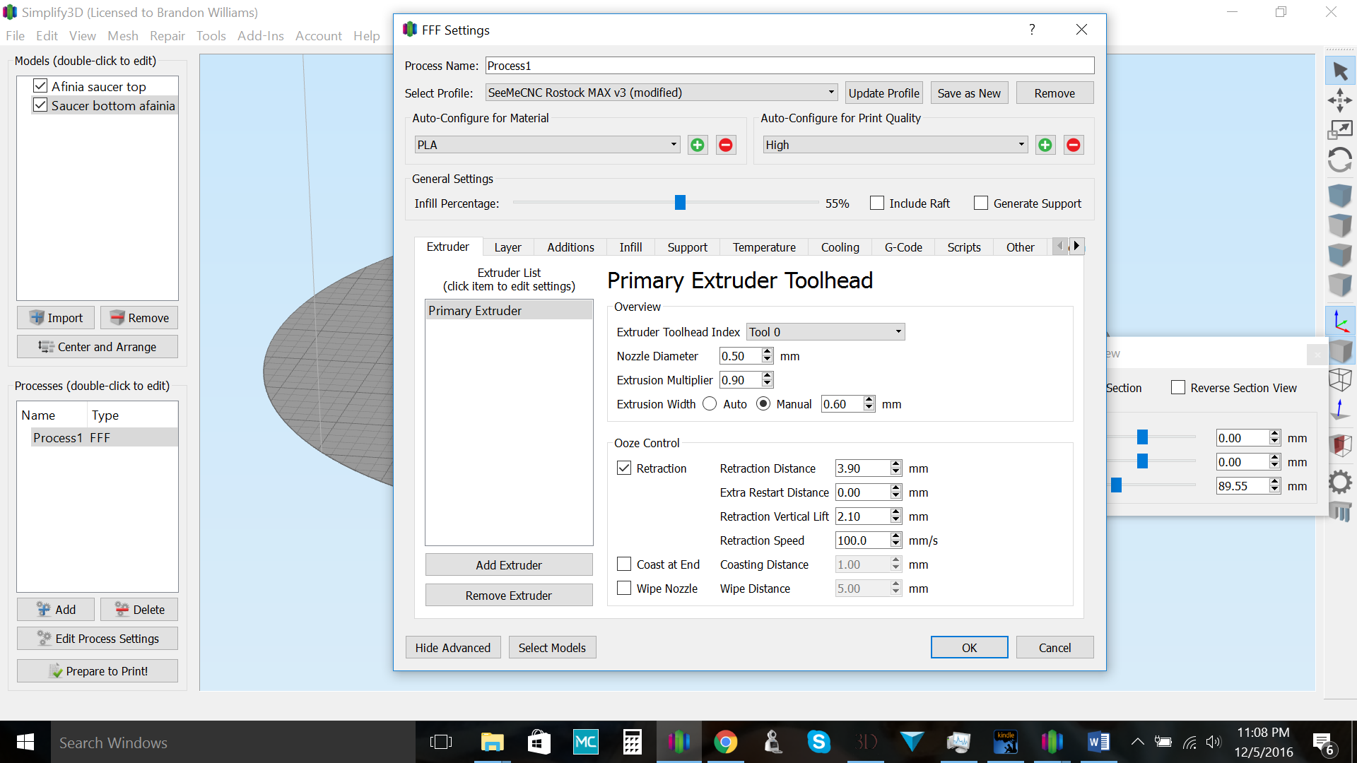

Hey, I'm having trouble with my S3d settings and the amount of stringing occurring. If I go above 6mm retraction distance, the extruder nozzle seems to clog really quick and the filament is grinded down in spots. I have attached a screenshot of my s3d settings and a pic of my print. I welcome suggestions and tips please!
Thanks for your help

Pic of stringy print
Posts: 5359
Re: Super stringy prints, help!
With the HE280, you have to limit your retracts to no more than 2mm @ 25-35mm/sec. Anything longer or faster is begging for jamming problems. It has the same retract length & speed requirements as does the E3D v6.

Any other setting you'd recommend other than that? I tried that and still TONS of stringing.

What material and temps are you using? I was having pretty bad stringing problems with the PLA I got from SeeMeCNC with my printer. I was using mhackney's default settings for KISSlicer at first and followed pretty much all the recommendations I could find online (increase retract length/speed, increase non-print movement speed, lower hotend temp, etc.) without much luck. What finally helped was reducing my z-lift from 4mm to 1mm. After that the stringing disappeared almost completely...
