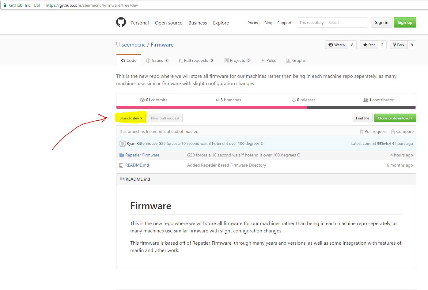

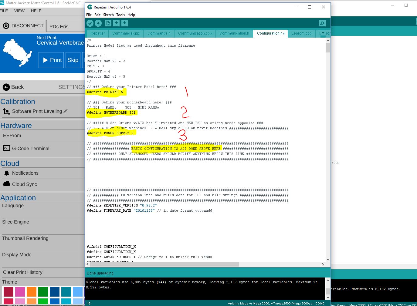

Here's a couple notes if you're going to venture into this. All of our printers at the shop are working great with the DEV branch as of TODAY !!
1) open arduino then File>Examples>EEPROM>eeprom_clear
2) connect printer and upload eeprom clear to erase everything on your RAMBo

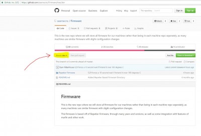

3) open the new DEV downloaded from github.com/seemecnc in the arduino editor
4) for Rostock MAX v3: make sure the PRINTER 5, MOTHERBOARD 301, and POWER_SUPPLY 2 are selected. Change nothing else anywhere, I don't care what you read on the forum. :)
5) upload the new firmware to your printer
6) make sure there is no plastic on the nozzle, bed is clear, and all heat is turn off at nozzle and bed. Also check for flatness of your bed.
7) insert the SD card (for reasons)
8) from the LCD: ADVANCED SETTINGS>CALIBRATION MENU> FULL CALIBRATION> BEGIN CALIBRATION
Please share results here if you are going to try it. Eventually, DEVelopment code will be merged into the master.
