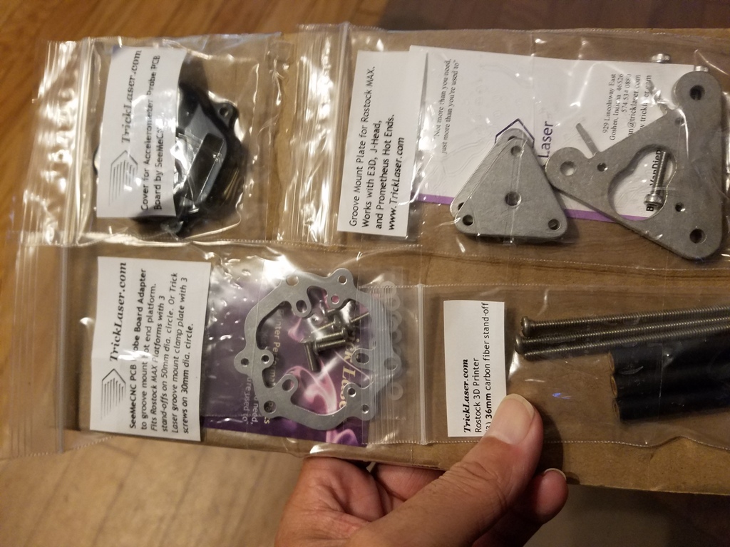

I think the solution is in-house. This plus the E3D should do it.
I will update this thread when we do it (probably tomorrow)
We had to go with TrickLaser since the other folks never would respond to requests.

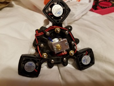

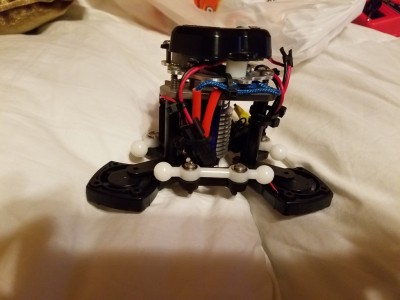

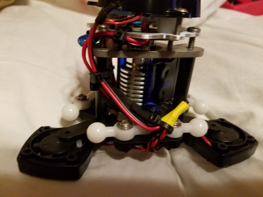

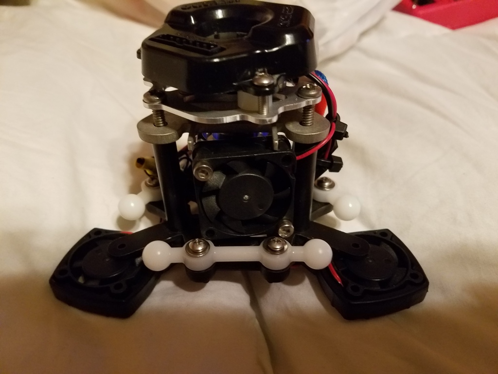

Did the swap on the spare effector we had. Pictures attached. Loots great.
It is a nice upgrade. Redid the autoleveling config as well.
BUT IT DID NOT HELP :(
I am not sure what is wrong, but I know what it is NOT:

Just as an aside, the kit for the E3D hotend was an easy one to put together and assemble. Everything worked well. We had to order the following:
Probe Board Adapter Item# PB-ADPT
Hot End Groove Mount for Rostock MAX Item# RM-JHGMNT
Carbon Fiber Tube Stand-Offs 36 MM Item# CFSTAND36
That was all that was needed to get it to adapt since we reused the parts fan mount and fans. They sell a CNC version of that as well for a bit more if you want it.
We landed the heater core and thermistor wires onto the electronics/accelerometer board the same way the stock stuff lands. Editing the thermistor type in the firmware to match what E3D supplies and good to go
