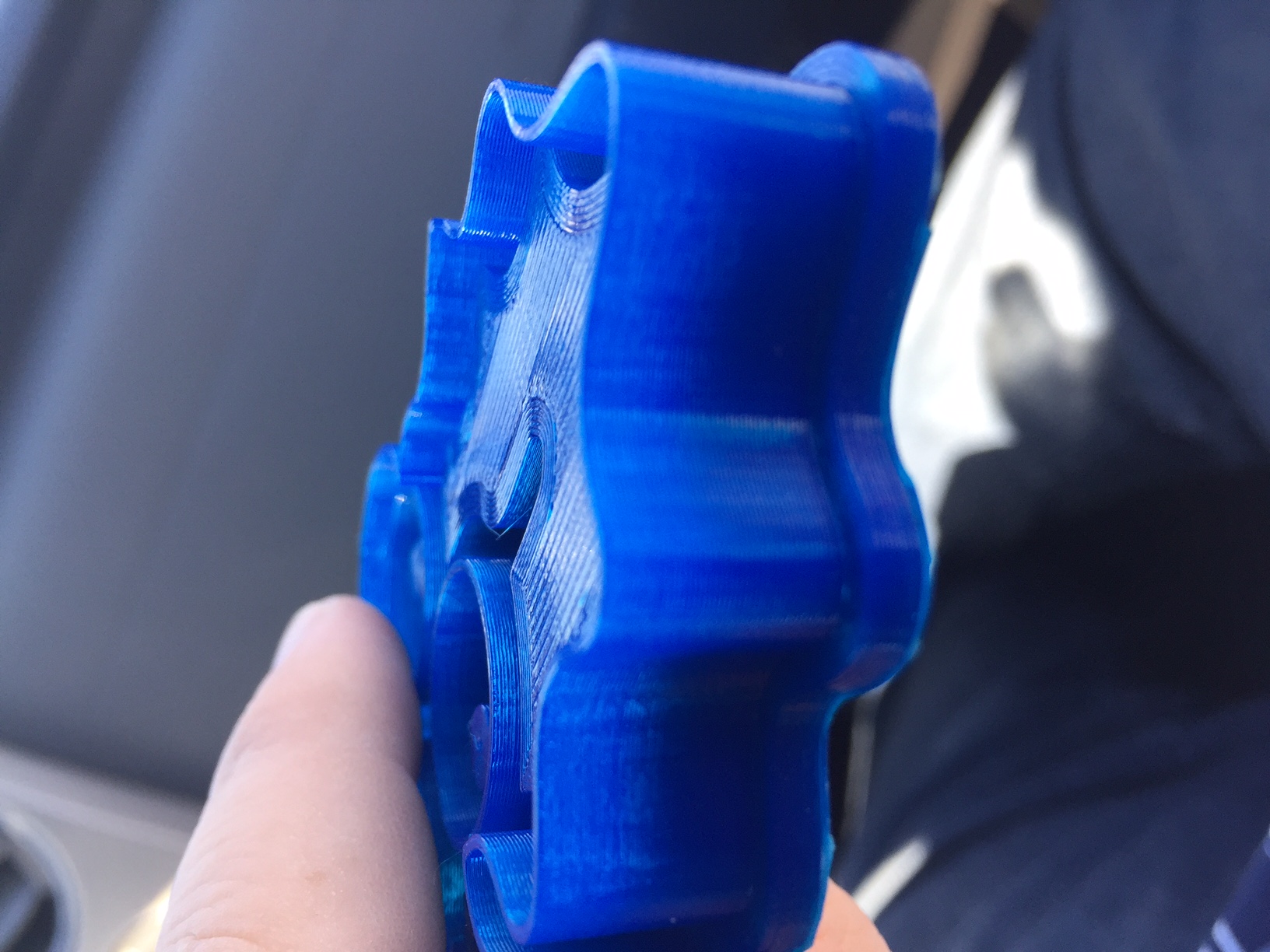

Just wondering if there is anyone out in Southern California that may be willing to lend me a hand with getting my printer in calibration. If you look at my previous posts it has been a hectic ride with this thing. I am willing to pay; I just want to get it working. I am pretty sure it has to do with tower lean. I tried to get it out by loosening the towers and pulling them in place but that didn't do much. Just bought some turnbuckles and cable. Going to give that a try.... I am getting so frustrated at this point cause I feel that I am so close to getting it working but cant catch a break.

AcidShock, to check for tower plumbness don't compare to the bed, remove or move the bed out of the way and check the square of the tower to the melamine top plate. Check all 3 top and bottom. I know you reported that you did this in your other thread but your results were odd and I suspect you were squaring against the glass plate.

Thanks Ramai! I appreciate the willingness to help. I did link up with gestalt73 from the forum. Turns out he prints a lot of stuff and happens only to be about a mile from where I live. We got the thing working amazingly now! Turns out there was a whole slew of issues. One of the towers was off a bit which was suspected, the weird part was it kept going back out of true. We kept messing with it and eventually got it to true up. Also the print head was a bit loose. It was also just ever so slightly loose in the effector mount. There was also some issues with the power supply too. Ultimately though he ended up upgrading me to the duetwifi, which I must say is AMAZING! The loudest thing on the printer now is the hotend fan lol. We have it doing auto calibration on 36+ points. In addition gestalt73 ended up giving me a bunch of others tips and ideas on how to perfect my prints. Overall he really helped me out. I am greatly indebted to him. He went so far above and beyond. Thanks gestalt73!
Some example prints attached also a youtube video.
