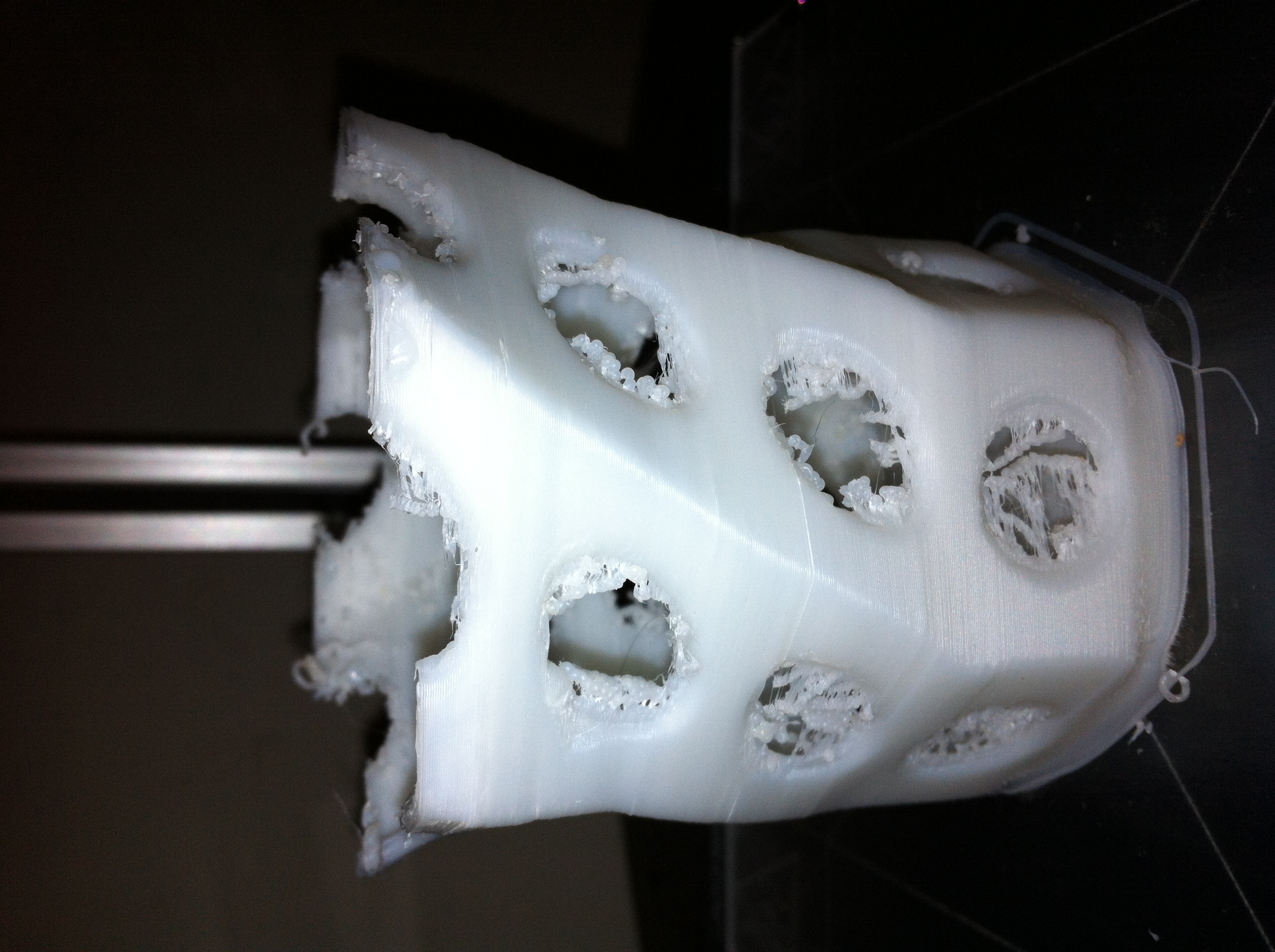

A couple pics of a vase I half printed as it started to come loose at the lines across it in certain spots which you can see.

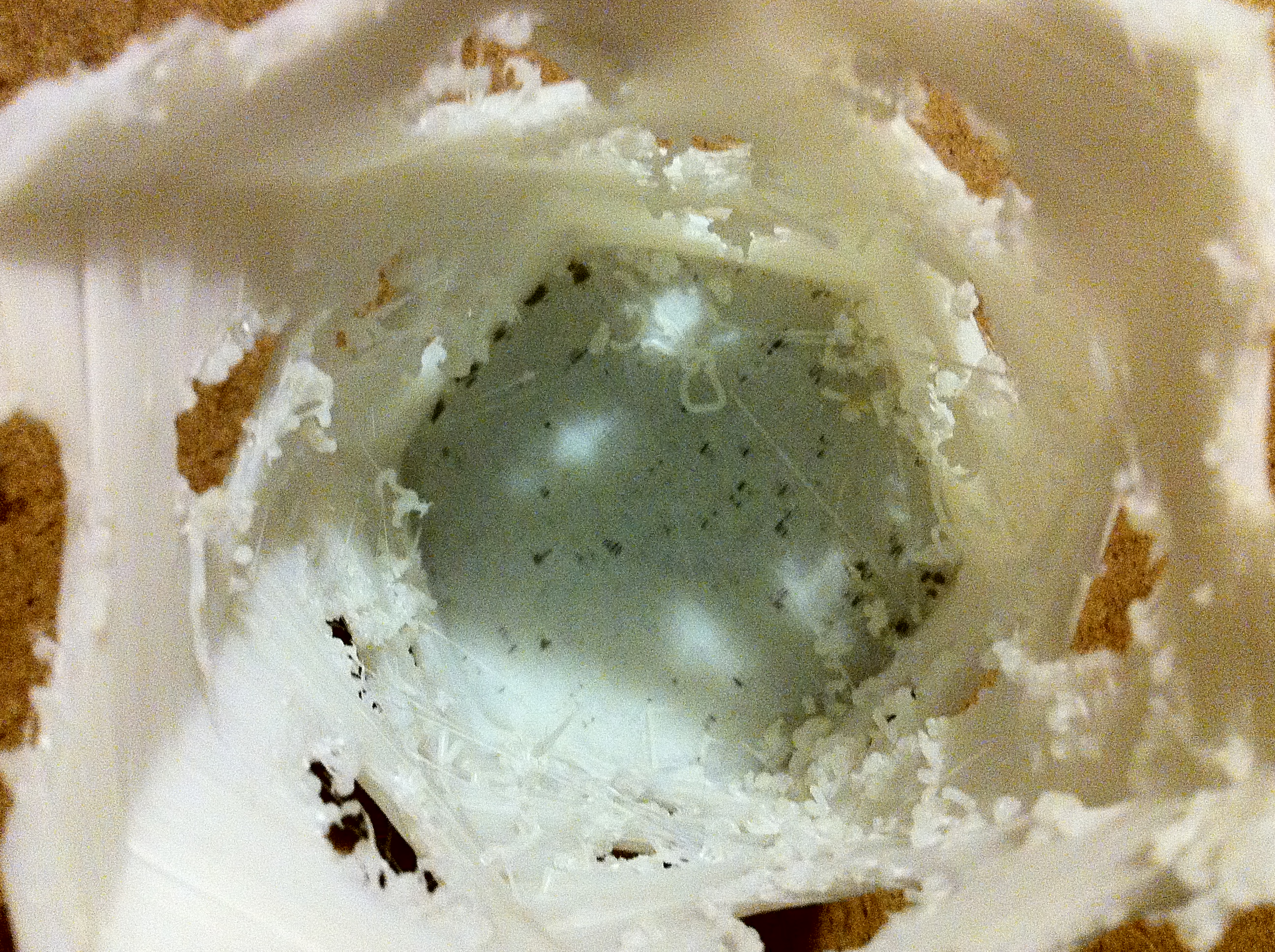

Also the obvious rattiness of the holes with curled material everywhere.
I tried messing with retraction settings from 4 up to 10 but similar results.
Hot end temp 210.
Bed 75 first layer 65 other layers
Speed Multiply 70%
Flow Multiply 100%
Any idea's what I can do at this point?

my first thought is something is slipping in the retract direction. Where you have positive output it looks good. It's just the extra between.
what is your retract speed?
is the idler tight against the gear in the extruder pinching the filament?
when hot but not printing, are you able to retract at those settings manually from the host software?

I agree with the previous poster the first thing to determine is if the retract is working as expected.
It's easy to think it is, but it's actually either stalling on one half of the move or in my case the filament was slipping a small amount during the retract.
Mark the gear and ensure it's returning to the original position, run some simple test pieces at various retract speed and lengths to figure out what's working, in general things should get better the faster the retract, but at some point, they will deteriorate because something mechanical is causing it to fail.

I agree with the above posts on retraction slipping. When my son was completing the H-1.1 for his senior project (see post in Build forum) he had a similar issue. I placed a black mark with a Sharpie on the frontmost extruder gear so I could see it in operation. Turns out, the stepper was stalling on retraction. Simply slowing it down fixed the problem. So in addition to slipping filament, check that the extruder is actually moving in reverse during retraction!

OK I set the Retraction to 2 and it's much much better!
thank you all!
Regarding the Stickiness, I tried all this many times and still nothing.
I even used HONEY! Super sticky, but never stuck.
The solution was the temperature wasn't hot enough in the hot end. I put it to 235 and it started to stick well, 240 was best.
The bed is 60, seems it doesn't need to be too hot as long as the material is hot enough.
