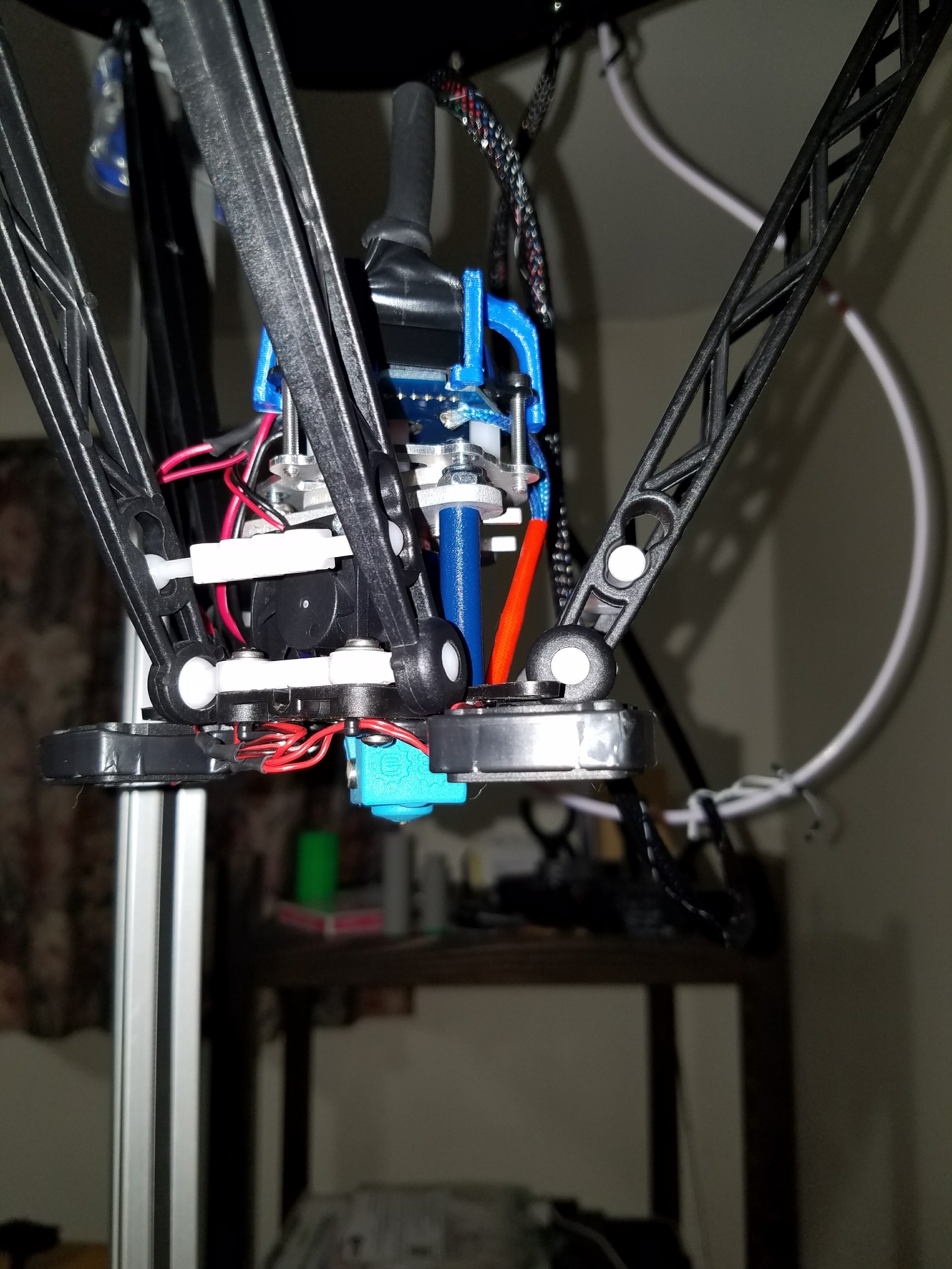

I'm in the middle of upgrading my v2 all the way to a v3. I had/have a E3d v6 that I was using for my v2.
This thread is listing exactly what I want to do, take the whip and accelerometer and use it on my new v3 build.
But I'm having a hard time telling where my wires would get soldered into the board. Since I bought the accelerometer separate and the whip separate, it doesn't have the two white plugin things either, just the main pin connector.
So I need to know how to plug/solder in my heating leads, fans, thermsistor, etc.
Or is it exactly the same as their instructions for their hot end?
If so, anyway I can get around using the white clip pluggin things for the fans since I don't have them?
Here is a picture of how my accelerometer arrived.

by djkirkendall
The wiring is really simple. The pair marked "HE" goes to your intercooling fan for the heat sink.
The pair marked "part" is for layer fans.
The opposing single lines on the side of the center hole are for the heating cartridge.
The pair next to the Part pair is for the thermister.
There's a pair marked "+" and "-" with a screw hole inbetween, this is a 12VDC tap that be repurposed. I use mine for a 80mm LED light ring. I put kapton tape over the soldered connections to prevent the screw from shorting it out.
You can solder all of the connections directly to the board (through hole). I found soldering them from below makes for a clean installation using the E3D mounting hardware.
This thread has a schematic: http://forum.seemecnc.com/viewtopic.php?t=10876
