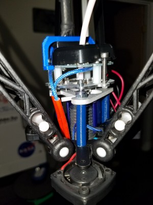

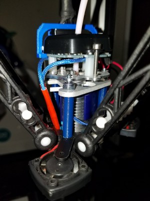

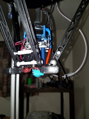

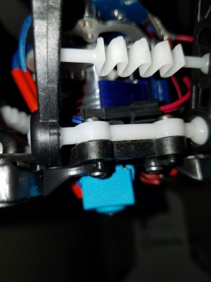

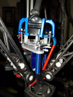

I got mine assembled last night. I wish that it was a little easier to route and hide the wires on, but it'll work. I still need to wire up the new harness before it will work.
I decided to solder the disconnectable leads from E3D to the board so that I can replace components in the future without having to solder (except for the heater cartridge). The connectors are larger than I'd like, but at least it'll accomodate plug and play replacements.

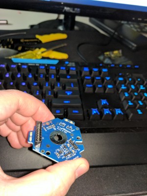

Here is a picture of how my accelerometer arrived.

The wiring is really simple. The pair marked "HE" goes to your intercooling fan for the heat sink.
The pair marked "part" is for layer fans.
The opposing single lines on the side of the center hole are for the heating cartridge.
The pair next to the Part pair is for the thermister.
There's a pair marked "+" and "-" with a screw hole inbetween, this is a 12VDC tap that be repurposed. I use mine for a 80mm LED light ring. I put kapton tape over the soldered connections to prevent the screw from shorting it out.
You can solder all of the connections directly to the board (through hole). I found soldering them from below makes for a clean installation using the E3D mounting hardware.
This thread has a schematic: http://forum.seemecnc.com/viewtopic.php?t=10876
Re: Rostock Max v3 upgrading to e3d v6 hot end?
I had to wave the white flag on the HE280. I tried all the tricks and for whatever reason I just couldn't stop that plastic puck from forming under the PTFE tube after a few prints. I wanted it to work because I thought it printed really well but it got it the point I had to remove the PTFE tube after every print to remove plastic. Anyway I also had to go with Ole Reliable the E3D-V6. I ended up ordering the mount from tricklaser.com but the carbon tubes were a little long (I will cut them down later and refit them) but I have another 3D printer and printed out the tubes using this MG-94 High Performance ABS that I got in one of my Maker boxes. I will admit I could have done a better job with the wire management but seriously after all the failures just wanted my machine printing out big stuff already. So far really good.
