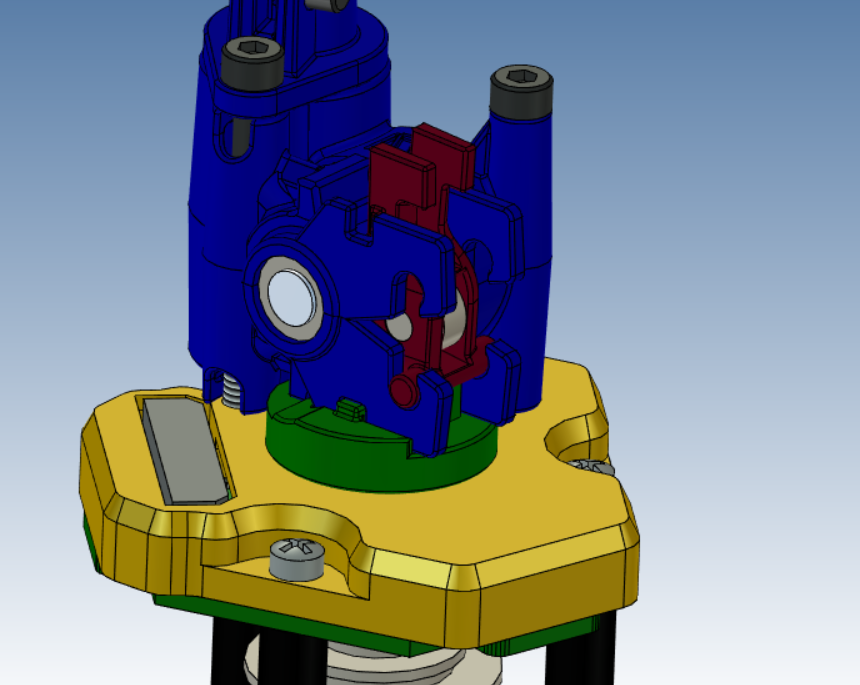

Re: Zesty Nimble extruder technical thread
I've been exchanging emails with Lykle at Zesty about mounting on the V3 since it has the new HE280. A couple of back and forths and he has come up with a nice solution he calls the Mad Hatter! It's still a draft and I hope to get the STLs to print and test fit on my V3. I had test fitted an earlier design for the V2 Rostock and it, of course, won't work on the V3. This design is printed in 2 parts. The gold part is the cap (or Mad Hat!) and the green part is the Zesty Adapter.
Once the design is finalized, it should be very easy to mount the Nimble on a V3.Sublime Layers - my blog on Musings and Experiments in 3D Printing Technology and Art
Great, while I was writing the above Lykle sent me the STLs to print and test. I'll do that as soon as a printer frees up.
We aim to please.
The overall shape is good, I think I will want to see if there are tweaks needed in the support structure inside the Mad Hat, to support the Nimble.
Lykle
HI Qdeathstar, thanks.
You know we have an adapter plate ready for the Cyclops/Chimera hot end, right?
It is in the Shapeways shop. We will also be making a DXF file available, so you can download it and have it waterjet cut if you prefer.
We will be publicizing the list of adapters we have available and/or working on soon. In fact, on Tuesday.
