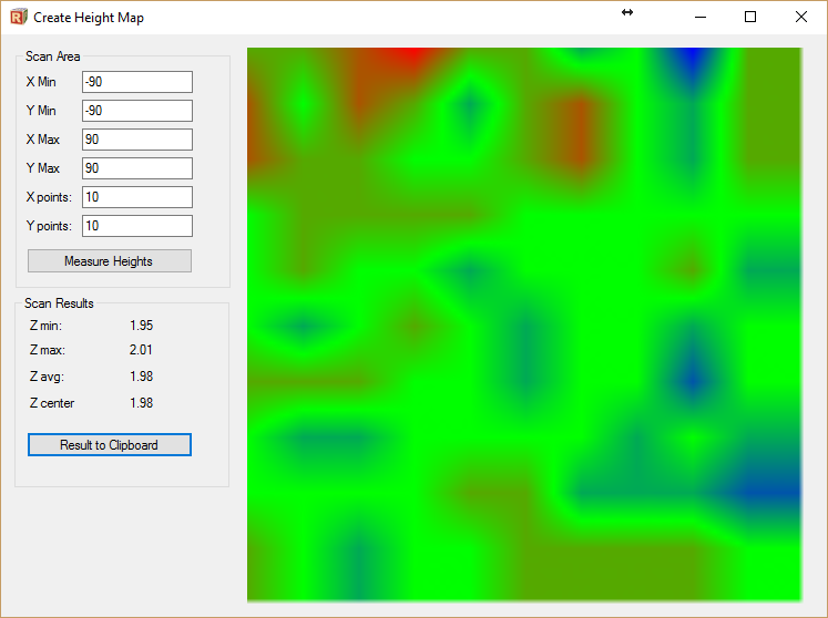

These are my results after using Repetiers distortion correction:
Probing with 10 points results:
Point 0: +0.08mm
Point 1: +0.04mm
Point 2: -0.01mm
Point 3: -0.04mm
Point 4: -0.06mm
Point 5: +0.01mm
Point 6: -0.01mm
Point 7: -0.04mm
Point 8: -0.02mm
Point 9: -0.03mm
Bed height Measurements:
Code: Select all
X: -90.00 -70.00 -50.00 -30.00 -10.00 10.00 30.00 50.00 70.00 90.00
y:90.00 1.99 1.99 2.00 2.01 1.99 1.99 1.97 1.98 1.95 1.99
y:70.00 2.00 1.98 2.00 1.99 1.97 1.99 2.00 1.98 1.97 1.99
y:50.00 2.00 1.99 1.99 1.98 1.98 1.99 2.00 1.98 1.97 1.99
y:30.00 1.98 1.99 1.99 1.99 1.99 1.98 1.98 1.98 1.98 1.98
y:10.00 1.98 1.99 1.98 1.98 1.97 1.98 1.98 1.98 1.99 1.97
y:-10.00 1.98 1.97 1.98 1.99 1.98 1.97 1.98 1.98 1.97 1.98
y:-30.00 1.99 1.99 1.99 1.98 1.98 1.97 1.98 1.98 1.96 1.98
y:-50.00 1.98 1.97 1.97 1.98 1.98 1.98 1.98 1.97 1.98 1.97
y:-70.00 1.98 1.98 1.98 1.98 1.99 1.99 1.97 1.97 1.97 1.96
y:-90.00 1.99 1.98 1.97 1.98 1.98 1.99 1.99 1.99 1.99 1.98
The only thing I am hesitant to use the distortion correction because this only corrects the first layer. And it doesn't really appear to do much looking at the 10 point probe.
Is there any other way to improve my calibration results?
Any input is appreciated.
I can print small (<100 mm diameter) objects fine, but anything larger and the difference in height comes into play and causes first layer adhesion problems.
