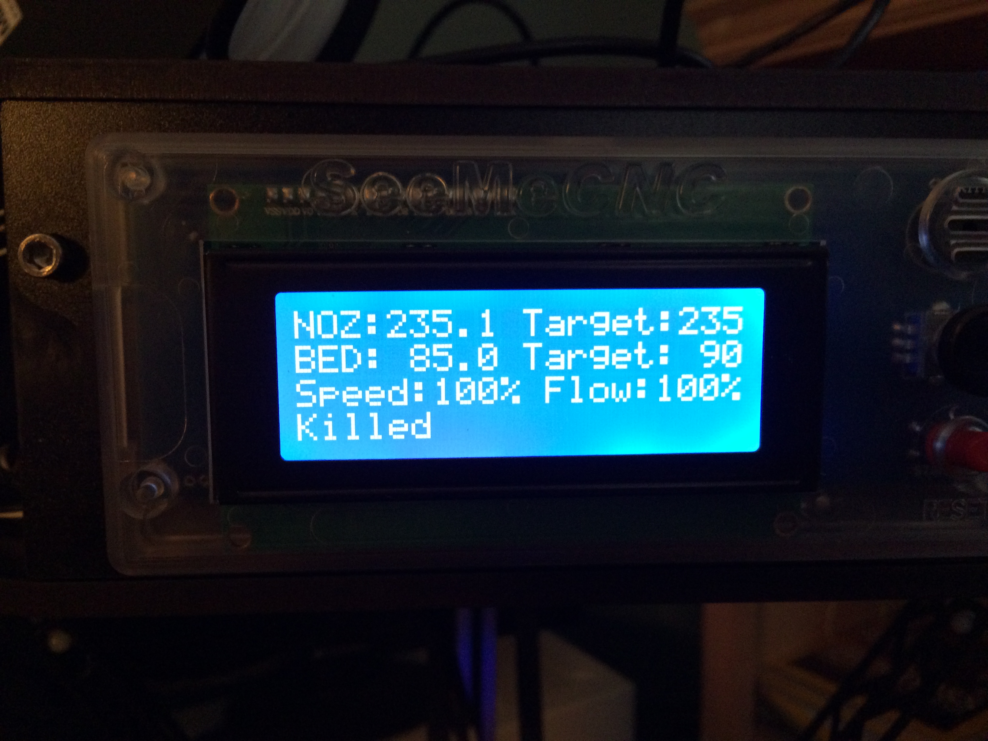

So, yesterday I had a problem while doing a test print wear a half hour into the print both thermistors went to DEF. The print kept going, unfortunately, even though there was no heat to the hot end. Upon cycling the power the thermistors immediately came back. So I went along to print another sample print to see if I would have the same error and to start trending issues since I'm new at printing.
This morning I set my printer bed heat to 90 manually and the hot end heat to 235 manually so that it could come up to temperature before I probed and did another test print.
After leaving the room for about 15 minutes allowing it to heat I came back to the LCD panel saying "killed". Everything seem to be functioning except for the heat. Again, the heat cut off just like when the thermistors went to DEF. I ran the probing code and it tapped the center, went to the Y tower and then froze. LCD panel unresponsive. Reset button did not work. I had to cycle power at the power supply.
Any ideas? Anyone see this at all?
"Killed" on the LCD!?

The key to your "Killed" message is just a safety feature for if your printer is left heating unattended for too long, and the timeout for this feature can be changed within the firmware settings.
It is basically a "Did I leave the oven on?" fail-safe.

Re: "Killed" on the LCD!?
Power cycle the printer. All the memory that gets consumed as the printer operates (With the exception of a small number of fixed length EEPROM values updating), is in RAM, and thus volatile.aodhan wrote:
You can A) Increase the firmware timeout, B), twiddle the knob. Killed is only when it is heating to targets without a print job or user interaction. For example, mine has spent 4 hours heating to target when given a print job (It was really cold that day, and i just left it to warm up), and if you are actually working with it by touching the encoder and twisting or clicking it, it will happily continue to function. Timer based only.aodhan wrote:Thanks for the detail, Xenocrates. That's very helpful for a mind like mine that needs to know "the why".
It will also say "Killed" if the printer has sat idle for a long enough period of time after the last movement command was received.
Yeah, I see the "killed" message on over night prints that completed successfully. Glad to know the origin.
