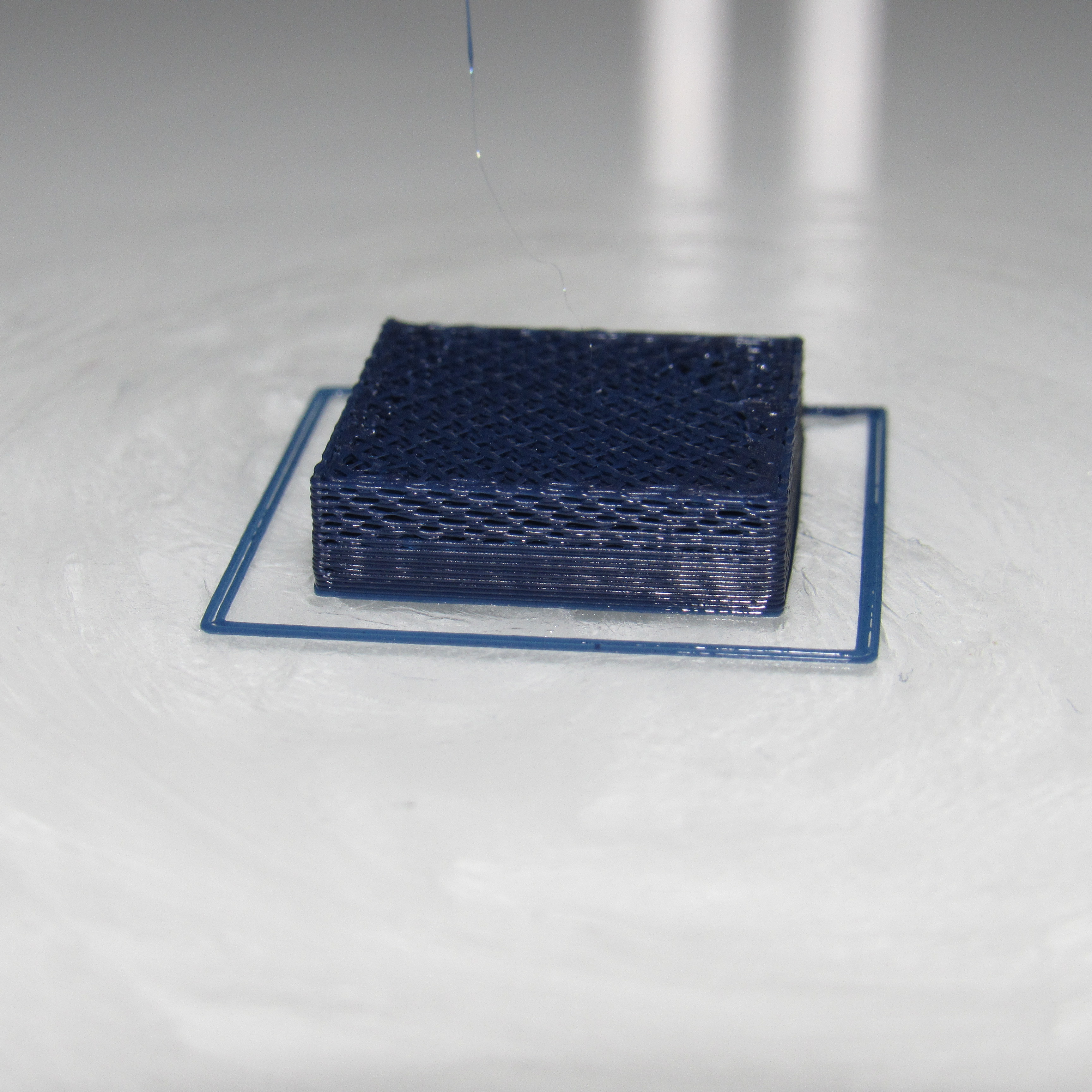

When the print started it printed at a blazing speed and about half way through the print I heard it start to skip. I concluded that it skipped while putting down the infill for the cube.
Here is a picture of the cube after I canceled the print.
I hope this information is helpful to finding the cause of my problems.
Sincerely,
J.D. Cordero

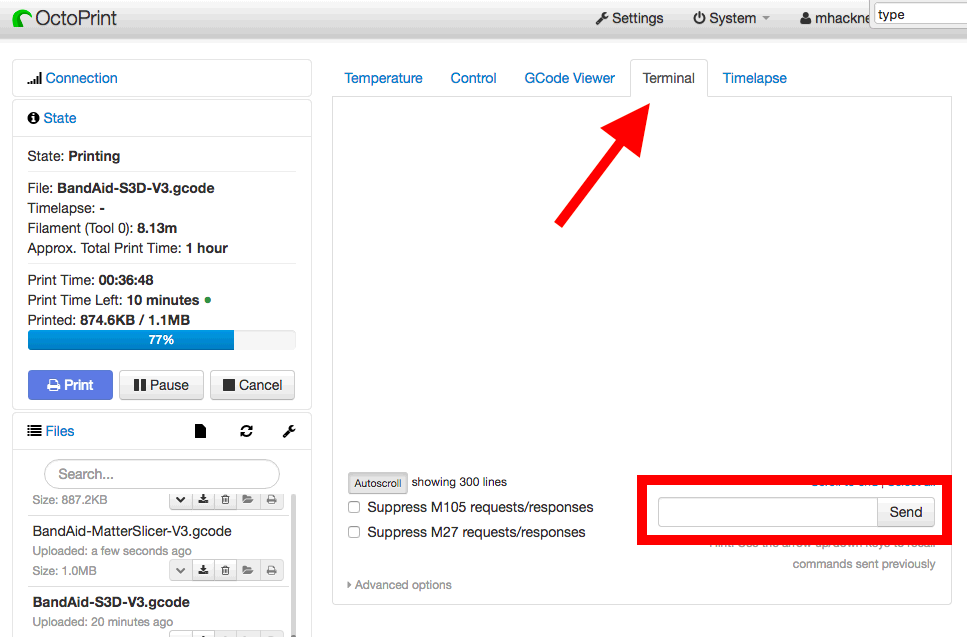

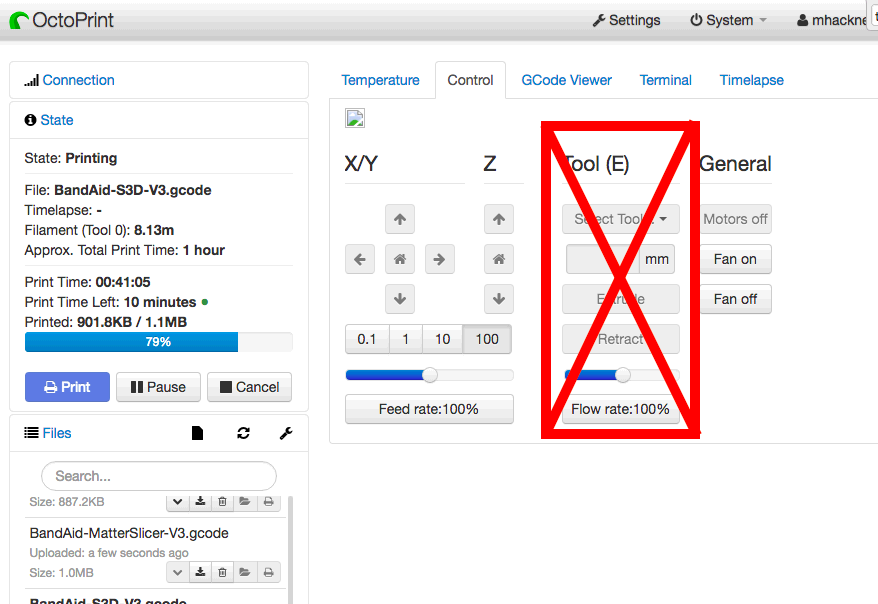

We call that "extruding into air". How fast and how many mm of filament were you extruding into air?
Let's start with this then since it is the simples way to reproduce your problem. I am asking that you not attempt to print anything until we can successfully extrude several hundred mm of filament into air at a reasonable speed without skipping.
Start slow, extrude 50 mm at 10mm/s and let's see what happens. To do this, you are not going to use the jog controls on the Control tab - not this:
Instead, you are going to use the console input field on the Terminal tab - this:
This will let you explicitly state ho much and how fast to extrude. You will enter gcode directly into this field. Here is the first extrusion you are going to enter:
M83 ; set extruder to relative mode
G1 F300 E100
This says extrude 100mm of filament at 300 mm/min. G1 is the move gcode, F is the speed and E is the length of filament to extrude. I can't test this right this because I'm in the middle of a print. But give it a try and report back what happens.
Make sure that the filament is not chewed up and that the extruder cog is not filled with plastic.
Re: Backpressure Issue
Note, you do not have to enter the comment, just enter
M83
to set the extruder to relative mode

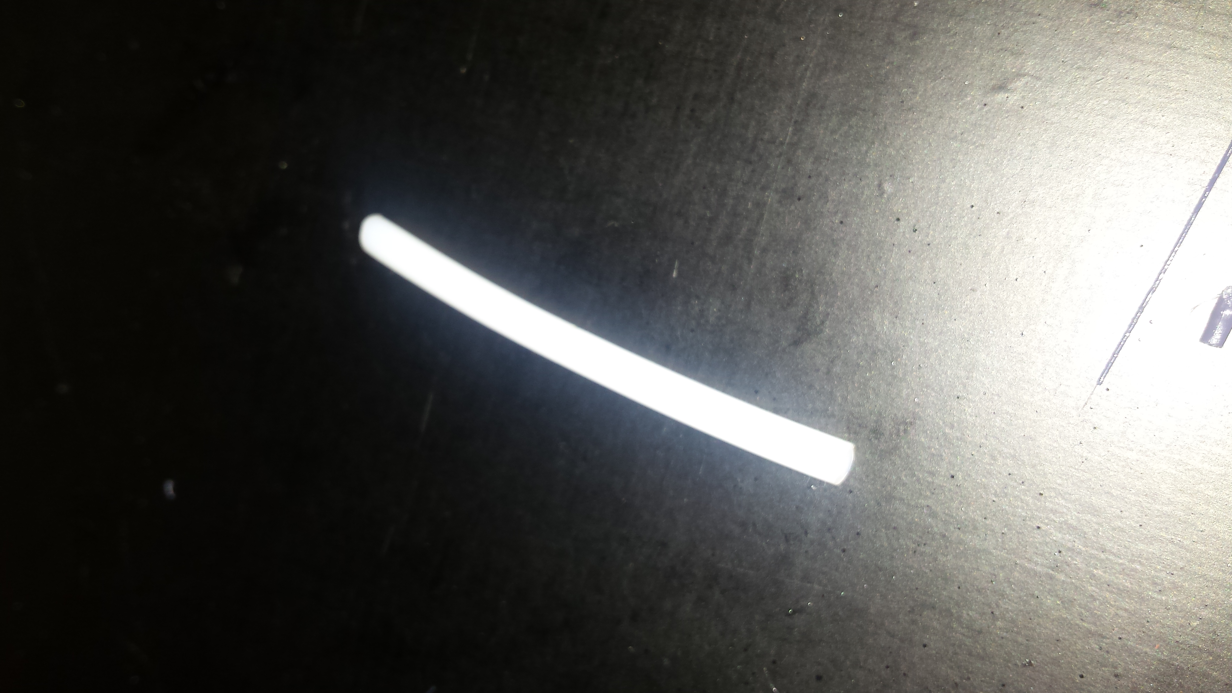

Let me explain.
For the first attempt I just disconnected the Bowden tube from the Extruder and left it connected to the hotend and tried to manually feed filament through it. It didn't work. The filament ended up getting stuck in the hotend somewhere. Once that didn't work I used a second bowden tube I had which I cut down to about 5-8cm. This is what I refer to as the short tube. I used the short tube to figure out if maybe the long bowden tube wasn't properly pushed in all the way..
Short tube:
I hope this clarifies my explanation.
Sincerely,
J.D. Cordero
