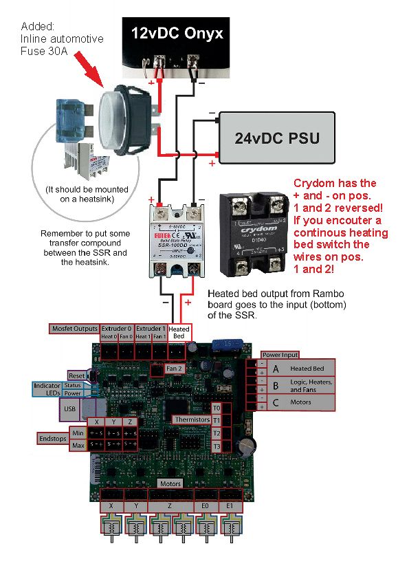

Noircogi, stupid question, but, could you do a quick wiring diagram as I am not really sure how to wire up the Auber relay.

Voila:
Read this thread, it has LOTS of info on the subject!
http://forum.seemecnc.com/viewtopic.php ... &hilit=24V
There is no real difference between V1, 2 or 3 in this regard.

- Discussion here lately has been that it is better to connect the SSR on the hot side (24V side) of the PSU. That seems reasonable.
- Recently I have found an advice to make a seperate circuit with a 150C thermal fuse thermally glued to the bed, that keeps a normally closed relais open. In case of overheated bed (or elseway failing machine causing fire) the power to the machine will be cut. Seems like a good idea too. Especially with an SSR that fails in an open state (fotek). It was not my idea, but I am too lazy to check who's idea it was ;-). Credits are not mine!

You have the relay backwards. You want a Normally open (NO) relay that will break the circuit. I don't think it was my idea exclusively, but I seem to be the first person I can find on the forums for it.
