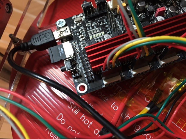

I just recently changed my Folgertech kossel boards for a azteeg x5 mini v2. Most items are working like endstop switches, thermistors, hotend cartridge and heated bed. The motors are the only thing that will not move. When I power up the board, the stepper motors seem to be enabled since I can't move the carriages. But when I use pronterface to try and move any of the motors, the motor will not move but they are free to turn by hand at that point.
Using default config still from smoothieware no changes to it.
Any hints will be greatly appreciated ...

Some photos of your board - the connector wiring in particular - will help. Take a look at this: http://sublimelayers.blogspot.com/2016/ ... g-for.html
It applies to all similar steppers like yours. You should not have any power to the stepper until the controller instructs it to activate. Post your Smoothieware config file. I suspect you have not configured the steppers correctly. My stepper config looks something like:

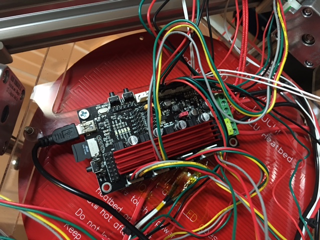

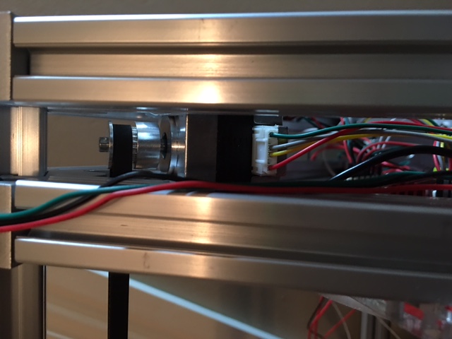

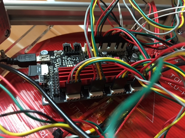

Here is the config that exist on the micro sd card on the azteeg x5 mini and some pics.
config.txt
(20.13 KiB) Downloaded 178 times
Re: Stepper motors not moving
Looks reasonable. I'd maybe disconnect everything except 1 stepper and try to get that going. Did you check the forums for x5 issues? It could be a hardware problem. I assuming tho ha worked before you swapped controllers?
Not that I think it will solve your problem but do follow the instructions in my blog link that tells how to find the 2 separate phases. You do need to make sure that is correct.

Verify the stepper motor phases and wiring order then. 99% probability that's your issue.
