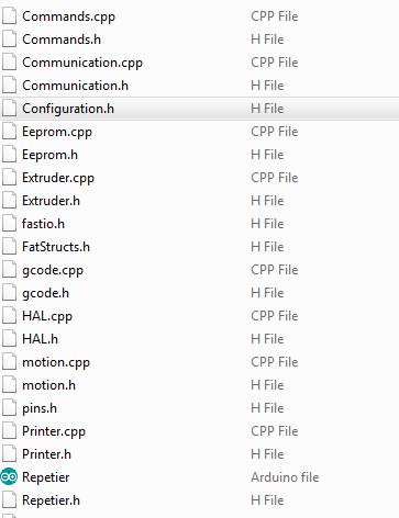

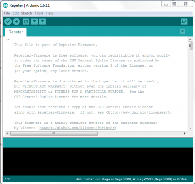

I am reinstalling all of the software for my (basically) new RMV2 and when I got to the Repetier-Firmware, there is only one tab in Arduino. This may be due to a software update, but there are numbers that I am supposed to confirm and they aren't there. Is this okay or am I doing something incorrect?

Something is not correct, there should be a tab for every source file in the folder.DidCan you open the folder and see if they are there?

Yes, now that I look in the folder... there is the tab that should show up. All the rest of the tabs are probably there as well. Redownload?

Did you double click that Repetier file with the green icon? Try that before downloading again.

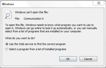

When I click on the file, this window pops up, which doesn't really help me at all.
Re: No Configuration.h Tab?
When I select a program (option 2), I can choose Notepad or something similar. After doing that, everything that would've been in Arduino is now text in Notepad.
Scratch everything I said previously. The "Windows can't open file" popup came up when clicking on the Configuration.h file but when I opened it in Notepad and then reopened the Arduino Repetier file, Configuration.h shows up. I tested with another file and it did the same thing. Problem solved.

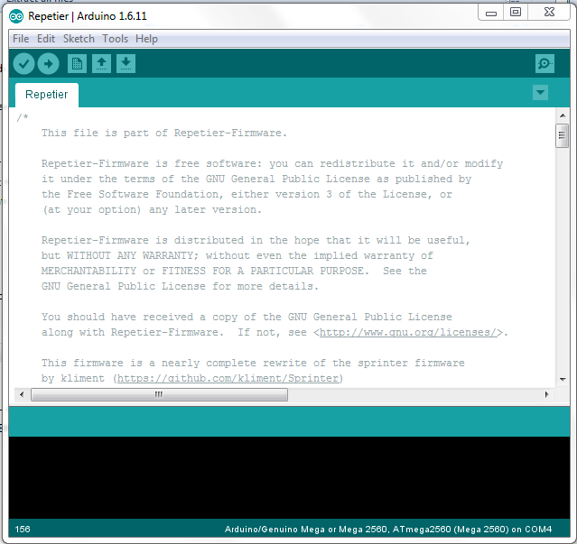

It helps to understand what's going on here. ArduinoIDE is an Integrated Development Environment. It is designed to manage 1 or MORE source files that compile to make a final program (in our case, Repetier firmware). The tabs you see represent the set of files that are needed to compile. There is a special file that names the project and defines the program starting point. It has the file type ".ino". In our case, it is Repetier.ino and it is the file with that little blue green Arduino icon. You must OPEN that file. The ArduinoIDE will then automatically open all of the other source files (.cpp and .h files) that are in the same folder as the .ino file and display each in its own tab.
I suspect you are not opening the right file - Repetier.ino

I believe I miscommunicated what I was doing before which is what may have been causing mhackney to think I was doing something wrong, but according to the youtube video supplied by geneb, mhackney's description, and myself, I am doing it right and it is still yielding one tab in Arduino.
