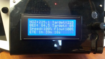

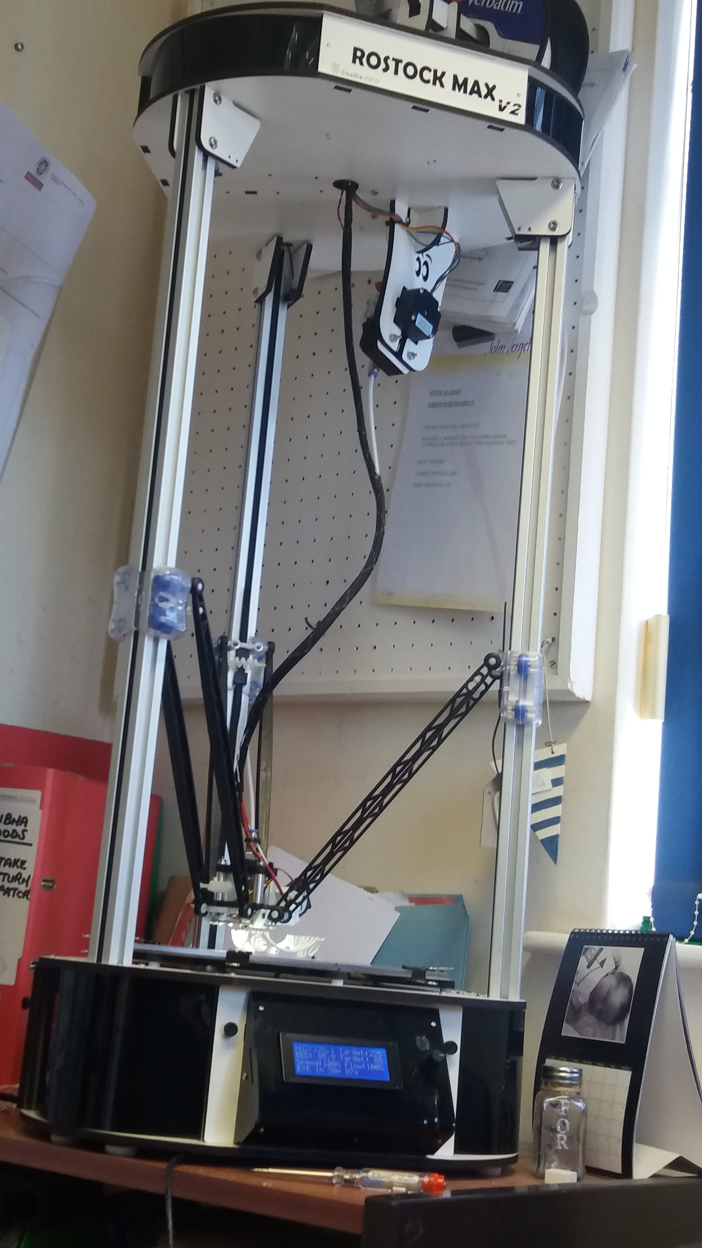

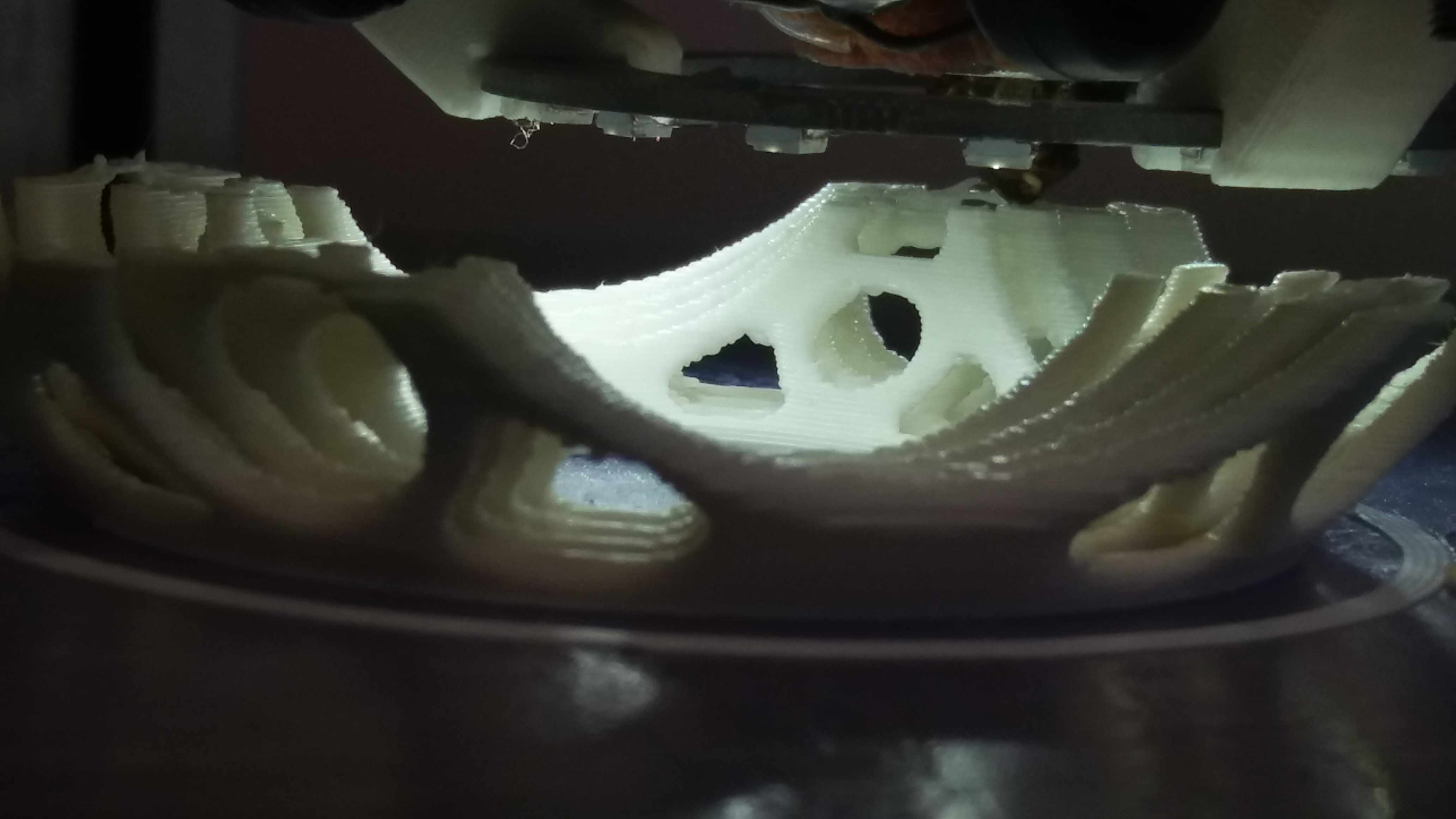

hello to everyone again, i have gone from my v1 acrylic to a up todate v2 (i hope) lol
i have made a few calb blocks etc and gone into making a few other bits but seem to be getting the same issue with the print quality.
i am using abs 1.75mm noz temp is 225 and bed 85
but there are always lines in the print.
any help would be great thanks
joe
Posts: 275
Re: V2 ABS PRINT QUALITY
Post by joe »
Can you say "Over extrusion"! Check your nozzle size and make sure the right nozzle size is selected in your slicer. Do a search for extruder calibration. It will help immensely and is pretty easy to do.
