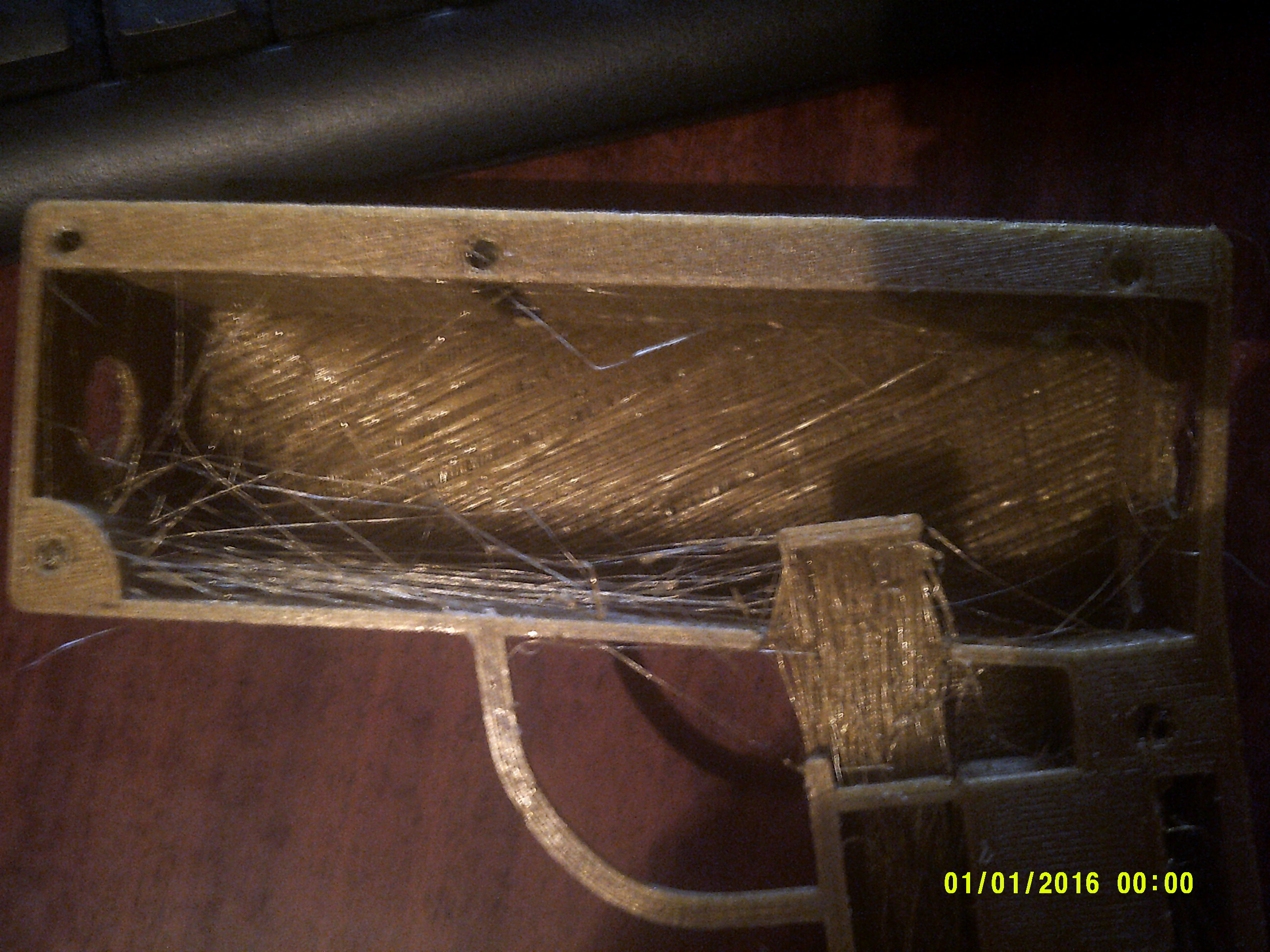

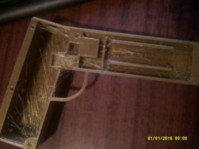

Last 10 days I have a trouble, Layer Shifting with my MAX2. :cry:
I can print test cube easy. Everything fine.
But with bigger model I get a Layer Shifting , very accurate , after 50% of print.
I checked everything. belts and carriage. And cant find a problem. :oops:
Maybe one stepper die ? How to check this ?

IMBoring25
Posts: 616
Re: Layer Shifting
Post by IMBoring25 »
How much bigger model? Is it lifting on the corners? What travel speed are you using? Are the motors getting uncomfortably hot to the touch? Which motors are they and what current do you have set?

IMBoring25 wrote:How much bigger model? Is it lifting on the corners? What travel speed are you using? Are the motors getting uncomfortably hot to the touch? Which motors are they and what current do you have set?
It's doesn't matter. i print this model before many time with little different details.
model have a complex shapes , near border of printed area
I'm make print with 50% speed and get results like this
Same model and same slicer settings? The Rambo can get overwhelmed with too fast a move around the edge of the bed. I think I remember turning my travel/non-printing speed down significantly when I was doing my big print that spent a lot of time around the edges.

Post by darkjorik »
little different. I'm searched the problem and change stock hotend to E3D.
Now I'm printing with 0.4 nozzle , before this I'm use 0.5 and get succesfully printing more then 10 times without any trouble.
If you read what I'm write. I'm tried change speed to 50% and get some problem.
Each time I'm printing , I get fail after 49% -54%
I'm lost 2 kg PLA !

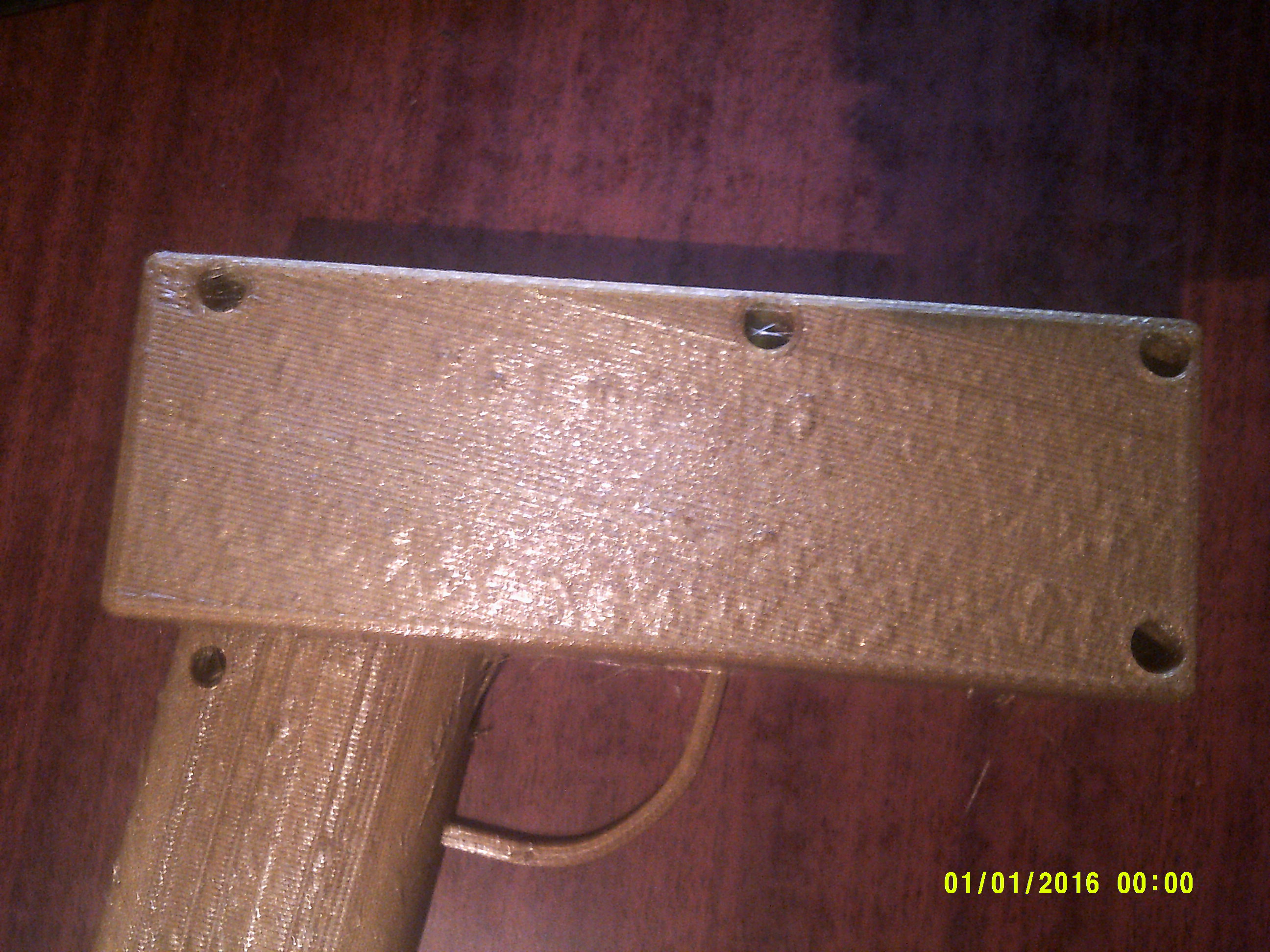

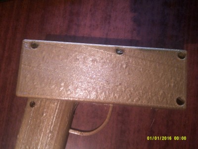

Post by darkjorik »
i'm finish print with slow motion speed. But get a Oozing and little bubbles on upper side
