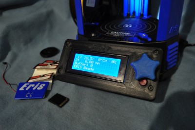

Post by Mac The Knife »
Using the same controller as it's big brothers,

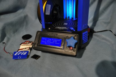

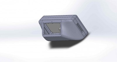

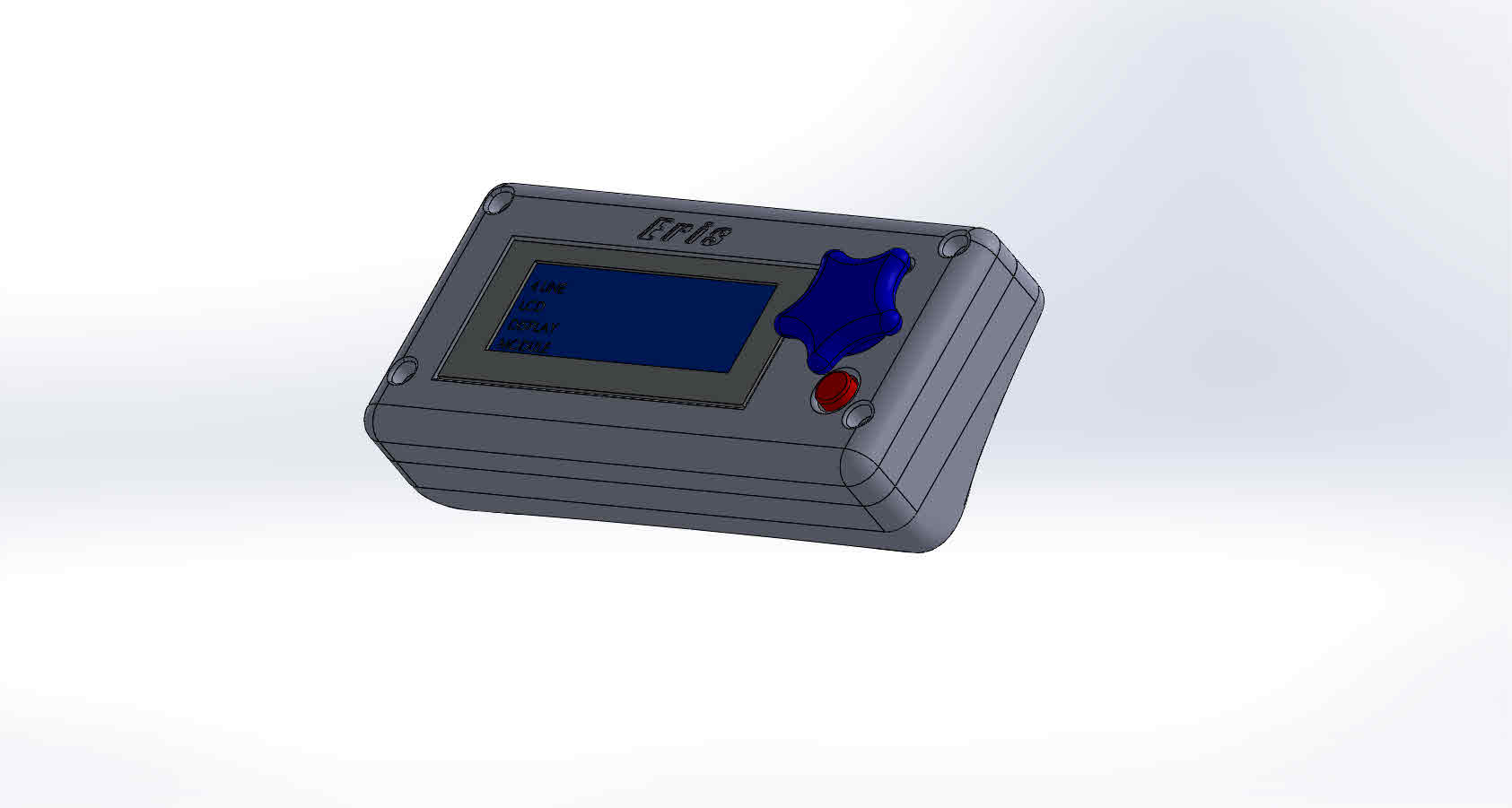

I checked the fit of the cover this morning before work, and it fit fine. The knob is a little large, I'll shrink that down to size to match the one on the EZ struder. Tonight I'll see how the reset button installs.
Posts: 1407
Re: Eris Smart Controller
Files are up on Thingiverse,,,,, http://www.thingiverse.com/thing:1584617
