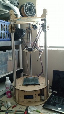

Hey guys, my prints always jam after a bit of time (filament stops extruding and drive gear just starts grinding it). I have been through many upgrades trying to fix this and had no luck. I was wondering if anyone had other ideas. Below is a list of everything i've tried:
steves extruder -> ezstruder -> e3d Titan (current)
Stock Hotend -> e3d v6 lite -> e3d volcano (current)
I've tried abs and pla and various temperatures, messed with retraction and speed settings, tried various fan configurations, oil on the filament, and probably a bunch of other things I cant think of right now, but every time I print, it starts off fine and then at some point into the print (varies depending on print and slicer settings) it stops extruding. If anyone can help me troubleshoot, I would greatly appreciate it!

dylantep

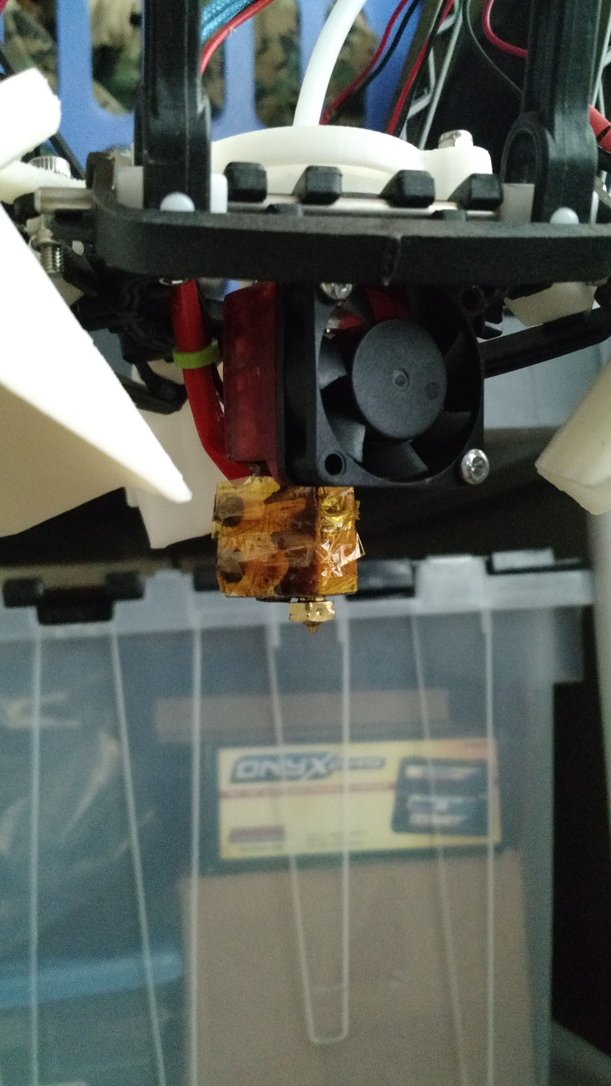

Post by dylantep »
another

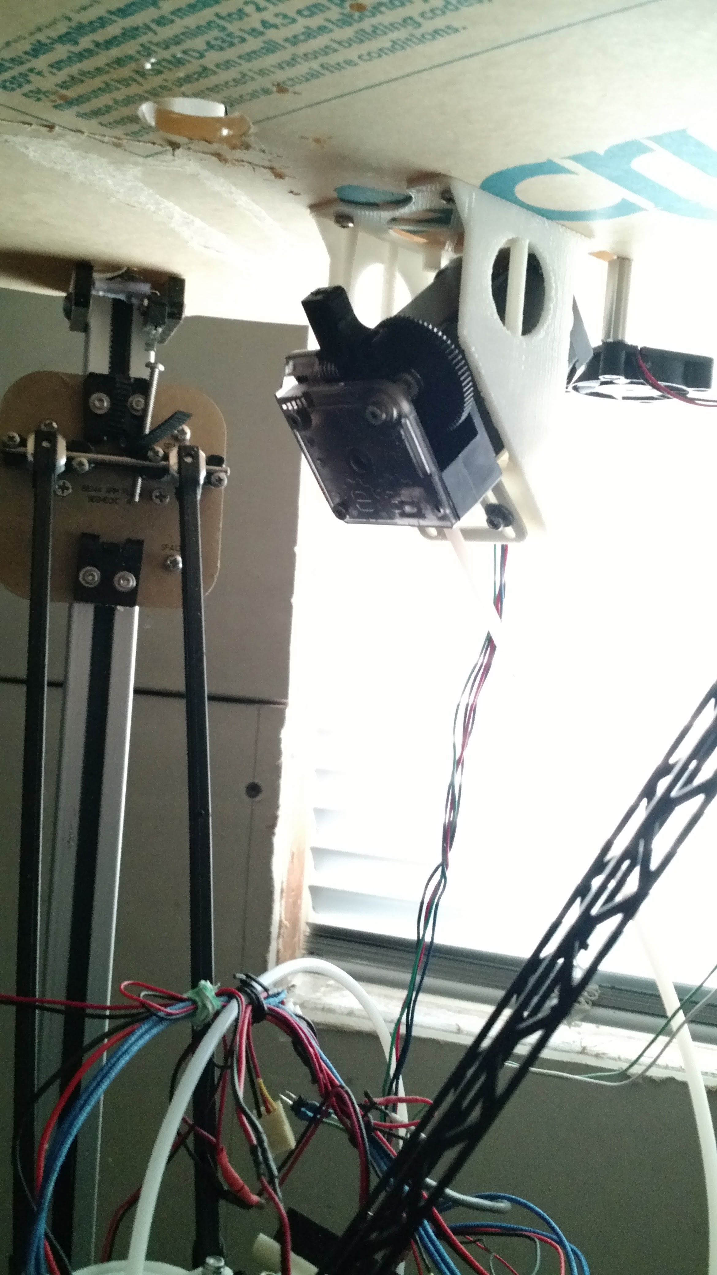

Post by dylantep »
3

I think that your hotend has a Teflon tube inside of it as most E3D have. You may want to disassemble the hotend end check the condition of this tube and replace it if necessary.

You want to determine what the issue actually is before randomly changing too much, if you can create the condition just extruding into mid air it should be relatively easy to track down.
It's either something jamming the hotend (too much retraction etc), misreported temperature (it would have to be off by a lot), a poor connection to the stepper, the stepper driver or the stepper itself.
I'd usually start by manually feeding filament through the hotend to feel the resistance, it's a bit harder on an E3D V6 because the Teflon tube runs into the hotend, and that prevents you from disconnecting the tube at the hotend, so you'll probably have to disconnect at the extruder and feed manually from there, this should tell you if the issue is excessive resistance in the hotend/PTFE tubing of the extruder failing to generate enough torque.
Assuming it's the latter, I'd start by checking the wires, I have connectors in my extruder wiring and I had a poor connection on one wire at one point, when it was knocked, the extruder motor would just oscillate in place, it took me way longer than it should have to identify the issue, because it was intermittent.
If the motor wiring is good, you try more stepper current in the EEPROM, and try monitoring the stepper driver temperature, they get hot enough to burn you, so be careful, if more current makes it worse, you drop the current and point a fan directly at them to see of that has an effect.
