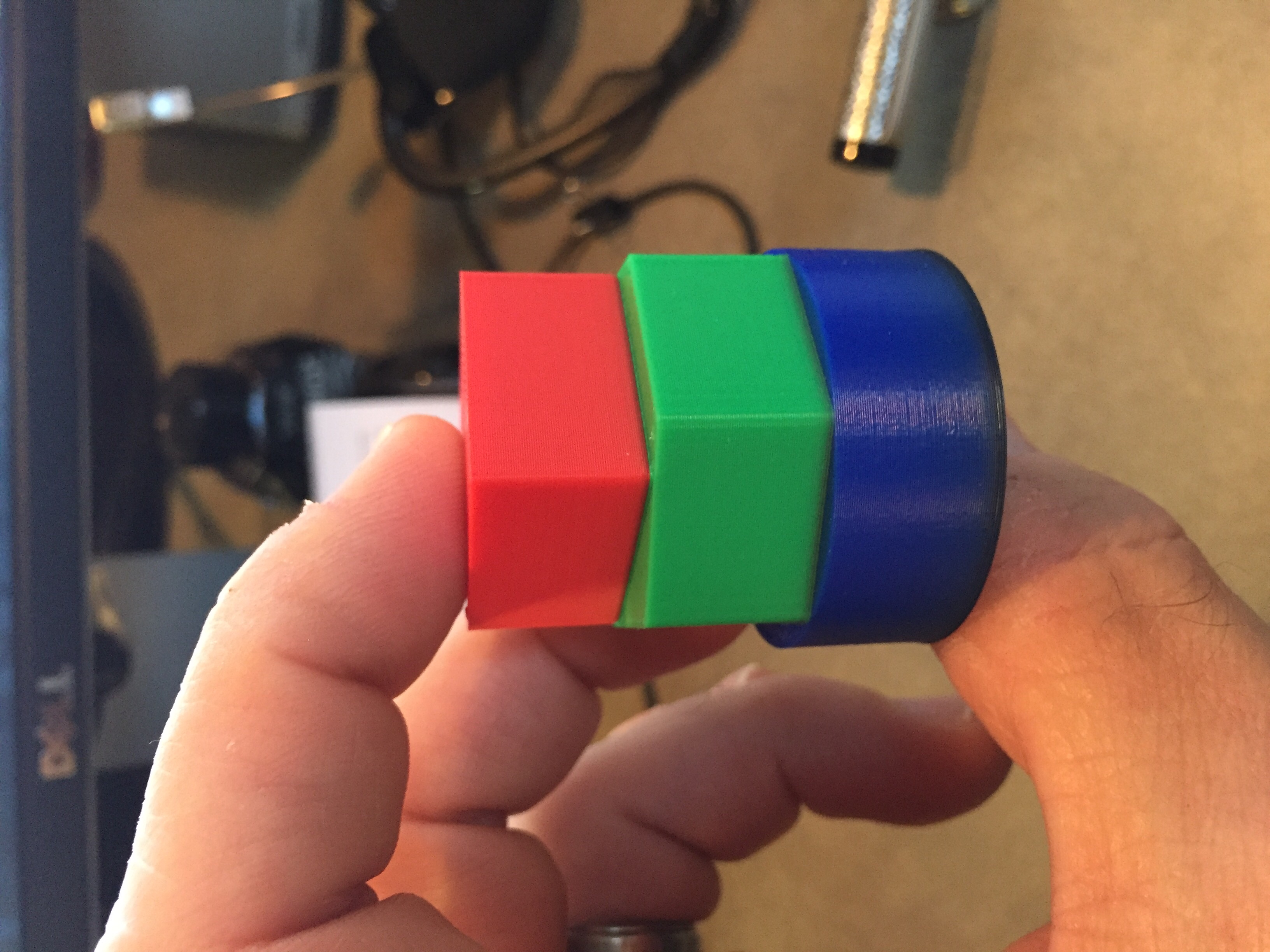

As well, a thread I have posted to using the Diamond and multicolor printing (http://forum.seemecnc.com/viewtopic.php?f=111&t=10179).
While my attempts are not perfect for mixing of color, it is a start and I am still learning!!!
