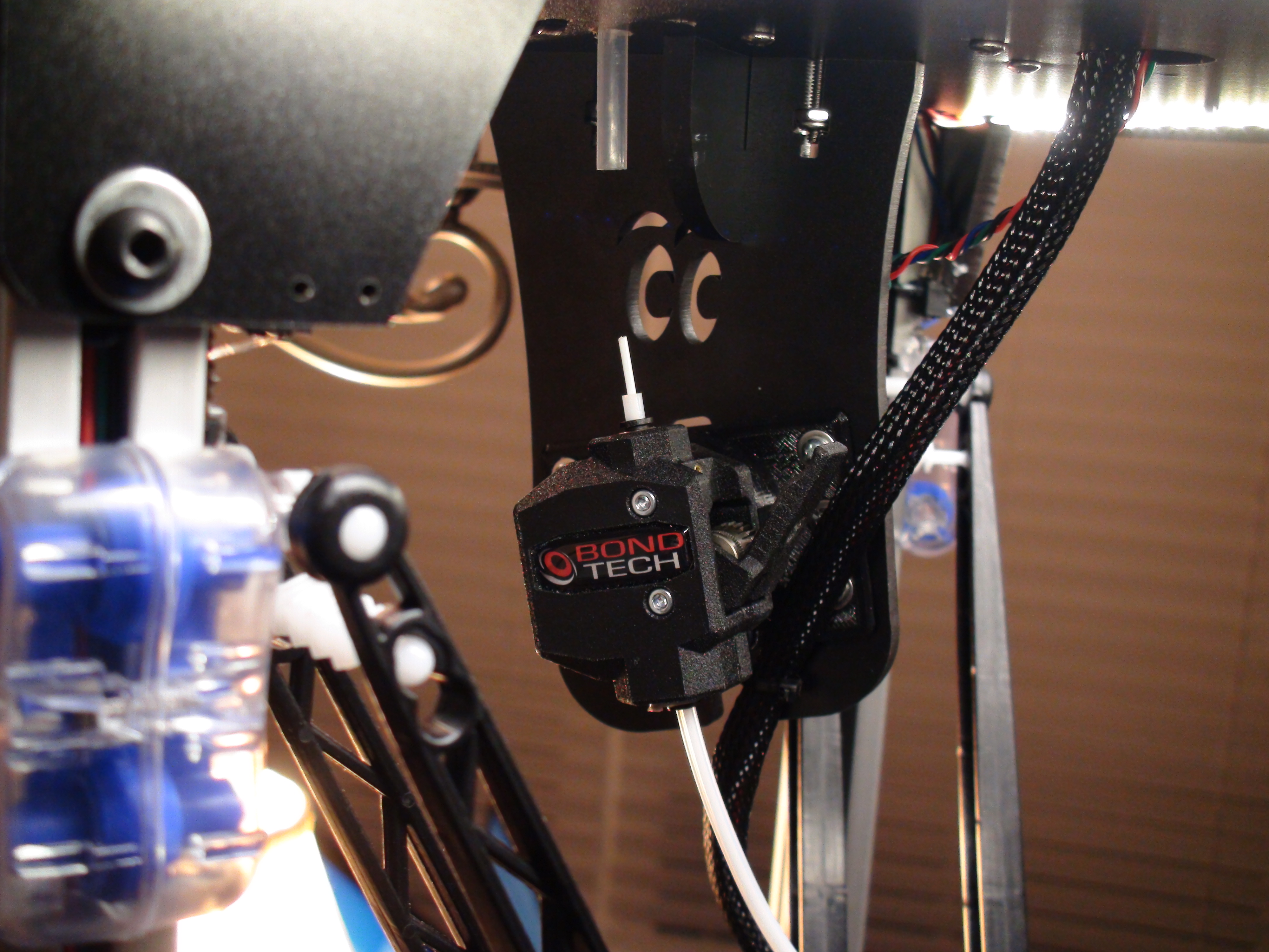

I just bought Bondtech's Rostock mount. For the price (US$15) I couldn't justify the hassle of making one. If you want, though, you do have the option of downloading the STL for the mount. All you have to buy is the threaded inserts.
Posts: 1561
Re: BONDTECH EXTRUDER
Post by Xenocrates »
I did the same thing (Although since I bought mine at MRRF, he just threw the mount in). Other people have used the generic mount (which is meant to attach it to the edge of something) in the top deck or on top, and ran the bowden tube through the filament feed (There's plenty of room. I have an infeed bowden on mine as well as the outfeed)

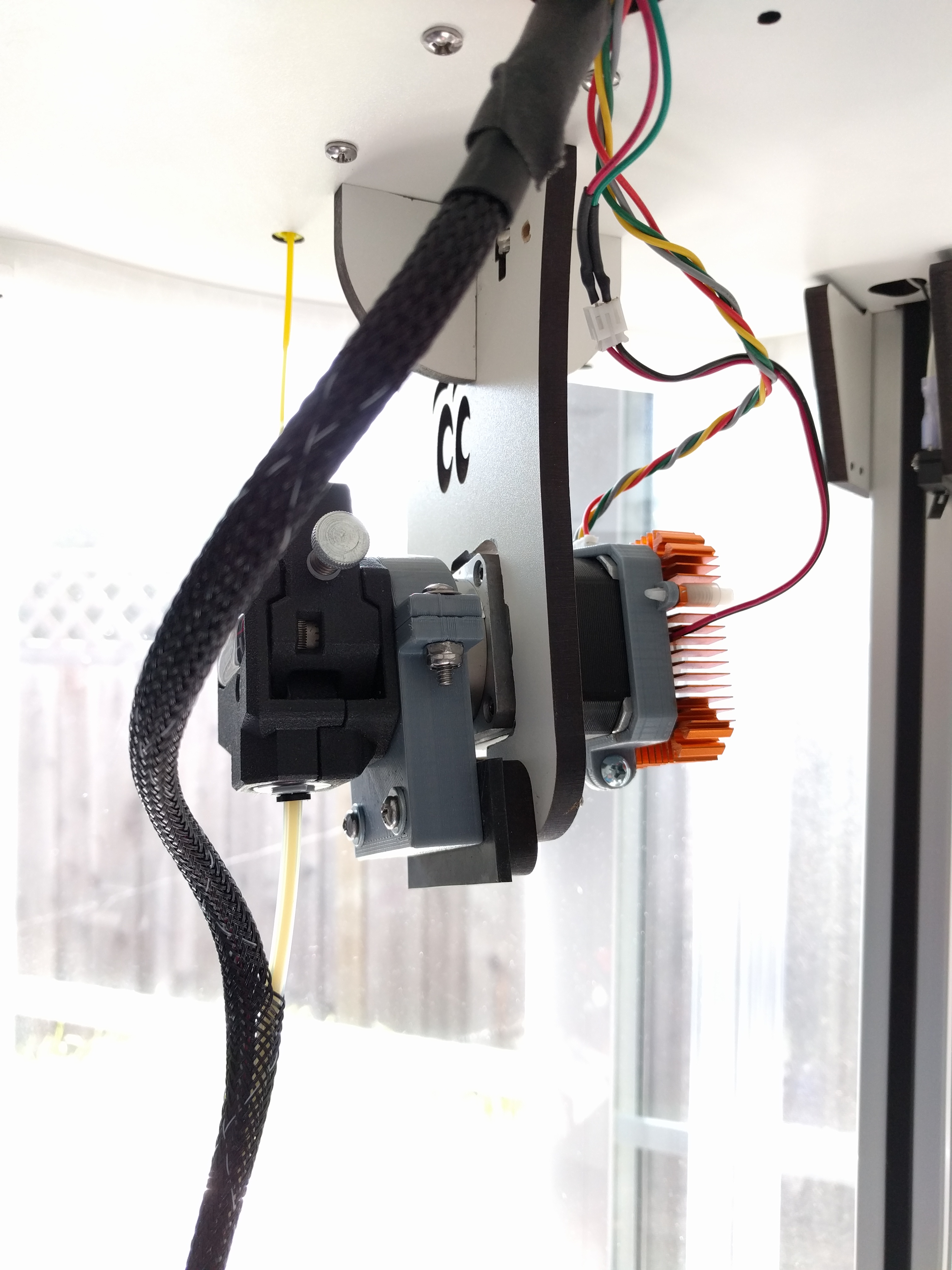

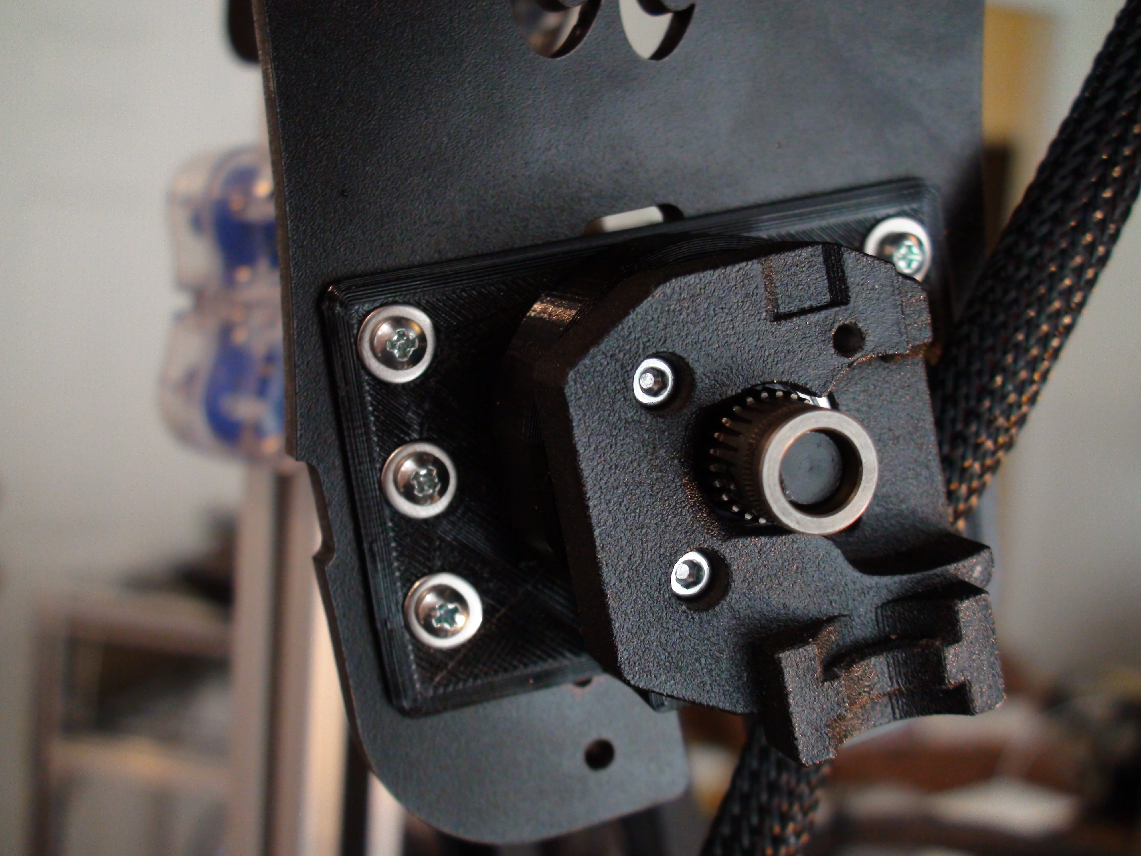

I decided to make my own mount for the BondTech QR extruder. All the ones that I could find attached to the top plate of the Rostock MAX V2 and put the extruder too close to the top of the enclosure for my tastes. I decided to design a simple clamp mount that attaches to the original extruder support arm on the V2.
Here's a picture:
Here is the STL file:
rostock max v2 bondtech qr mount.stl
(167.17 KiB) Downloaded 350 times
This was designed used FreeCAD. I hope this is helpful to someone. If you need the FreeCAD file I can send it.

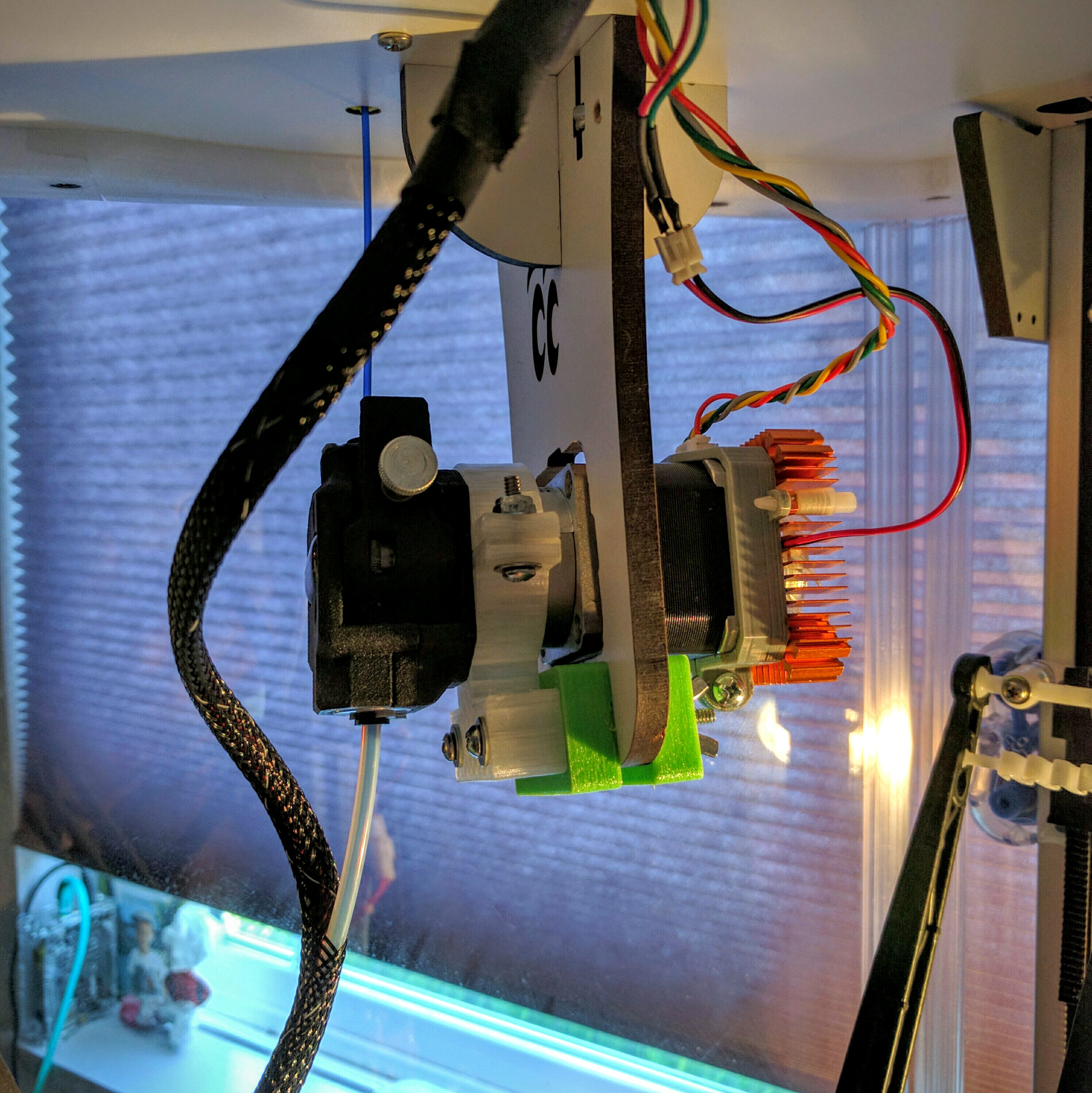

I re-worked my mount for the QR to give it more isolation. Printed using Zen Toolworks flexible filament, it is now very quiet. Here's a picture:
Version 2 of my mount for the Bondtech QR
rostock max v2 bondtech qr mount 2.stl
Printable STL file
(227.13 KiB) Downloaded 362 times
