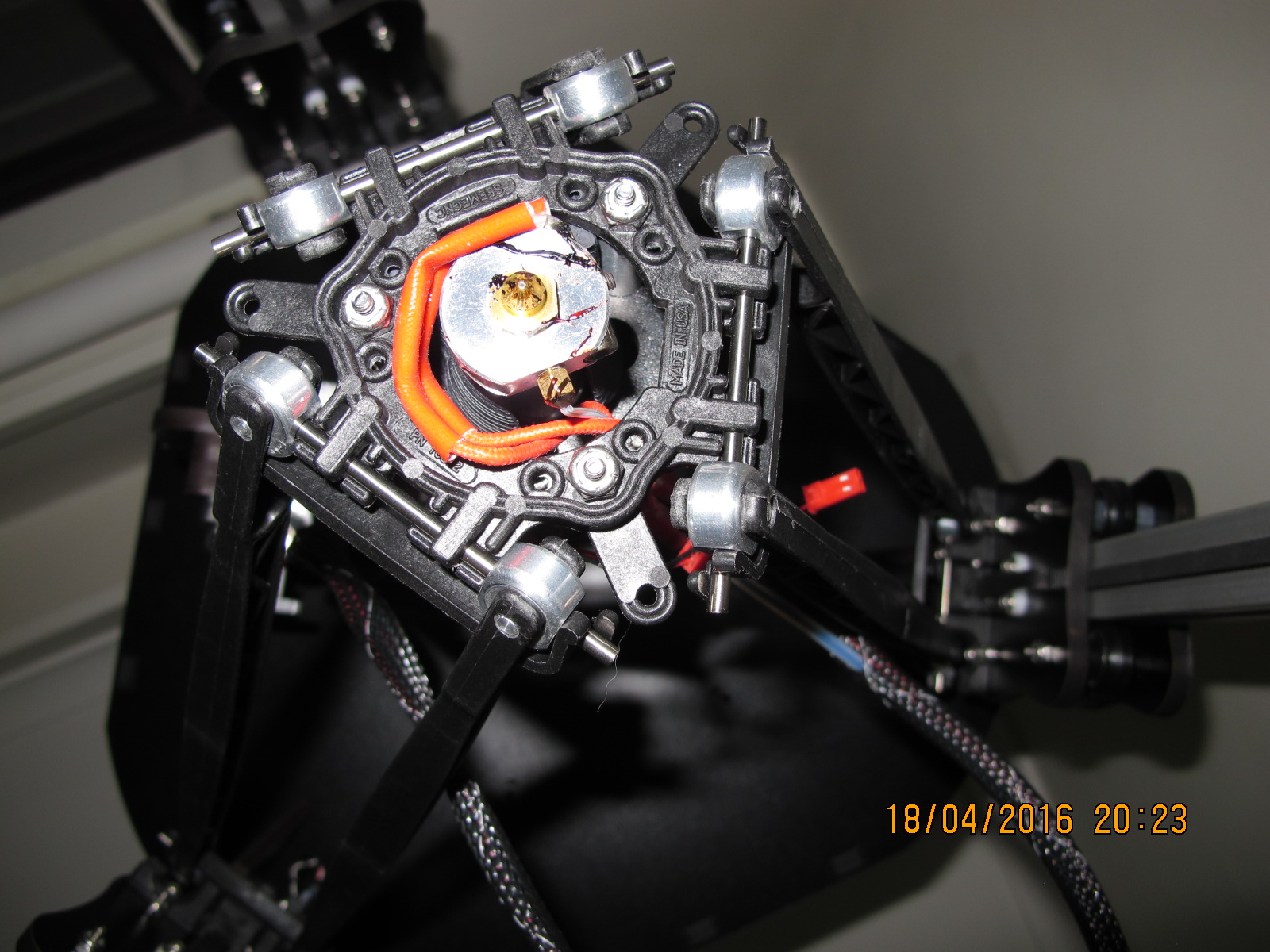

I was looking at githup for the effector platform drawing but I couldn't find it. Where do I find it or how did you name it?

I remember having trouble finding it. Search for platform. If it's the ball joint one you're looking for (It's for relatively new, or retrofitted printers, unlike the U-joint platform) I've attached it to the post.

Thank you for the file but I am looking for the old effector platform.
What I really need is the distance of the three arms let say to the centre. I have in mind to make e sensor which is direct under the nozzle for the OpenDACT software. I would clip it on for the calibration, what normally isn't necessary often, and remove it for the printing. So I would be sure I measure the hight on the right place.

That version of platform is 33 MM from center to center of axle. The older ones are the same.
New ball-cup platform is 30 MM

Thank you for the help and the link. This is what I needed.
