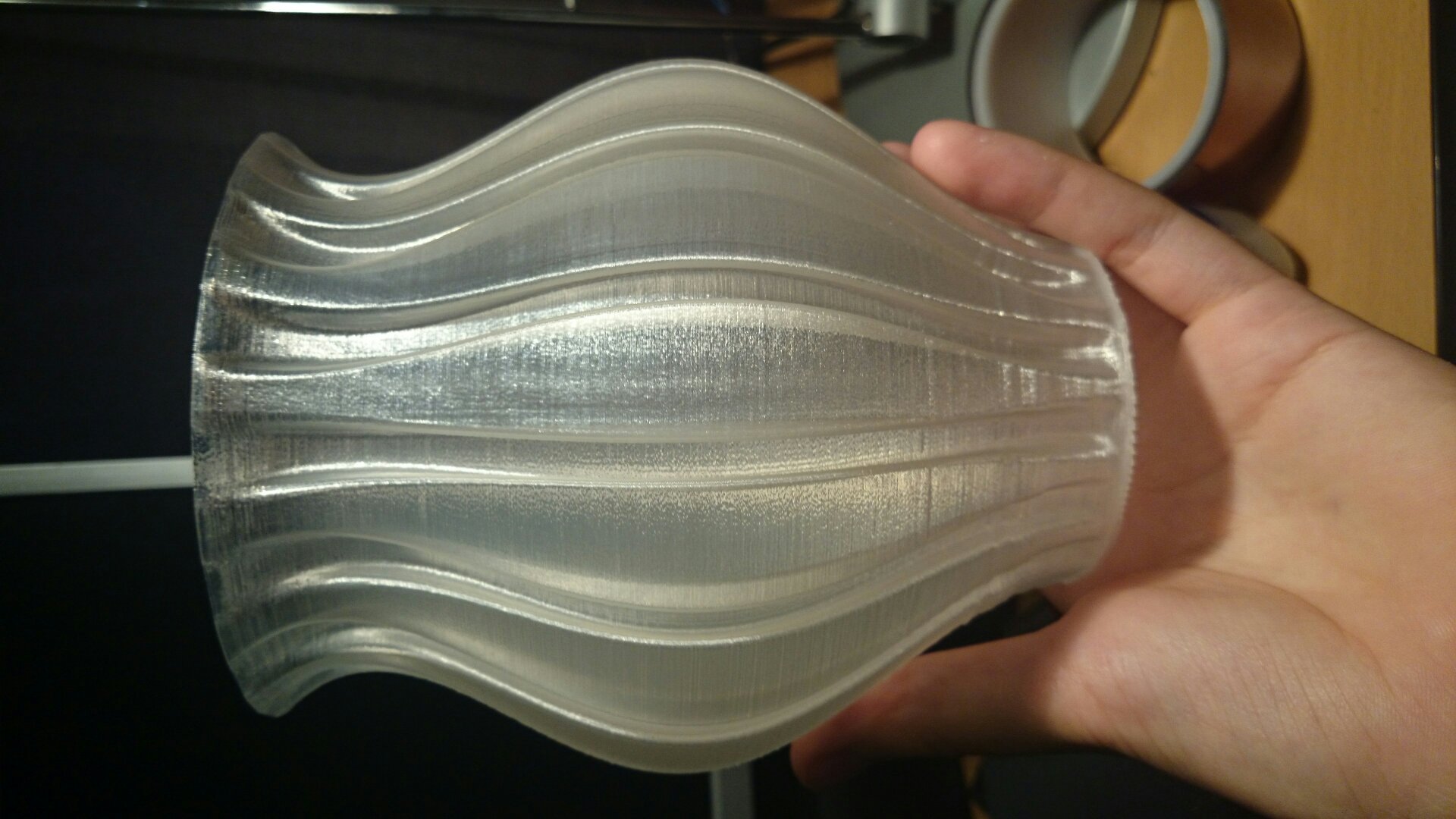

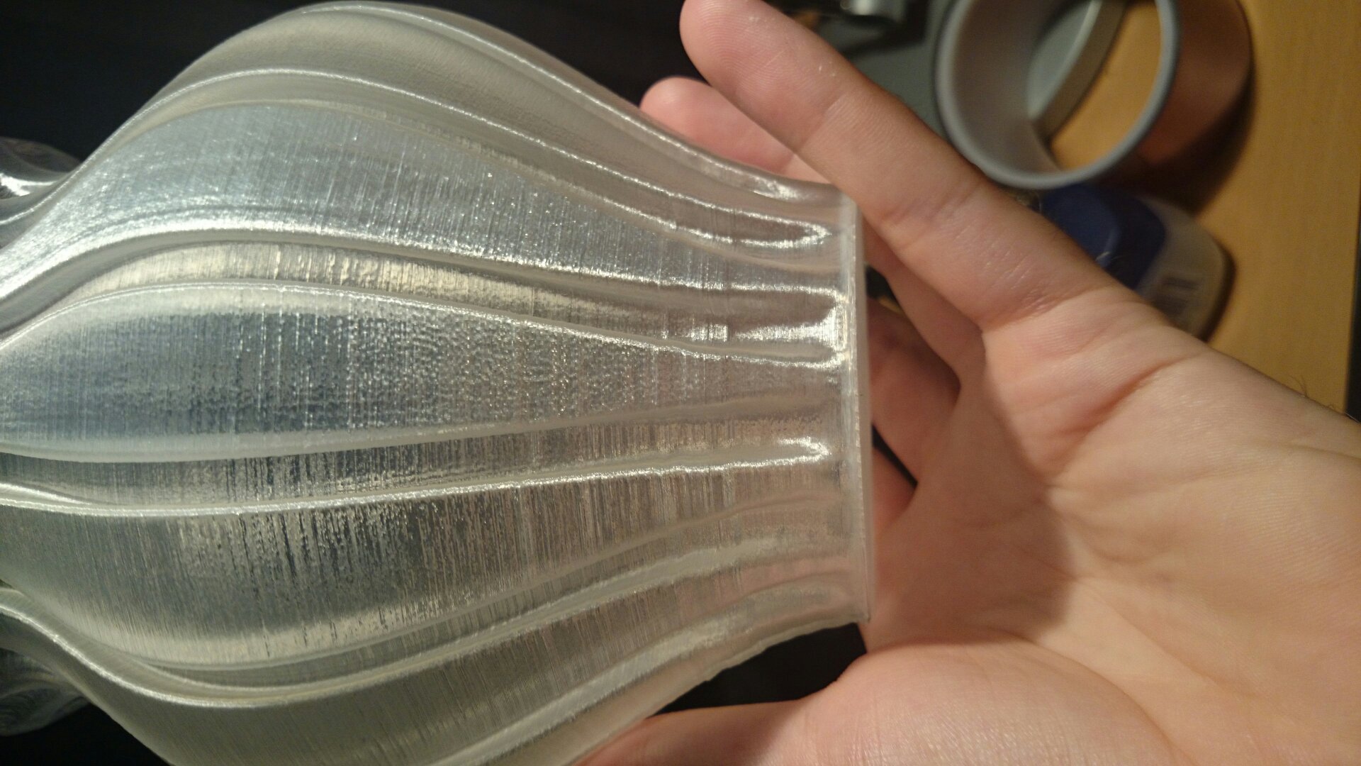

On the topic: I've successfully managed to print a 8,5 hour print today. I've used a little bit of vaseline on the first 30 cm of the plastic to lube things up. The rest of the print happened I did not lube any more. I printed at 15mm/s, at 205 deg.

A great feeling eh? Congrats on getting it to print!
I guess it depends on your plastic / thermistor, but I'm running my PLA at 175 -180. It jams at 160, but runs too much at 195. How low can you go with your setup?
