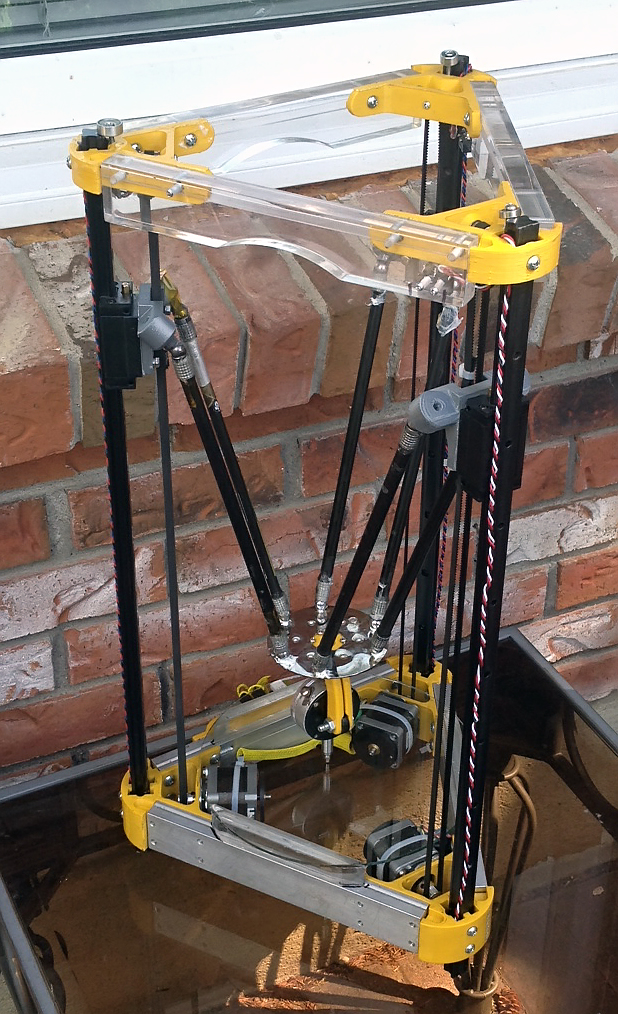

Re: Unsolved Mystery. Weird Z0 behavior around build perimet
See, to me that makes me think the radius of the upper circle is off.
The error is roughly consistent between towers, it is always the same direction, and happens in the same spots.
Is there two radius to define? There should be one for the effector and one for the cheepskates, unless a single point was used for the effector and a mock radius used for the upper pivots.
Kirbymills, I'm going to suggest one thing. Change the length of your arms in firmware, then tweak the radius until its level between center and in front of one of the towers. See how the error between towers changes. If it gets worse then tweak the length of the arms the other way in firmware, if its better (or went the right direction but too far) then you went the right way and just need to add or subtract from your tweak to dial it in.
OK, before I loose my thought here.
The firmware likely considers the effector a single point, and the radius is the radius of the pivots on the cheapskates. It then uses geometry to determine where the cheapskates need to be to put the print head in a certain position.
Arm length and radius can be define in such a way where center and DIRECTLY IN FRONT OF A TOWER are the same, but if this is not reality then the error would show up between towers where only two sets of arms really determine z height.
If the error exactly between towers is the same at all three points but high or low compared to directly in front of a tower then its the radius/arm length that's off.
If the error between towers is all in one direction but different then the arm length/radius needs to be tweaked AND the rotation of the towers.
