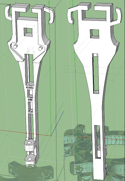

I put together a Hall-Θ holder that fits the MAX and wired everything up. The "stop" wire is plugged into the third pin of Z-min (no other connections necessary there), +5 and ground to the power supply. This is with Repetier 0.90 alpha.
Following these instructions I got it to do a four-point calibration. I ran G32 S2 P1 several times until the x and y deltas had gone down to 0.0 - 0.01 (it gets more and more accurate every time, just like when you use a dial gauge.) Initial results are pretty good and it seems to glide over the surface just right. I'm waiting for some fire cement to cure on the nozzle so I can't do a test print, but I expect good results. It may not be as absolutely perfect as the Marlin version that tests many more points, but it's as good as doing a manual calibration with a dial gauge.

I'll just give it away on Thingiverse. The only thing you need is a 3D printed part, two neodymium magnets from Amazon, and one smooth rod and a wood screw from McMaster-Carr.
Oh yeah, and the Hall-Θ board. That's the only thing you can't get in the States, but they ship DHL so it's not a long wait.

BTW, if anyone's curious, I've attached an image of the mount. It's the same idea as the mount on Thingiverse, except that one won't fit a Rostock MAX and requires a metal rod in a diameter I didn't find, and neodymium magnets in a size I couldn't find on Amazon. (Rule of thumb: if it isn't on Amazon or McMaster, I'm not using it unless I have to.) This one will require two Nd magnets and a 3"x1/8" metal rod. The first magnet goes into the square opening near the top (it's "fluted" so it's easy to push in, and then it will force-fit.) The second magnet goes into the long slot below, and the metal rod sticks to it via magentic force. The Hall-Θ board is pressed into place and held by friction. As the probe descends, the metal rod runs into the build surface and starts pushing the magnet upward. Once it's close enough to the Hall sensor, Z-min will go HIGH and it will back up to measure the next position. If the metal rod is pushed in a little bit further, it will immediately snap up to the top of its slot due to the other magnet sitting under the sensor board. At that point it's stowed and will not project below the print nozzle.
Deployment will be via a "finger" that will be mounted to the bottom plate (the big round thing under the Onyx), replacing one of the white spacers under the Onyx. G-code to make it all work can be embedded directly into the controller via Configuration.h. I had initially thought to make deployment happen by rapidly moving the effector down and then up, but it's too tricky to do that without risking an accidental deployment.
