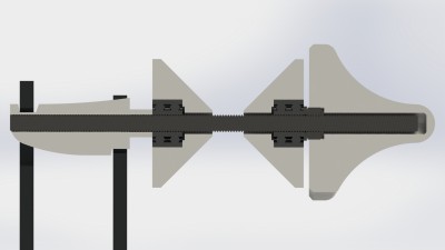

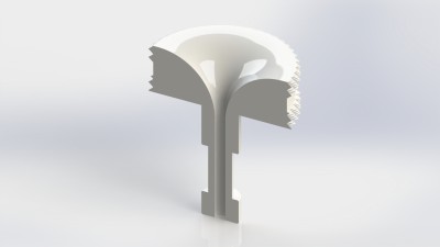

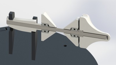

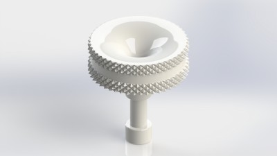

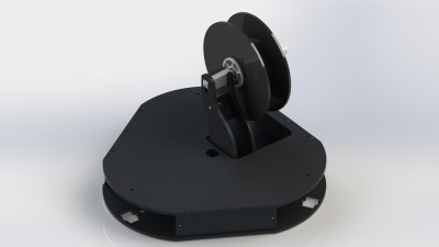

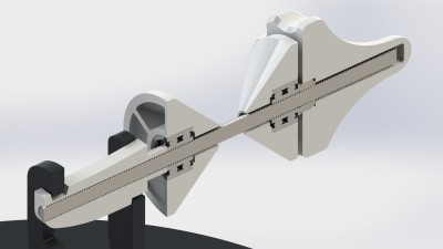

I'm going to order that Hobbed Gear from Tridprinting (thanks for the URL) but I might get the Geared Kysan from http://www.3dmakerworld.com/geared-nema17-stepper-motor as it seems to have four times the torque. Although they look exactly the same. It's the one Brian mentioned at the beginning of this thread.
I really like the BerryBot extruder but it's quite pricey as seen here http://www.shopspt.com/product-p/sptgsm1.htm and with adapter http://www.shopspt.com/product-p/spt-bs.htm. It's very small though!
Anyways, anyone (looking at you Brian) think this geared setup won't work with Trick Laser's Fly-n-Strude? I figure that the size/weight difference should be minimal and getting the bowden tube as short as possible and close to the hot end is a must. Plan is to mount the geared stepper to EzStruder to Fly-n-Strude. Should work no?
I miss not having access to the machine shop anymore so would be greatful for some of your mounts please. If not, maybe Brian can machine some mounts for me?
Nice calipers JFettig. They look exactly like my TESA calipers (ETALON too). I think B&S bought out ETALON years ago. Either way, it's the best (Swiss made). I've Mitutoyo too (great stuff) but love my TESA/ETALON's.

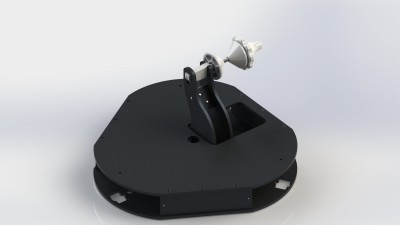

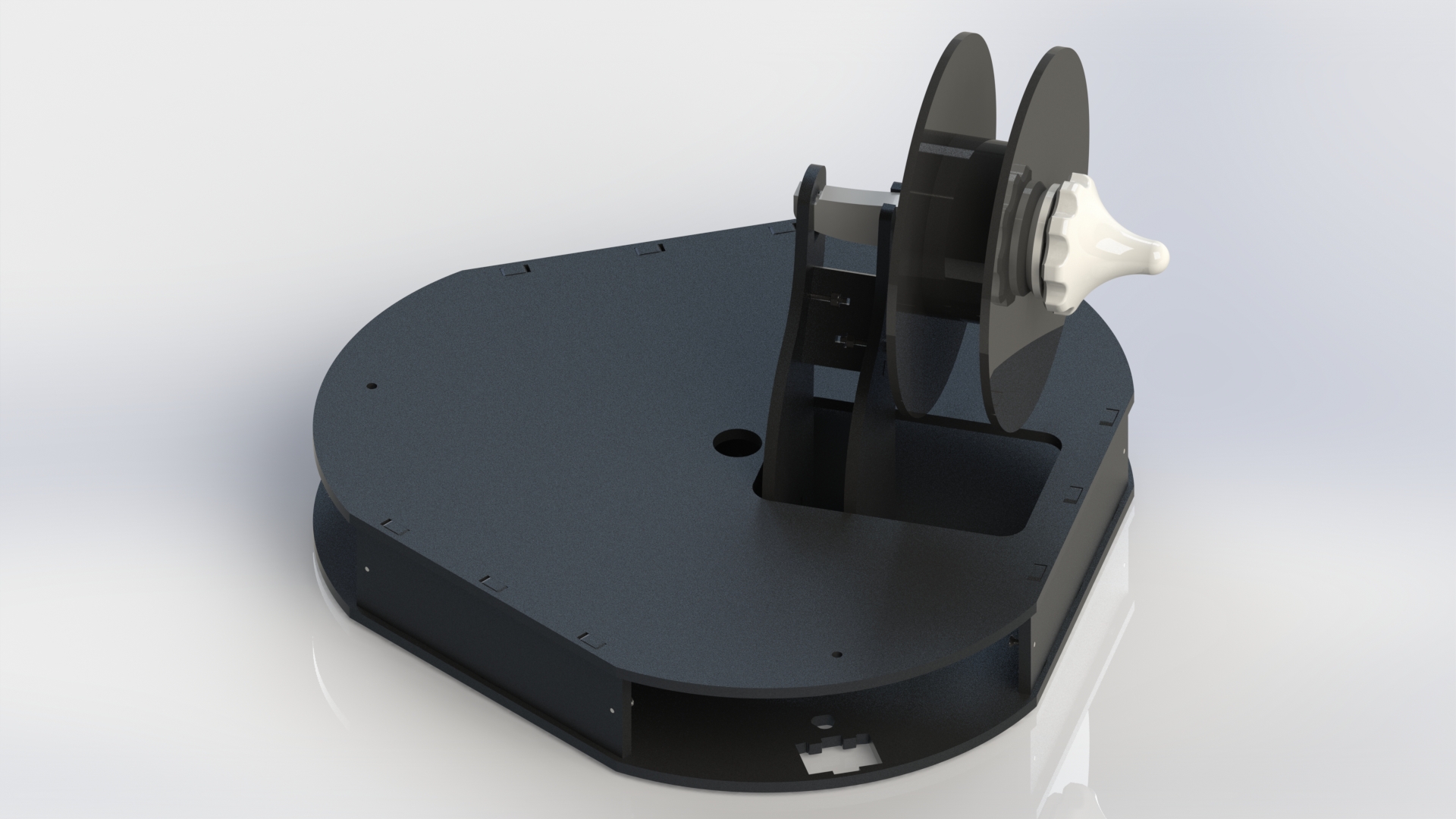

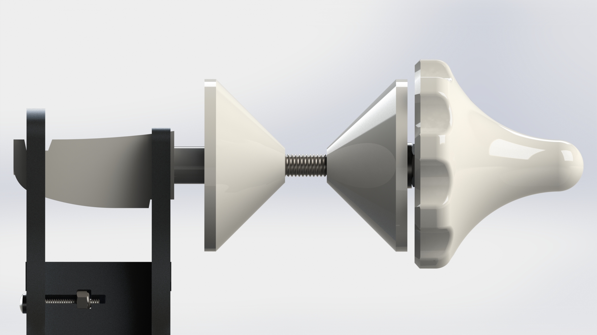

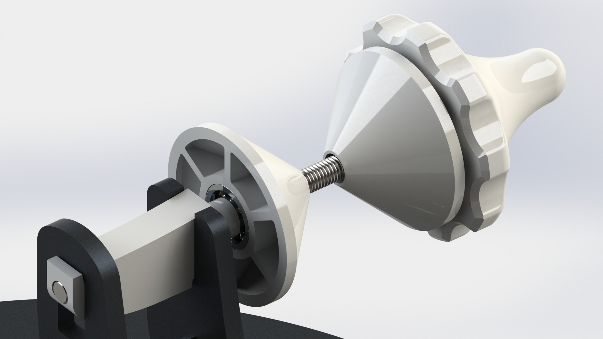

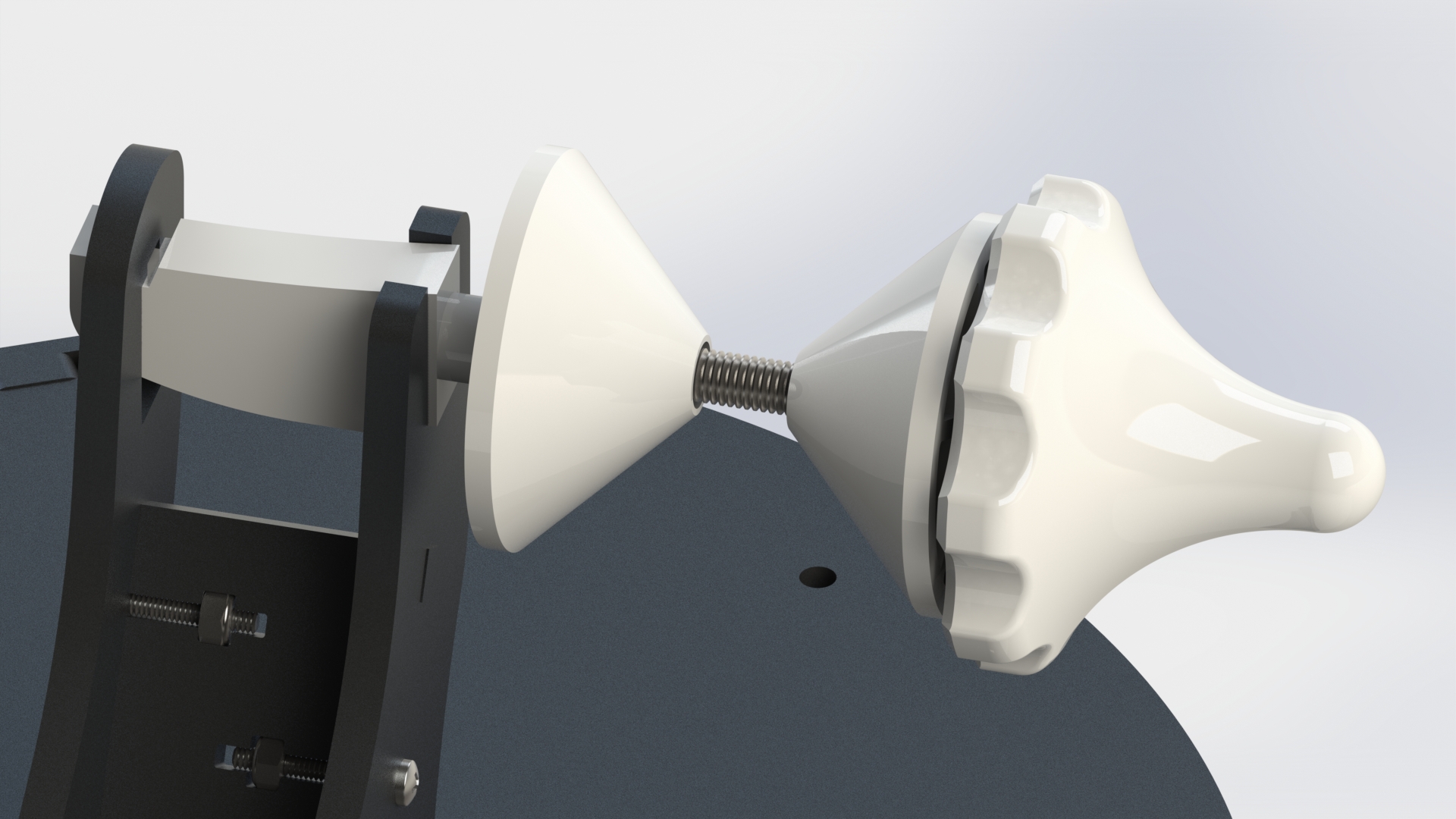

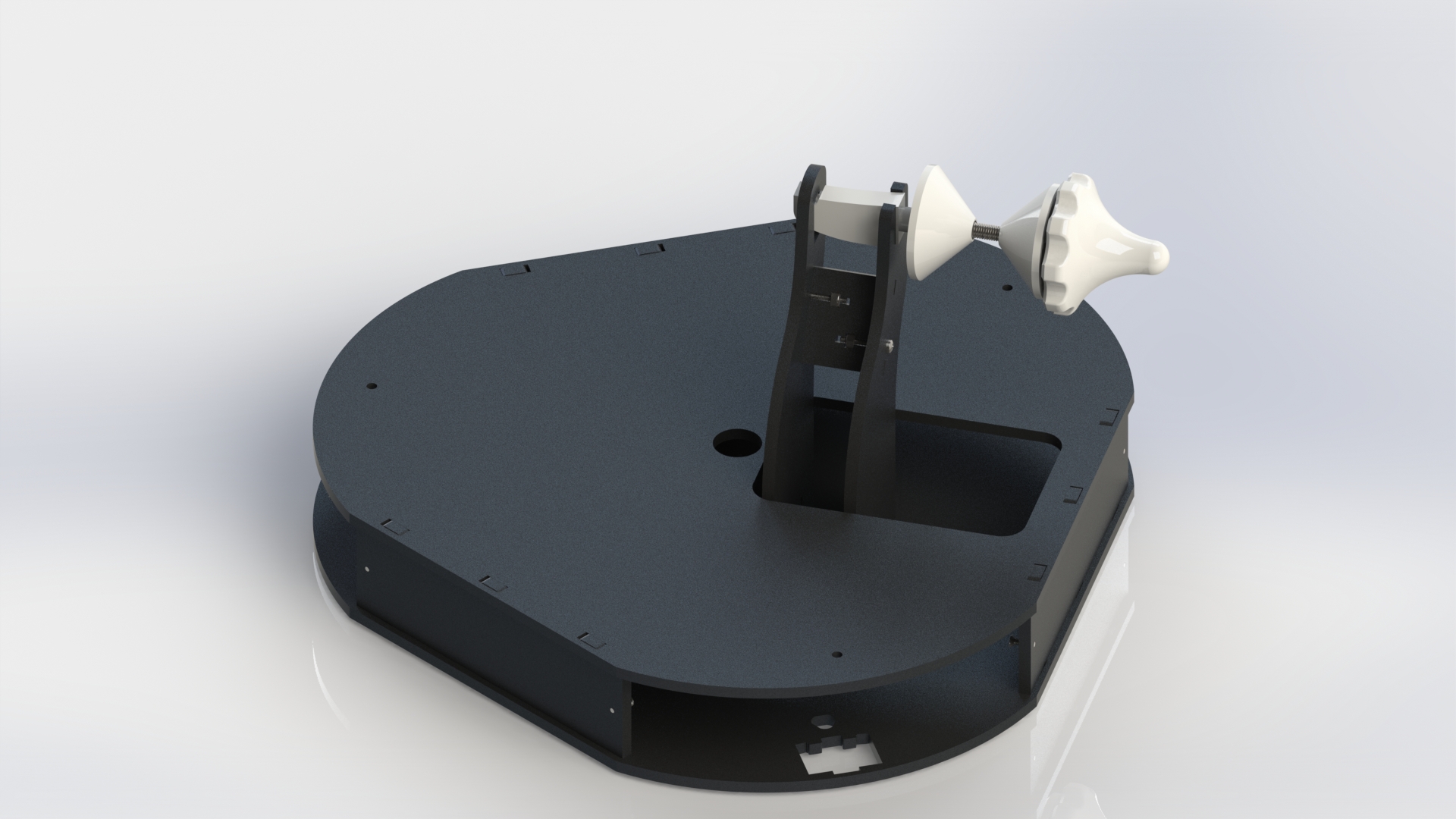

My Spool Holder for the Rostock MAX v2 on Repables & Thingiverse.

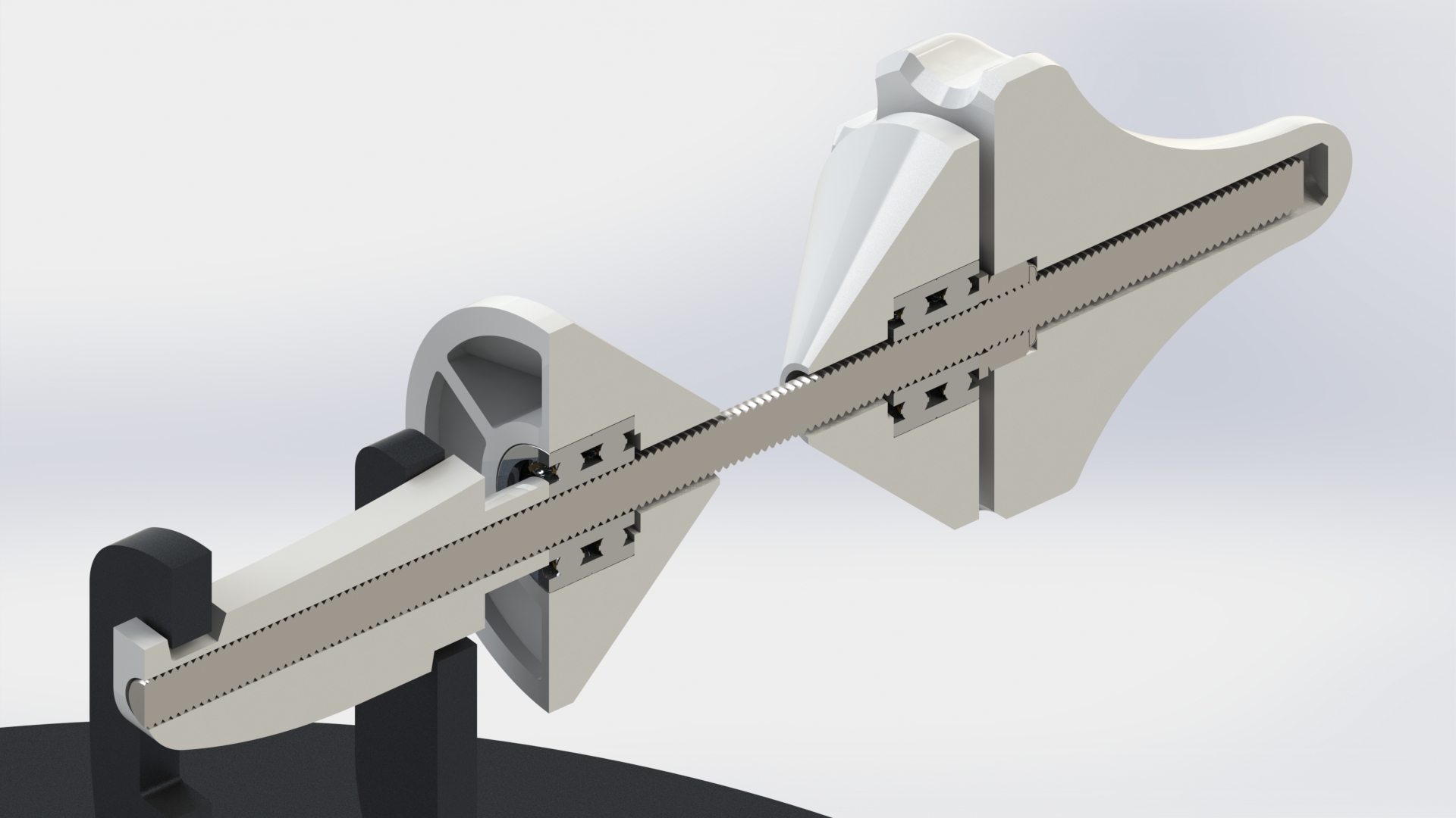

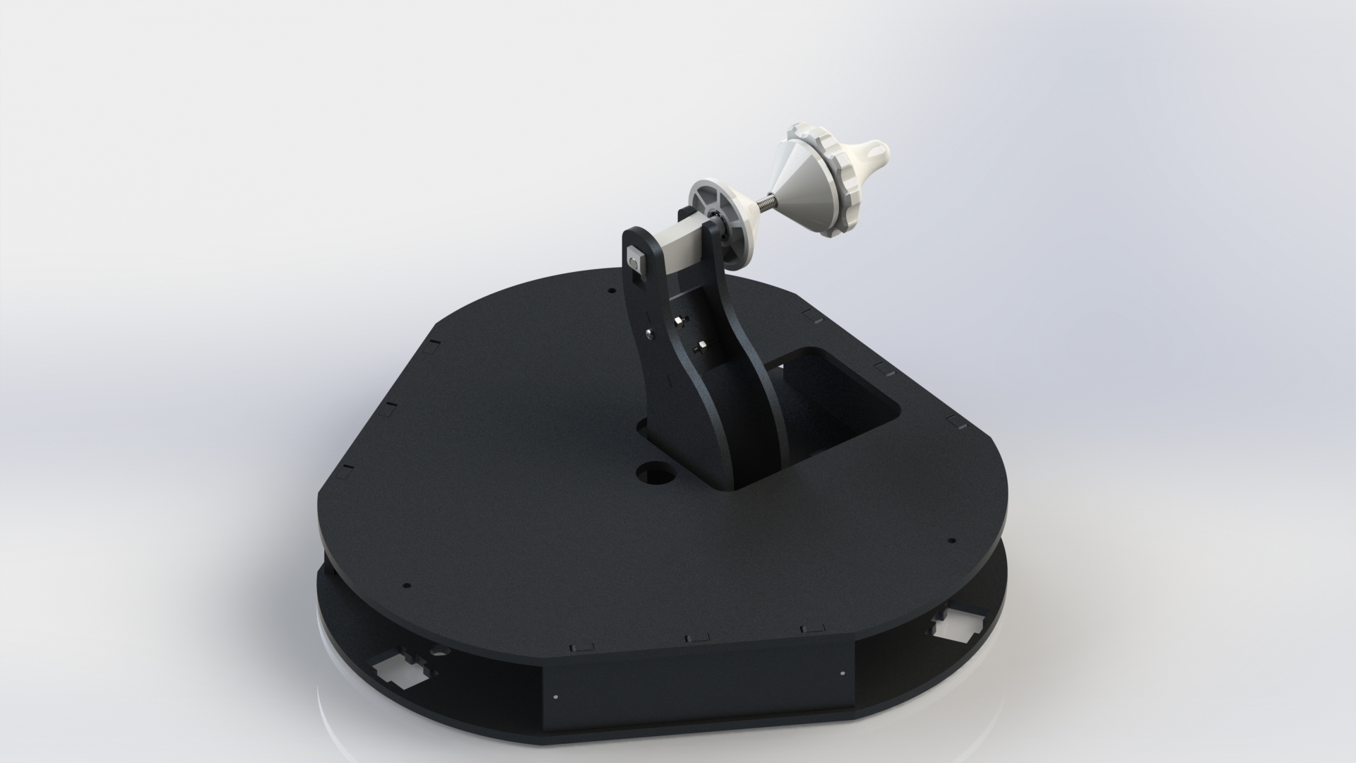

Trying not to go off the "Extruding" topic here, but if anyone would be interested in a complete "remake" of the upper "Spool Assembly" let me know and I can post the files in .X_T, .STEP, .IGS, and of course the .STL's. Or if you like the original .SLDPRT files. I got the idea from other designs but felt it should be a complete "package" to just print and drop in. Only need a M8 x 1.25 x 190mm Threaded Rod, four (4) 608ZZ Bearings, one M8 Washer and one M8 Nylock Nut. I personally tap out the Nylock Nut(s) just a little (not through) with a tap to make them a little easier to turn yet retaining the "locking" fashion of it. The "Cones" have the needed geometry for setting the proper bearing preload. IE: They have the face reliefs in them. The "big" M8 Knob is optional, but it finishes it off IMHO.
I also am finishing up a "Filament Guide/Cleaner" that swivels to follow the "Fly-n-Strude" from Brian. It will have dual chambers one "slightly damp" one "dry" to "wipe clean" passing through filament. Coming soon...
I've other "stuff" for the Rostock MAX v2 that I've designed as well, but this is inline with making "Extruding" easier so I thought I'd add it here to share with all of you if you want.
EDIT: I forgot to mention that the included "Washers" that are printable perfectly line up the center of the the 1Kg SeeMeCNC Filament Spools, 0.5Kg SeeMeCNC Spools and the little Taulman T-Glase & Nylon Filament Spools. Three washer/spacers are included for this. Although the Taulman is just a 1mm thick washer as it's got a very small spool hole diameter. Hence the hollowed out M8 Knob to accommodate the various spool widths.
Here are some photorealistic renderings.

Nice looking spool holder, you should post it on repables.com
I am intrigued to find out more about your filament guide/cleaner.

As of now, it has an upper part that press fits into the existing 8mm hole with a knurled Dia. for grip (fingers). With a larger fillet radius for the filament to enter. I'll post a photo or two of it.
The bottom part(s) will be a two part setup with a hinge on one side and on the other side a sliding locking mechanism. Very simple to use... Elegant!
Inside will be two chambers as I mentioned above. A slightly damp side (if you want/need) and a dry side. Will be using fine microfibre with a small sponge sewn inside of it for both chambers, removable too.
The entire bottom section will be at ~30 degrees towards the Fly-N-Strude and will "swivel" left and right. This will be more of an alignment than anything as I've designed it to be a tight fit with the top section.
Also, will have a Bowden connection for a Bowden tube to "protect" the cleaned filament all the way down to the ezStruder.
Again, these renderings are only for the Upper Section. My 86 mother whom I look after was in the hospital recently and I was tied up a bit with that. All is fine now so I'm back to engineering and building my 3D Printer.
Once complete (day or two) I'll post the renderings on here for everyone (files too).
