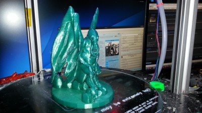

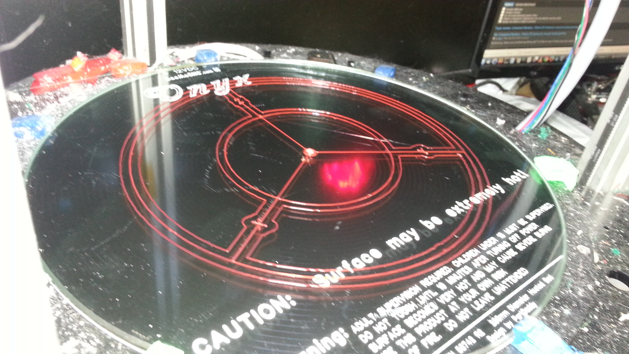

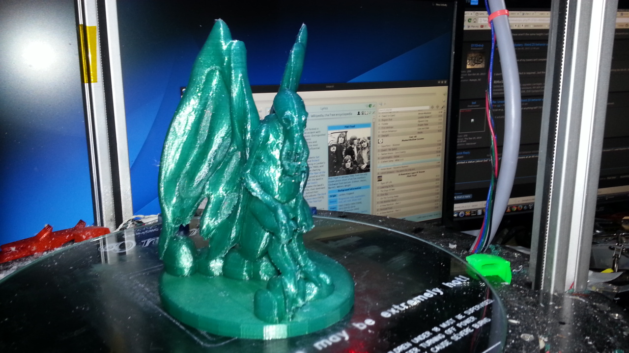

I printed a statue (about 5x6" base by 7" tall) with my firmware at an 80 micron layer height. It came out fine. I had to print from the SD card because if I use Repetier Host, it tends to reset the connection after a few hours. Total print time was ~22 hours. I printed the statue twice and several other things that take awhlie, and it never failed, so long as I stuck to using the SD card.
I also did one of the Onyx calibration prints (big circle with spokes). The print is at 80% of its normal size because the calibration was done with a probe that couldn't be mounted at effector center. (My firmware supports probe offsets, and they do work mechanically, but it introduces error to do it this way, and you don't get nearly the same quality of calibration.) It's calibrated thinking the probe is perfectly centered, but actually the probe was out at the edge of the effector. This does throw it off a little, but I still get far better 1st layer performance. Without the calibration, what you see here would be lifting off in some places, and dug in to the point of blocking the nozzle in other places.
bot

All I'm taking away from this last page is that I have too few Cthulu statues. I knew he was getting his inspiration somewhere...

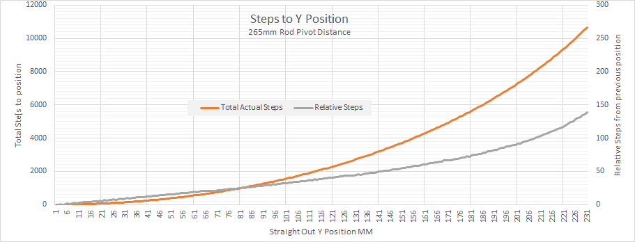

626Pilot wrote: I also noticed how ridiculously fast the carriages have to accelerate when the effector is furthest from them - they have to move several times faster than when the carriage is close. I wonder if the math doesn't get a little weird close to the very edge.
I attached the steps curve for a 265mm pivot - pivot rod moving straight out from a tower. If the software is trying to maintain a fixed XYZ motion speed it would definitely speed up the carriages. Speed should be about 2x when at 200mm as compared to speed at 100mm extension.
Steps curve for Y Motion
