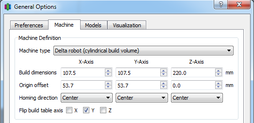

artexmg wrote:
Quick question, would you mind posting a screen shot with your X, Y and Z configuration? I just cannot get it totally right, the bed looks like 110% bigger.
For the Max
For the Orion
Re: Simplify3D ver 2.0.0
Posted: Fri Mar 14, 2014 9:20 am
by Eaglezsoar
Thank you for posting those. You have helped out present and future owners of S3D.
Posted: Fri Mar 14, 2014 9:39 am
by artexmg
jmpreuss wrote:
For the Max
For the Orion
Well, you know, I had this very numbers and work well with small prints, but for larger pieces (+9 Inch), they get out of the print bed.
The reason is (I just figured out last nigth) because X and Y should be for a square contained within the circle of the bed, which is of a radius 280 (S3D set it to 260, but it is wrong).
This is X=Y=RSin(45°)
So, the rigth X and Y for Rostock Max should be 198.
Now I have the bed at 100% and not to 110℅ :-)

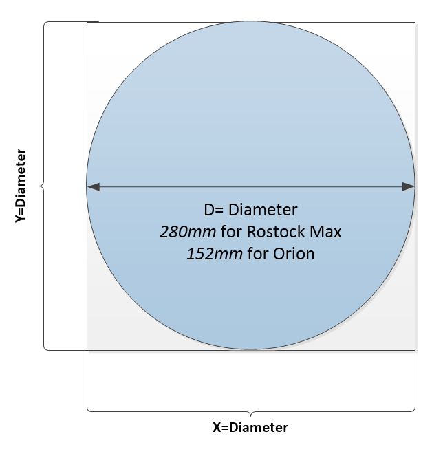

Well, here is a graphic of what I tried to explain in the previous post. I think is easier this way :-)
This is how it was BEFORE. The X and Y are set to the Radius, hence, the square bed (see the square outside the circle?) is bigger than the actual Onix heated bed.
What I found, after experimenting with X and Y in S3D, is that it is expecting those values to be of a square inside the Circle of the Printing Bed, instead of outside.
I believe this confusion is due to the Repetier to have X and Y = Radius. However, Repetier asks, as well, for the Radius and makes its own calculations for the bed
Anyway, these are the parameters I have for my Rostock Max; they seem to work fine. Before that, using X=Y=260 my large prints were caught "out of the bed". No good for the belts, they got bitten by the pulleys when the Cheapskates fell down hard!!!
Posted: Fri Mar 14, 2014 8:34 pm
by Eaglezsoar
Does this mean that you can only print within the square area?
Posted: Fri Mar 14, 2014 9:00 pm
by artexmg
Eaglezsoar wrote:Does this mean that you can only print within the square area?
No, not at all.
The square is just to calculate the correct value for X and Y, nothing else.
Good you asked, as it could be misleading :-)
