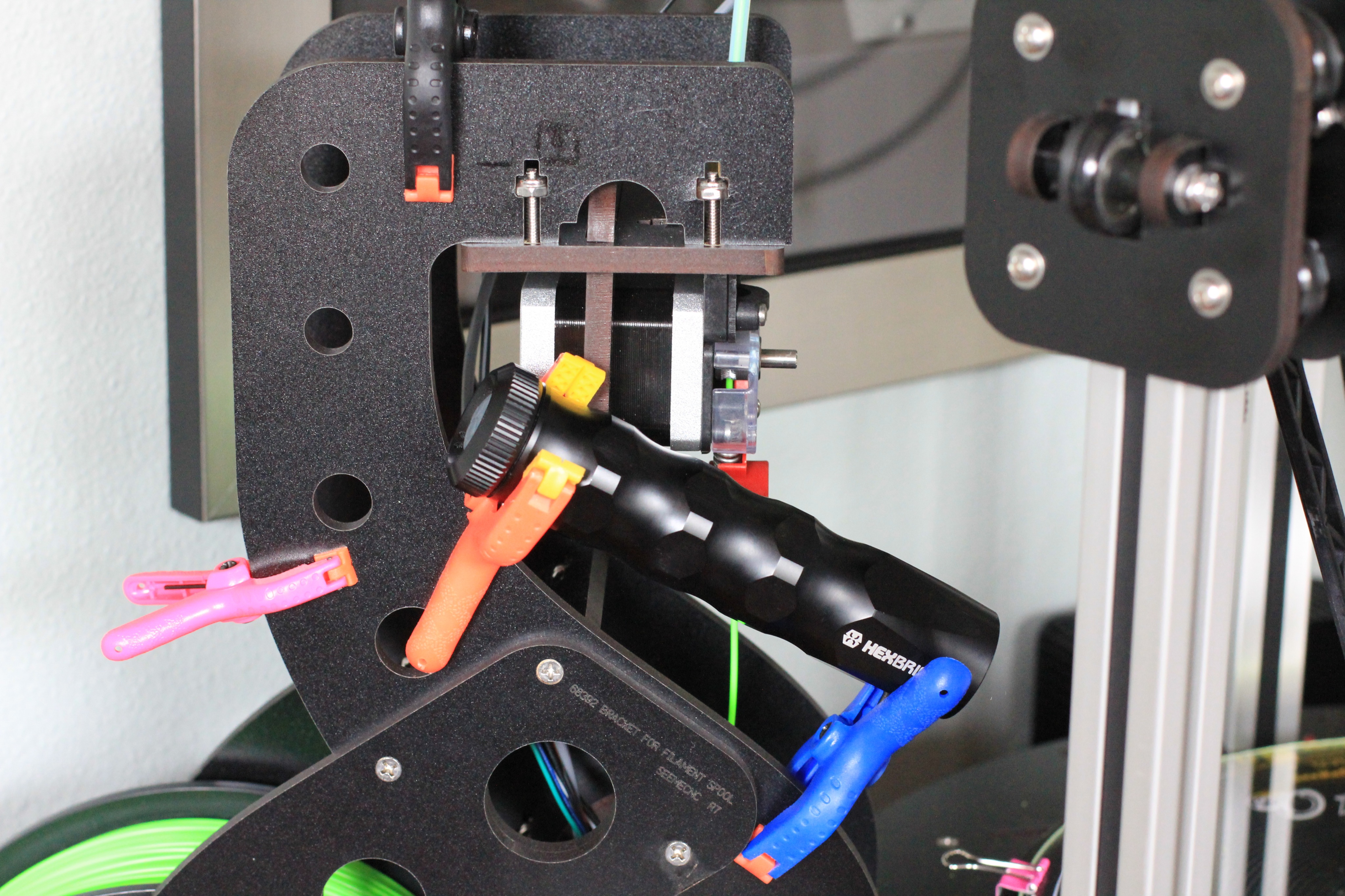

LED lighting installed.
Last night I was printing long after dark. Since there isn't a task light near my printer, I installed an LED lighting system. Sort of.
Those colorful clothespins are from Horrible Fright. http://www.harborfreight.com/22-piece-s ... 69374.html I use them to hold the Cheapskates in place when I transport the printer in the car.
Note the Onyx nail polish remover bottle. Only use genuine Onyx brand acetone; it was formulated specifically for your Onyx bed!
Off topic: Nice flashlight! I was sooo tempted to get one of those hexbrights, but I have too many flashlights as is.
Thanks. I find myself using it a lot more than I thought I would.ApacheXMD wrote:Off topic: Nice flashlight! I was sooo tempted to get one of those hexbrights, but I have too many flashlights as is.

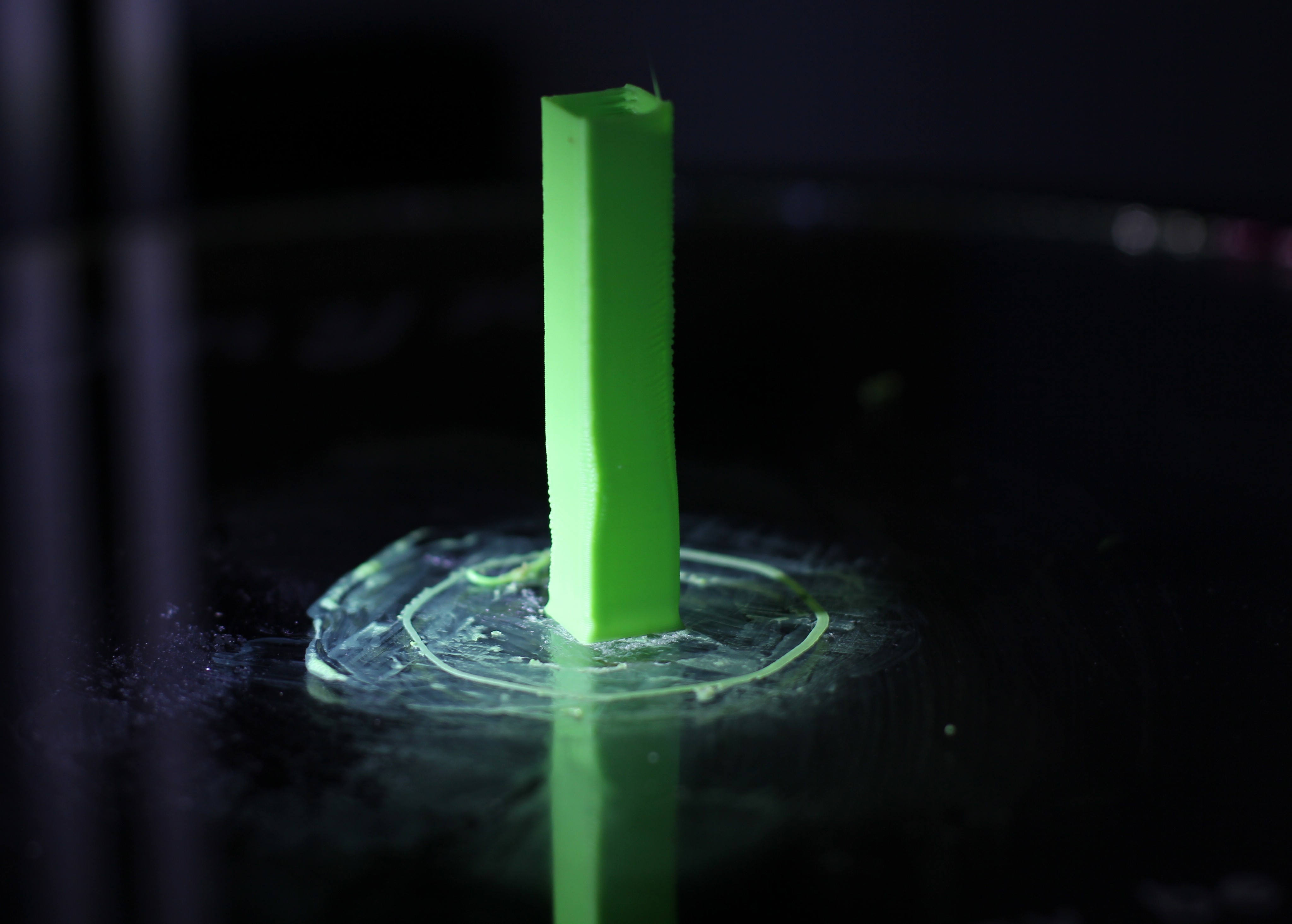

The 100% fill clube looks pretty good at 100%
The tower is a notoriously difficult print, the fact it even looks like a tower is a win. The issue is heat, if you really want to print a better one, pint 4 at a time, it gives them time to cool between layers, active cooling can also help.
You will get seams on parts, the start and endpoints have to overlap, the size of the seam is dependent on the slicer, and the settings in it.
The strings can be cleaned up with the retraction settings, 3mm is probably too little for the stock SeeMeCNC hotend, try 5mm of retract at 30mm/s and 5mm of Wipe in KisSlicer.
