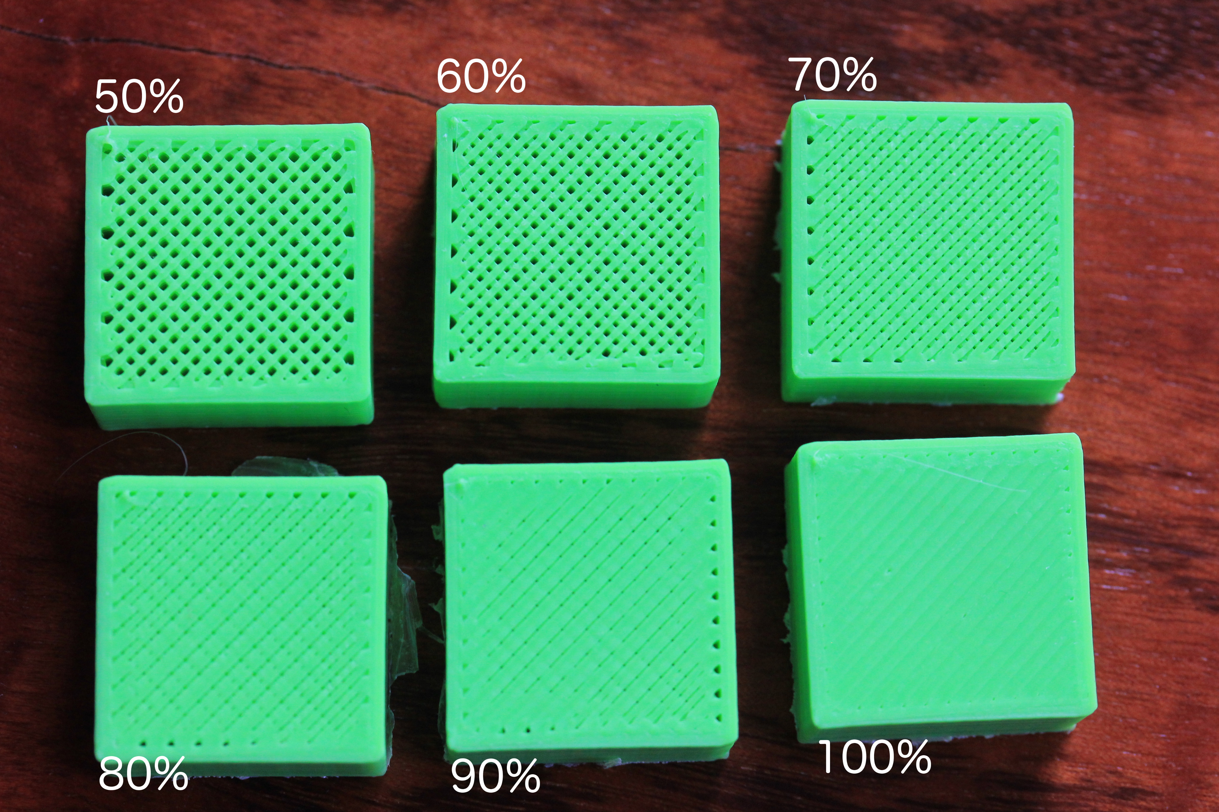

Now the printer is operational, it's time to dial it in.
I've read Gene's manual and followed the procedures.
I've read polygonhell's tips on tuning the amount of extrusion. I don't have a caliper with sufficient resolution yet (UPS is delivering it tomorrow). My digital caliper says the single layer wall thickness is 0.6 mm. Or 0.8mm. In lieu of the right tool, I tried printing the solid blocks with different infill percentages. There are visible gaps all the way up to 90% infill, so I set Slic3r's Extrusion Multiplier to 0.95 and called it good. I will revisit that when I get a new caliper.
Am I right? Am I way off? These were all printed with 0.2mm layer height and 0.55mm default extrusion width.
Is there another calibration document I should know about?
So that's what I've got. But here are the problems I know of.

Printing ABS with an un-verified thermistor is risky. If it's under-reading, you run the risk of ruining the PEEK section of the hot end - Harbor Fright sells a nice little meter that has a good thermocouple on it for under $40. (I'm lucky, I've got three HFs within easy driving distance!
I've found that I'm getting MUCH better prints from PLA than I ever got from ABS. I think it's a combination of different properties in the material and maybe PLA is a bit more forgiving of my uncoordinated stumbling around.
Blobbing and stringing boils down to slicer adjustments - I'm not good enough at that yet to recommend anything to anybody.
When you print a cube of known dimensions, how accurate is the result you're getting? BTW, a 20%-25% infill is plenty for most things you'll be printing.

The 100% fill clube looks pretty good at 100%
The tower is a notoriously difficult print, the fact it even looks like a tower is a win. The issue is heat, if you really want to print a better one, pint 4 at a time, it gives them time to cool between layers, active cooling can also help.
You will get seams on parts, the start and endpoints have to overlap, the size of the seam is dependent on the slicer, and the settings in it.
The strings can be cleaned up with the retraction settings, 3mm is probably too little for the stock SeeMeCNC hotend, try 5mm of retract at 30mm/s and 5mm of Wipe in KisSlicer.
