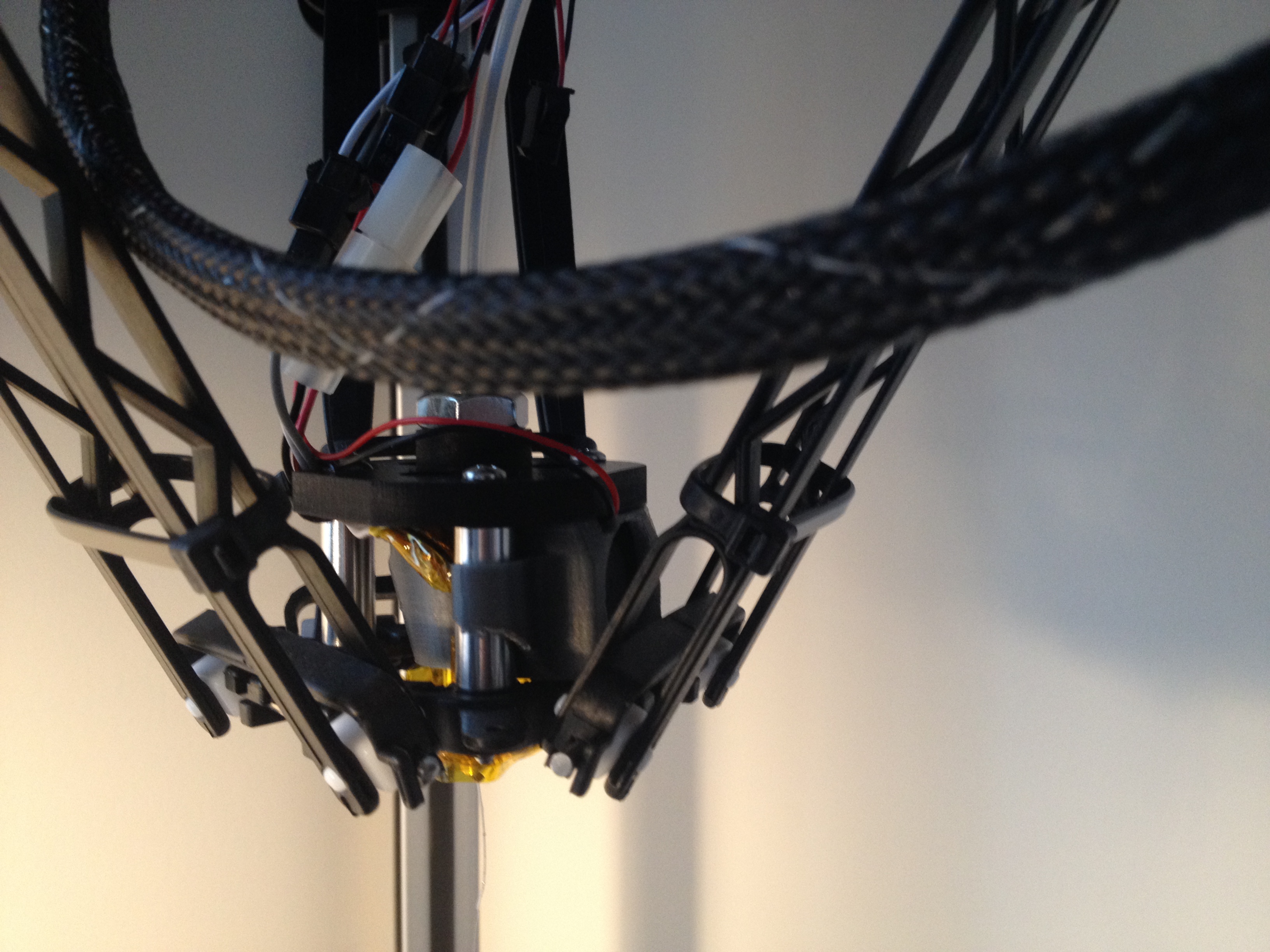

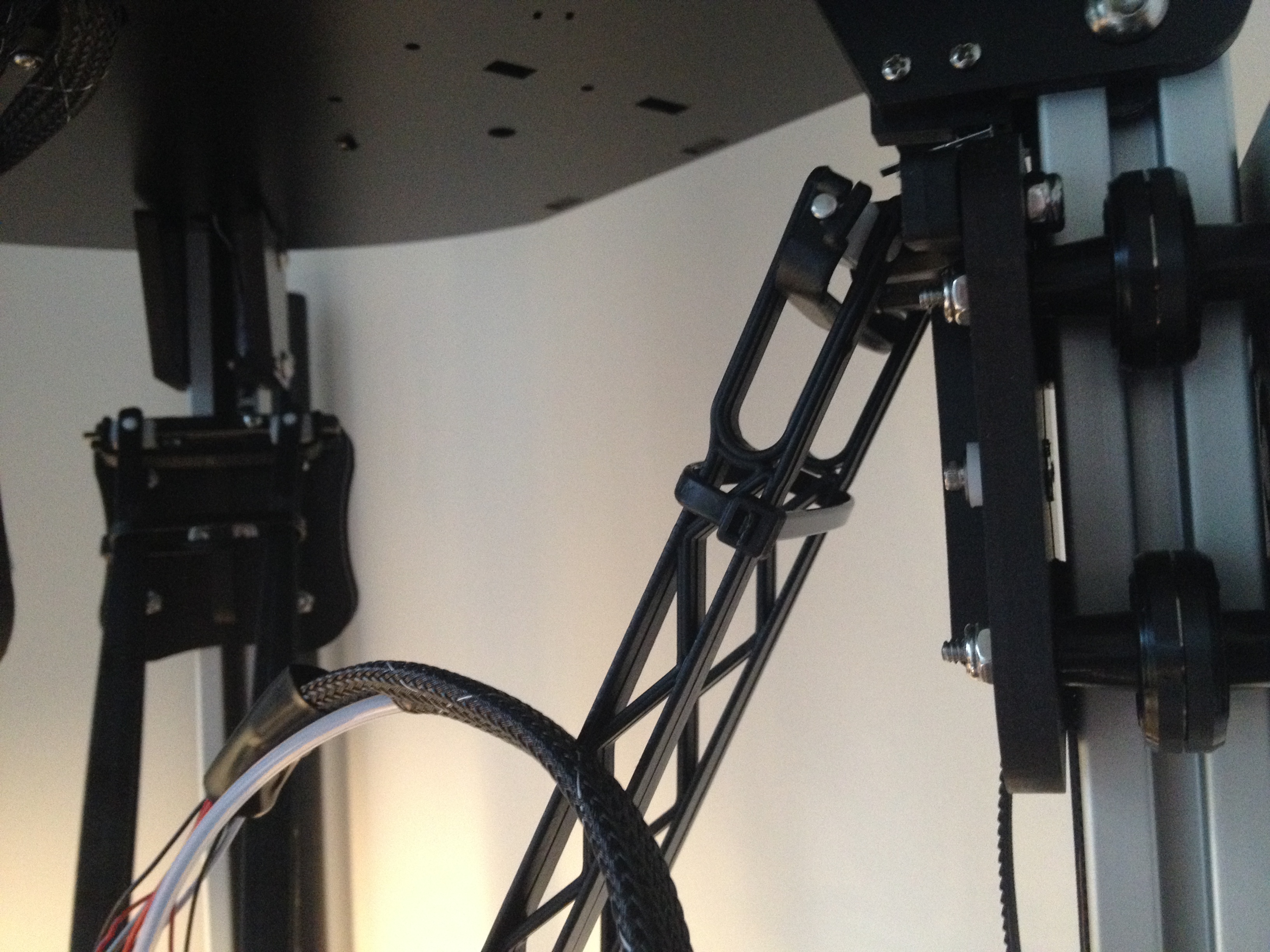

The top plates are physically bigger than the bottom plates, for certain, by about a few mm. The perimeter outline of them, that is. The tower channels line up precisely. (on the revision of the laser cut templates circa Sept 25 2014)
There is a noticeable amount of slack in the u-joint positions on the stock setup. I added some 11" cable ties to add tension to all the arms near the u-joints. It has stiffened up the effector tremendously. Where the effector used to slop and jiggle around before, now it is put firmly in place with no slop. The cable ties bind slightly at times, so a more forgiving solution like rubber straps might be better. (not to say that this is the cause of the "bermuda triangle" effect, but thought you might be interested in removing that as a factor)

Do you mean bind the 2 arms together?

bot wrote:The top plates are physically bigger than the bottom plates, for certain, by about a few mm. The perimeter outline of them, that is. The tower channels line up precisely. (on the revision of the laser cut templates circa Sept 25 2014)
This is exactly what you get when you buy the tricklaser arms. Rubber tubing bands top and bottom of each arm to take out any play.

Yes that's where I got the idea. Should have mentioned that. But it is quite obvious that the arms need help in stayin. Parellel.

bdjohns1 wrote:This is exactly what you get when you buy the tricklaser arms. Rubber tubing bands top and bottom of each arm to take out any play.
That's the best way to go. I would not use zip ties. Theoretically the arms should always be exactly parallel and the same distance from one another, and if zip-ties were two-dimensional, it would be fine. But - zip ties have a height. If the arms are perfectly in front of the towers, that height means the zip tie will be fully in contact with both arms. But what happens if you move the effector right or left relative to the tower? Now, the top of the zip tie's "wall" will touch one arm and the bottom of it will touch the other. Move it to the opposite side and the effect is reversed. The zip tie has no give, so it will force the arms to bend inward instead. That will shorten them proportional to how far right or left they are relative to the tower. A rubber band will stretch freely to accommodate this effect.
Trick Laser arms ship with some kind of rubber tubing that's held in place with laser-cut barbs. I lost one of them and just tied a rubber band to itself in its place, being careful to avoid too much tightness. It was tricky, but I've been tying my shoes for a long time so it wasn't THAT difficult. I like the TL solution but really, as long as you have some rubber bands that can be tied up without exerting too much pressure (and you really only need a SMALL amount) you're good to go.
It's important to put whatever solution you use as close to the hinges as physically possible. Rubber bands will give, but they will still try to pull the arms together, and you DON'T want to give them leverage! I make sure to secure mine around the hard plastic of the Traxxas joints rather than the flexible carbon fiber arms. DON'T let your rubber bands exert ANY pressure on the arms if you can avoid it!

It might even be worth it to use a 4" wire tie placed to prevent the TL rubber bands from "walking" up the tube over time. I can take a pic if that makes no sense. :) (Blue MAX uses the TL arms, but I don't have the bands installed)

There is enough "slack" in the cable ties to allow it to "slip" into place. It sounds like the ridges on the edges of the tie bind slightly on the plastic of the arm as it slides, but it seems to consistently move when it needs to. I was worried of the effect you speak of, pilot. The cable ties were simply an experiment. The issue of the binding only comes about during "extreme" moves, ie, not near the center of the build plate. I haven't yet tested the extremities of the build plate, but for prints remaining in the center the cable ties improved print quality noticeably.
On larger prints, if I notice the binding causing artifacts, I'll look into another solution. For the time being they seem to work great. Like I said, it tightened up the movement of the hot end effector considerably. There is no slop in its placement. It also raised the effector slightly, requiring me to increase the z height. This seems to indicate that the radius HAS been affected, as well (I had to tweak that, too) The cable ties are surprisingly consistent in where they sit. The curve of the arms, combined with the shape of the ends, with one arm's curve protruding from the surface of the length near the end, gives the cable tie a place to sit firmly when in the "centered" position (the position it was in when I installed and tensioned the ties). When it "walks" up and down the arm, it always finds itself in the same place at the end, not riding up the arm like I feared.
Further testing is required, but it seems to be adequate for now to remove the slack. Also, I have nothing to link this to the problem described in this thread, but it seemed relevant.

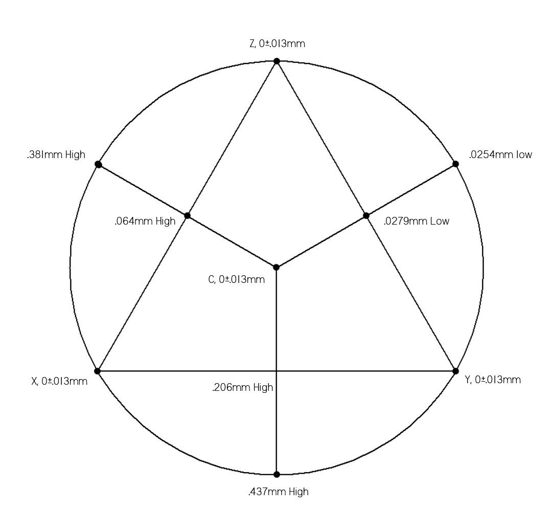

Getting a little closer...
I found a screw on my z skate that I failed to tighten during the build. It was on the Y tower side of the Z tower and at the top of the skate near the arm's u-joint. Getting the hidden screw tight was the start of getting consistent (but not yet perfect) results. Before the head would be low at the Y tower if approached from the X tower, but high at the Y tower if approached from the Z tower. Makes it impossible to set the end stop.
I currently have the four main calibration points (each tower and center) within 0.05mm. However, within the triangle defined by the towers I still have an overall variation of 0.1mm between the lowest point on my test print and the highest. My test print is a six pointed star with 18 post at 1.95mm height, 15 are within the triangle and three are opposite the towers. (see attached) Going outside the triangle still causes the end effector to rise. It was raising by as much as 0.4mm and its now down to 0.25mm. In case you can't read it, the outer circle radius is 129mm.
If anyone would like to take a look at the attached image I would appreciate any feedback one what I might change. I will try a slight decrease in the horizontal radius to raise the end effector at the center and I might bump the z end stop just a touch. After that, I'm wondering if I need to check out tower rotation and if so, how to best do that.
I need more minions!

Hey I know I'm still new to the forum, but I've been wrestling with this issue myself, and I'm scratching my head at this point. I've squared my towers as best as I can considering the frame design provides no way to adjust or fine tune the tower alignment, and all towers are square within .2 degrees. I've used a dial indicator to perform the bed calibration as described in the manual, though I've changed the points from 90mm from bed center to 120mm, in order to adjust the tower with it's arms as vertical as possible. Next I checked 3 points 120mm from bed center angled between each tower, and 60mm from bed center along the same lines. The towers and bed center are perfect (+- .5 mil), but the other points vary wildly. I know this thread is concerned zeroing close to the build perimeter, but do my measurements appear to be the same issue or a separate one? Measurements are relative to the center of the bed.
The sector between angle Z-C-Y seems to be fairly close and even to the center, but everything else seems to be off significantly. This leads me to believe that most of my error is coming from the X tower, either from the tower's alignment, or the carriage's interface with the tower, or the mounting point of the shaft the arms are attached to. Like I said before though, as best as I can tell, each tower isn't more than .2 or .3 degrees off measured towards the center of the bed, or tangent to the bed.
Any thoughts would be appreciated!
EDIT: In case it helps, I've also gone through a lengthy session of playing with the tower rotation values with no luck, And I have a spreadsheet with those values as well if anyone thinks that data could be useful. Also, what should I be targeting for "Good enough?" Does anyone know how tight of a tolerance all points should be to be considered "level"? I would think 25 microns would be pretty good, but I'm a relative newcomer to this sport.
