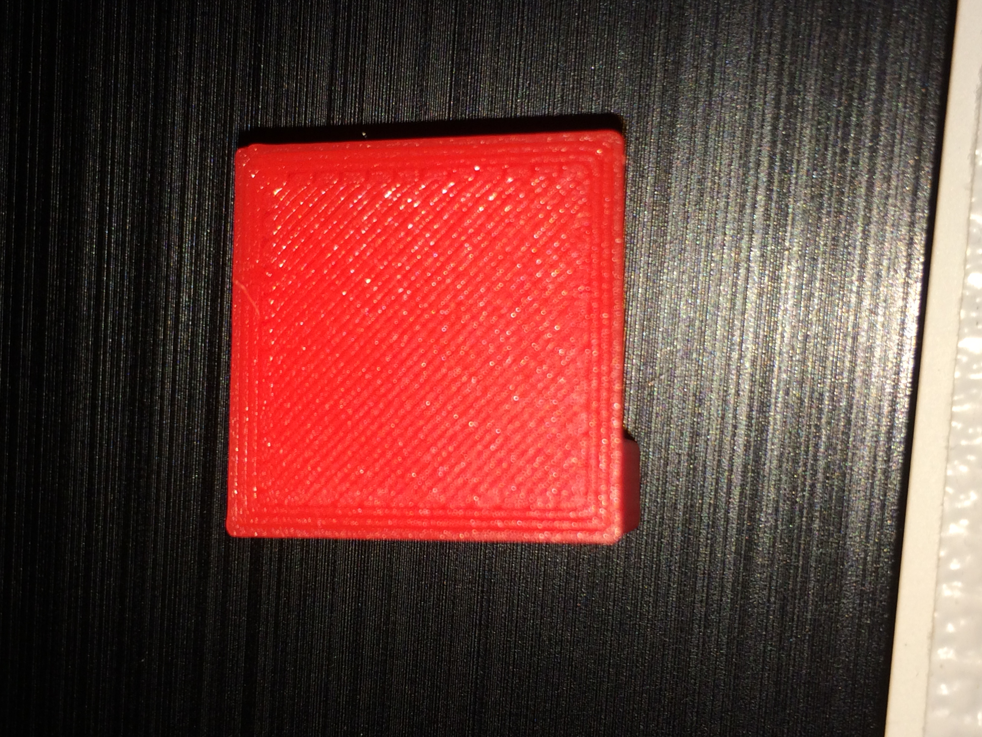

I saw it posted earlier but some files I'm using. Note, I was confused on nozzle size and thus left mine as a 0.4 nozzle. I also wanted some purge code so this leaves a little nozzle cleaning dot at maximum Y axis on the bed. Assures a perfect prime every time.
The bed leveling one is just this adjusted for a safe size.
http://www.thingiverse.com/thing:50505
Eris.zip has my S3D profile.

Eris20mmbox.gcode
(60.71 KiB) Downloaded 846 times
Eris_Bed_Level_Aid.stl
(89.93 KiB) Downloaded 754 times
Eris_Bed_Level_Aid.gcode
(65.51 KiB) Downloaded 833 times

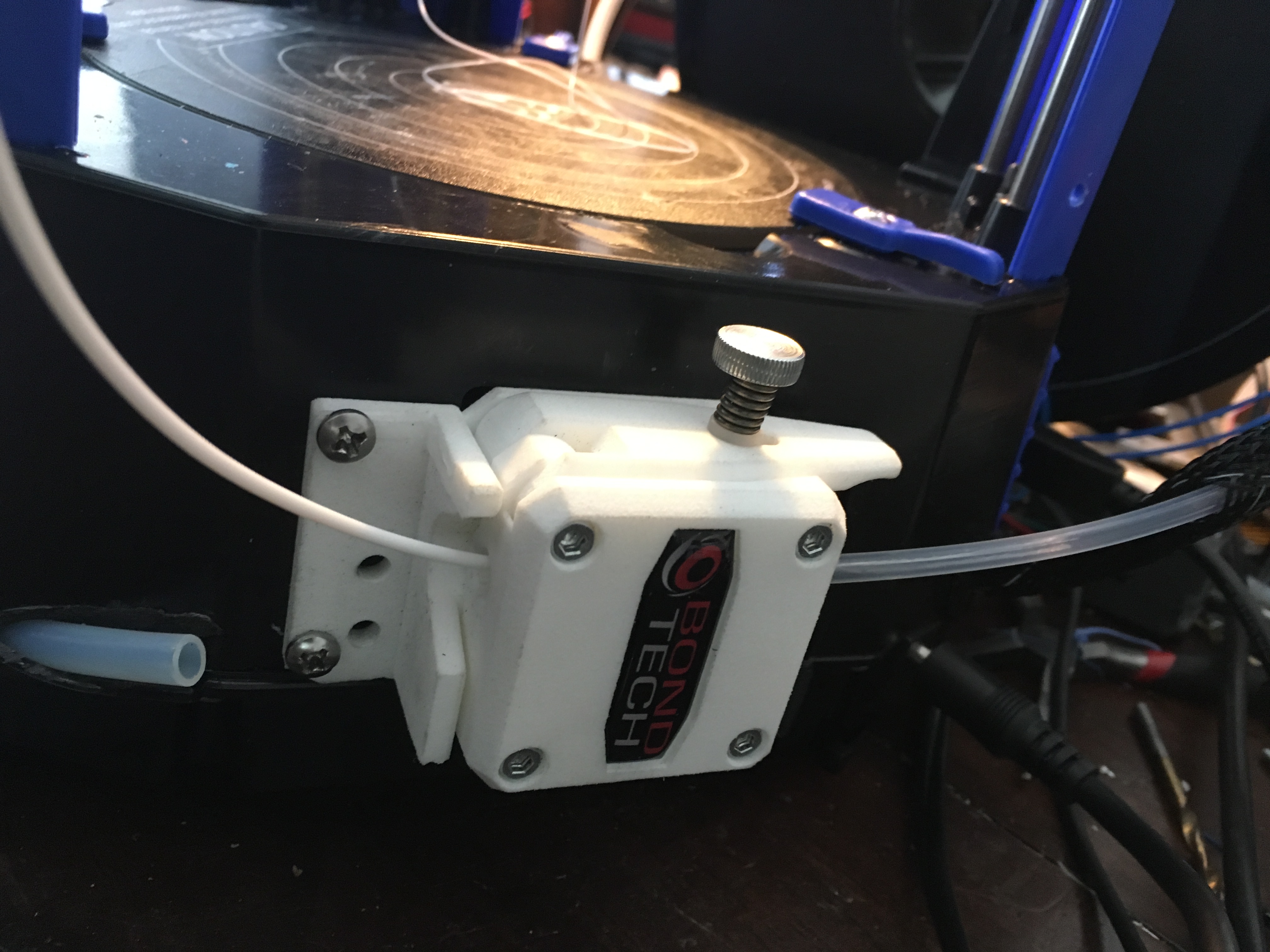

I'm still playing at this point and yes, the stock nozzle is 0.5mm so my S3D profile is not technically correct, although that was giving me nice looking prints, not "dimensionally accurate". My test cube was slightly oversize in XY (20.12mm).
FWIW, I ran into every problem I've seen in the group listed.
I upgraded the feeder because I had a Bondtech mini and it looked like a good fit. And it is.
You simply need to do a few things.
#1 reverse the extruder motor plug since this feeder is opposite.
#2 Drill 2 mounting holes. (This could be corrected by designing a proper Bondtech housing just for this printer)
#3 adjust E-steps in EEPROM for the new extruder.
However in doing all this, the Bowden tube kept pushing out of the pushfit now that the extruder feeder was "upgraded"
So I just had some more PTFE tubing fresh and replaced it.
I "thought" I seated it all the way in the hotend. As you know in this group, this is a huge mistake and makes a real mess of it.
The morning was spent cleaning and rebuilding the mess. Then I figured why not try a real coated Micro Swiss (previously AVN Swiss) MK8 style nozzle?
The threaded shank matched, the tip is longer but with autocalibration- no big deal.
Just keep in mind, I have a huge parts bin and relationships with these upgrade folks, so some of this is to see what works.
I'm not saying these are must do mods or there is anything wrong with Eris.
Sure, if I was too close to the bed I could make the stock EZ-struder grind filament.
Sure, you could totally stick with the stock nozzle and it's shorter- so maybe the fan ducts work better stock.
Also, this is all just so I can show the Mosaic Palette 4 color device attached to Eris.

Bondtech mini. Guide tube is not connected as I was loading a white filament for Palette calibration from an alternate spool.
Note, this housing was for a different printer and I literally snipped off a lot of the printed bracket. Just emailed Bondtech and maybe they can make a far better design.
Also note, I like the lever and spring up, but that makes the stock spool to feeder guide tube out of alignment. Clipping the upper molded bracket of the feed tube away allows for perfectly acceptable usage as stock.

gkrangan wrote:Hello Experts,
I'm new to the SeeMeCNC forums. I have some decent experience with 3D printers. I have also built and setup a Kossel Mini myself.
I saw this new Eris at my local MicroCenter over the weekend, and picked one up.
Overall, the getting started to my first print was pretty good.
Few thoughts:
- Getting the filament through the EZ-Extruder was a bit of a challenge. I guess, it requires a bit of a knack, but I finally managed to get it through.
- The cable connector on the hot-end was loose, out of the box. I noticed that during my initial inspection, and re-seated it, but it was still not seated properly. Thus the calibration process would get stuck. Finally, I managed to get it seated properly. But beware, the plastic around the pins is not very strong, and front-facing side broke, but it's kinda still hanging in there. However, it is flimsy for sure. Once, the cable was seated properly, the calibration went fine.
- The biggest issue I'm having is with the bottom layer. Please check out the attached image. Are others getting the same results as well (better, or worse)? I was going through the default settings, and there does not see like there are a whole lot of parameters to adjust, other than the following:
bottom_solid_layers = 5
I also see a similar issue with the top-later, but it is slightly better than the bottom-layer.
top_infill_extrusion_width = 0.6
top_solid_infill_speed = 25
top_solid_layers = 5
- Finally, the retraction length appears to be currently set to 4.5. I guess that needs to be increased, because I see some stringing.
retract_before_travel = 2.5
retract_layer_change = 0
retract_length = 4.5
retract_length_tool_change = 10
retract_lift = 1
retract_restart_extra = 0
retract_restart_extra_toolchange = 0
retract_when_changing_islands = 1
retract_speed = 100
Can anyone recommend what changes can be made to get a better bottom-layer finish? Any help would be greatly appreciated.
Thank you.
Hello Folks,
Remember, I was complaining about weird bottom layer issues, earlier this week.
I'm happy to report that this issue is resolved, thanks to Mike @ the Columbus, OH MicroCenter.
He is quite experienced with various slicers, and has written one himself. I was discussing this issue with him earlier this morning, and he made a suggestion after reviewing the default Eris settings from SeeMeCNC.
There is a setting in the MatterSlicer config called first_layer_extrusion_width that is currently set to 180%, by default.
If this is reduced to 100% (or 0.6) instead, it fixes the weird first layer issues.
I tried the above, and it completely solved the first-layer issues I was having. Please see the attached picture for the results.
For others who may be seeing such issues with the first/bottom-layer, and are looking for better results, please try the simple slicer config change above and see if that helps.
Cheers.
