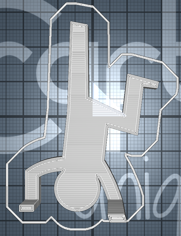

I've seen the same thing with slic3r. You can fiddle with the "infill/perimeters overlap" percentage to adjust this (in the "Advanced" tab).
In some cases the only way that worked for me was to lower the number of perimeters (vertical shells) to 2.

Ok, so here is what I mean by slicer settings...
The first below is your gcode file, unmodified, loaded into CraftWare for viewing.
The second is my file, but also take note that I am printing with a Prometheus V2 using a .3mm nozzle.
The third is a representation of printing with a stock .5mm nozzle using my CraftWare settings.
#1
#2
#3
The main thing that I notice is that your gaps seem to coincide with the small little gaps shown in the screenshot. You can click it to see the fullsize image. Any area that seems to show bed through it, will show bed on a real printer, simple as that.
Try printing the attached Gcode on your printer. I tend to run pretty conservative settings within the printer community, but CraftWare estimates your print to complete within 20 minutes.
The attached Gcode are set to print the first layer at a height of .2mm, at a speed of 10 mm/s and then 30 mm/s for the second layer and on, with a resolution of .2mm. Both are set to print at 230 because I usually only bump my prometheus to 240 to print with ABS. 230 to 210 is what I print PLA. If you don't like the temps, preheat your printer to whatever preferred temps you have found, and start the gcode from either the sdcard or your preferred printer host. Once the printer or host has engaged the Gcode and sets my preset temps, just go ahead and set them back to your preferred temps that you just preheated to. The print will continue at your temps and you will be able to try different temps to your satisfaction.
DISCLAIMER: IT IS NOT MY FAULT IF THIS GCODE HARMS YOUR PRINTER. I HAVE USED THESE SETTINGS RELIGIOUSLY ON MY PRINTER AND THEY HAVE WORKED FOR ME. PLEASE MAKE SURE YOU HAVE YOUR PRINTER CALIBRATED AND YOUR BED Z-HEIGHT PROPERLY SET.

This is a well known issue with slic3r. One way to deal with it if you are stuck with using it is to rotate the part so the sharp angled leg (in your case) is either parallel to or less angled than the perimeter. Many times just a 5 degree rotation will miraculously clean up those first layer blues.
