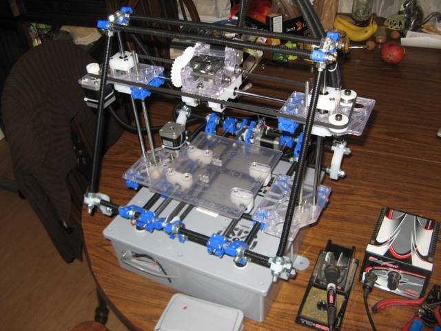

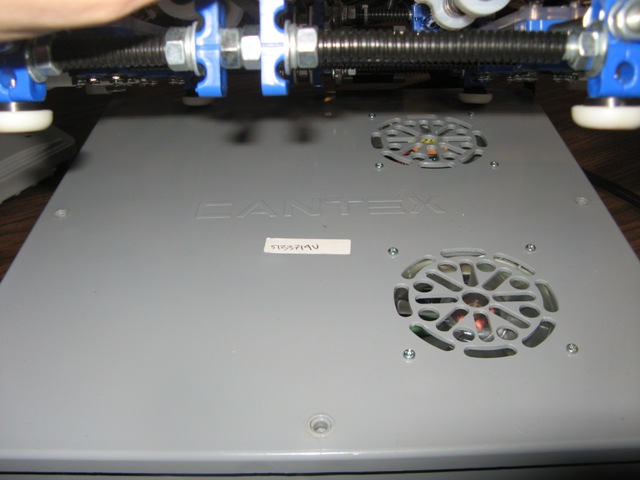

Here are some more pics of the printer, hot end, and electronics enclosure
overall shot
overall shot
MK138 housing
MK138 housing
and where they will mount

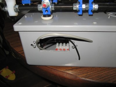

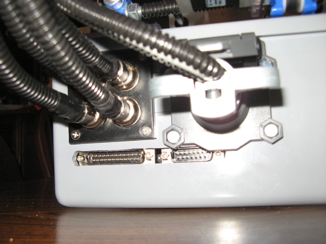

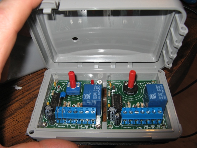

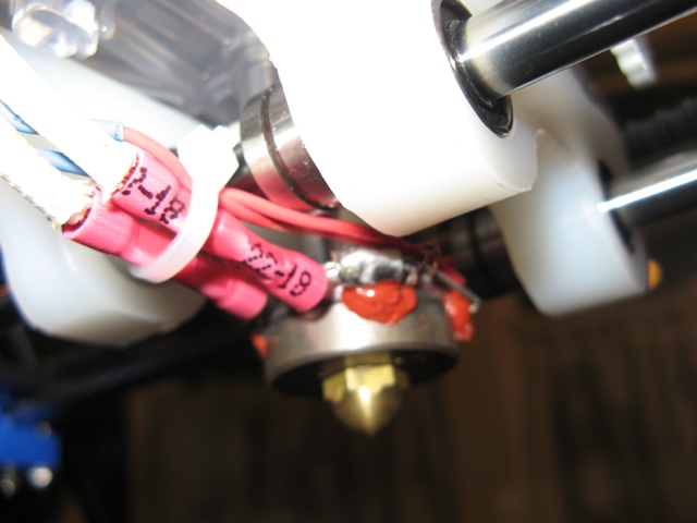

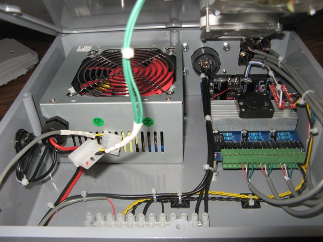

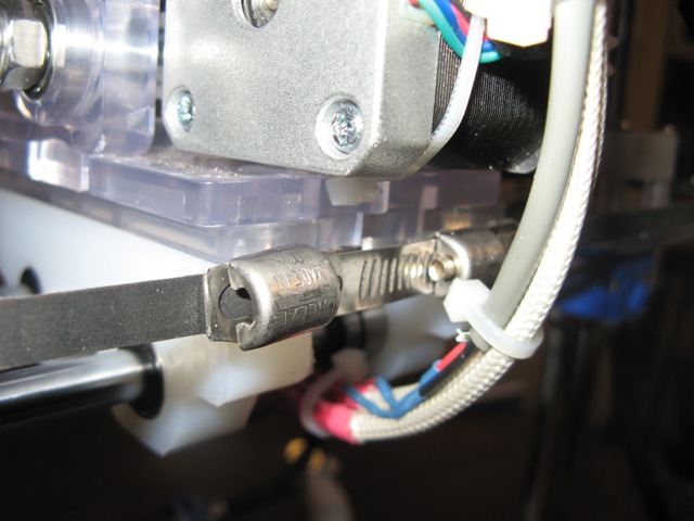

Here are some pics of the hot end wiring and the stepper plugs
JTCUSTOMS
JTCUSTOMS
Posts: 100
Joined: Mon Mar 26, 2012 1:33 pm
Location: The "HAM" Washington
Re: JT's H-1 build log and mods
Post by JTCUSTOMS »

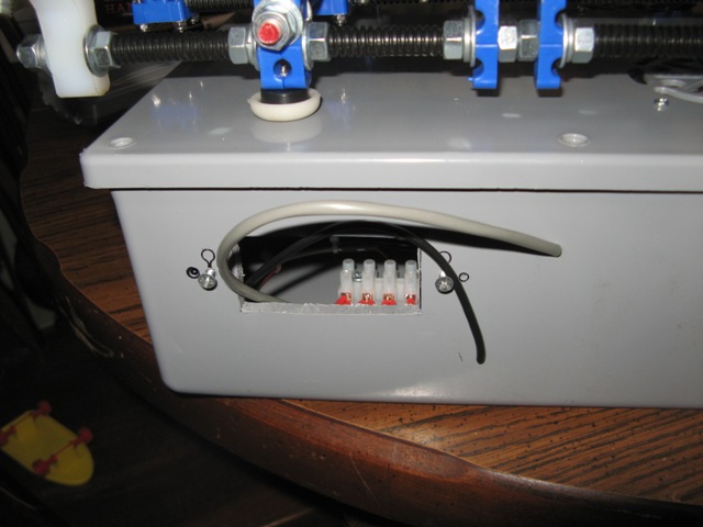

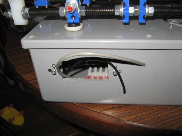

And some pics of the quick and dirty electronics enclosure.

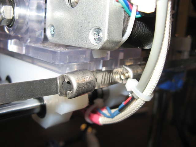

Here is a pic of the belt adjuster<br />works pretty good.
works pretty good.

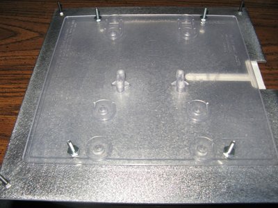

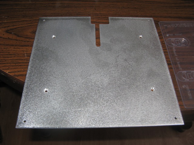

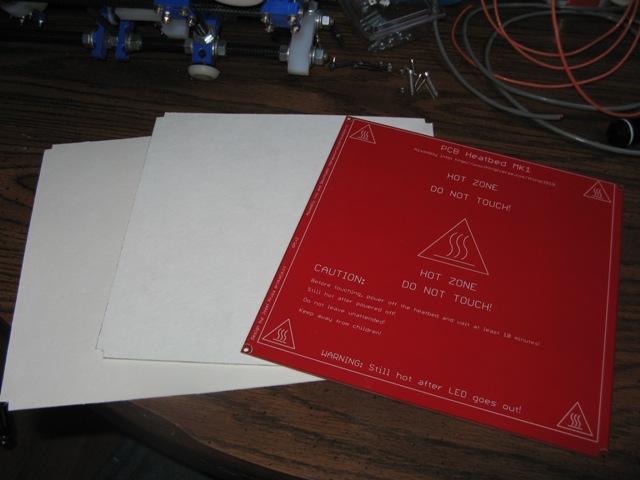

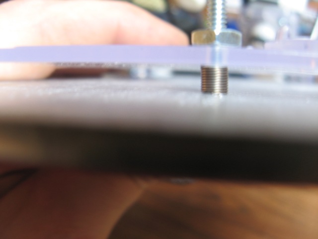

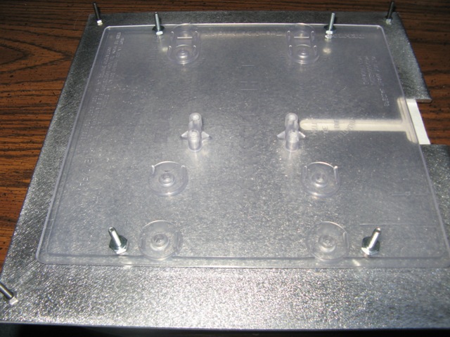

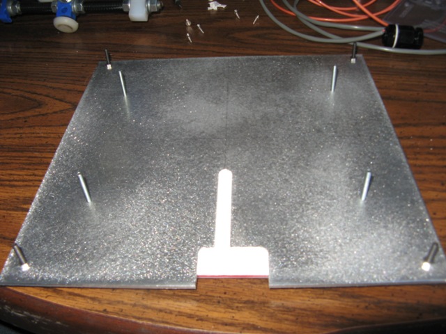

But here are some pics of the start of the MK1 heat bed mod and sprung table.
Got some insulation and tempered glass cut for the top, wish the glass was a little bigger, but oh well.
Here is the AL plate notched out for the thermistor and power connections
Here is the heat bed and insulation I cut out.
Here it is with the adjuster bolts and insulation and heatbed bolted together, have to trim out the insulation and trim the outside bolts
Here is the spring setup, I will release them a bit. But the whole shebang is only .475 thick with them released a bit.<br />I used 6/32x1 countersunk screws and the heads are epoxied into the AL plate.<br />The height is not an issue as I gained travel by changing out the bent all threads, still more than stock H1
Hers is the bottom all bolted together, will probably print up some thumbwheel adjusters as a first project.
