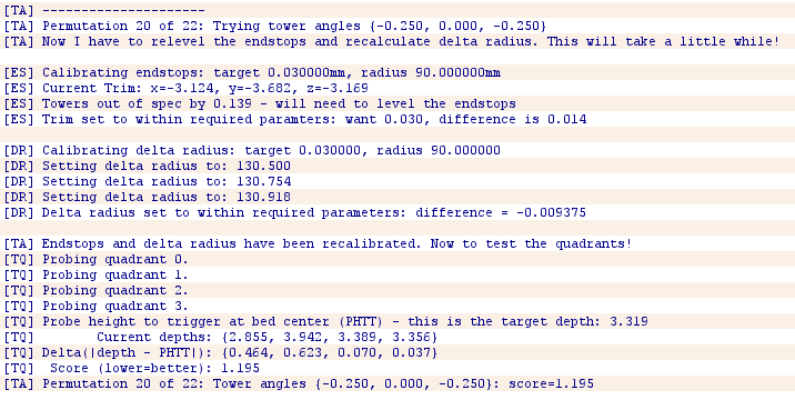

I have some experimental confirmation for the "outside the triangle" bug. I mounted my Z-probe and ran some test code that implements the arduous tower rotation tests presented earlier in this thread. It runs through a bunch of permutations in which it tries adding or subtracting 0.25 degrees to one or two towers' rotations simultaneously, relevels the endstops, recalculates delta radius, and then probes all four quadrants (northeast, northwest, southwest, and southeast) to check their elevations and compare that with the elevation at bed center.
Altogether it runs 22 permutations:
X+0.25
X-0.25
Y+0.25
Y-0.25
Z+0.25
Z-0.25
X+0.25 AND Y+0.25
X+0.25 AND Y-0.25
etc...
Repetier's "copy" function is out to lunch, so here's a screenshot:
[img]http://forum.seemecnc.com/download/file ... &mode=view[/img]
Look at the line near the bottom where it says Delta(|depth - PHTT|). That tells you the difference in elevation between bed center and the tested point. The two "north" quadrant test points (first two numbers on that line) are outside the triangle, and the two "south" test points (last two numbers) are inside. The deviation on the north test points are several times larger than the south test points. Moreover, it's ALWAYS that way! I can show you any permutation and the same thing will happen in every case.
I may wind up re-doing this method to test six points (three for each tower, and three at the halfway points between the towers). That would keep them all inside the triangle, near or right on the edge. Since we already know the math is screwed up for points outside the triangle, there's no use in probing them in the first place.
