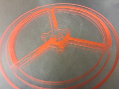

Seems like I have been exchanging one problem for another for about a year now... Getting time to get some descent prints now! What could be the cause of the behavior in this picture? The nozzle does some strange lifting even if still in the first layer. I have already checked the belts and tightened them from scratch when I was getting the towers aligned yesterday.
The bottom left leg of the ring is pointing to the X tower.
I was wondering what's the best way to check the gears slipping and how to tighten them without dismantling the whole thing (again).

Is all that infill shifted itself over/away from the X tower?
It looks like theres some adhesion issues too?

I was hoping so, but I think they cannot be reached without lifting the top baseplate, can they?Mac The Knife wrote:You should be able to check the setscrews for the timing belt pulleys on the motor without having to disassemble much.
Yes you saw that right. It is not because of adhesion problems though, because I can see the the nozzle multiple layer thicknesses above the bed almost spraying the filament to the bed and it still sticks.Turpinator wrote:Is all that infill shifted itself over/away from the X tower?
Yes I have thought of that too. But the printspeeds here are really low already like 30mm/s or so, and this is the small version of the calring so it not going near the edges, but halfway at most. But it is worth checking the jerk and acceleration values for sure. Happen to know the defaults for a V2?Polygonhell wrote:But it could just be too much speed/acceleration or jerk in the firmware, as you print at the edge of the build area, because of the delta kinematics the carriages have to move at almost 2x the commanded speed, that is makes axis much more likely to skip steps.
This is happening after an attempt to get rid of tower lean, I also redid the belt tension, but I cannot say that it changed much compared to before. I might have touched the skatewheels tension to, because I noticed a few that were not rolling during movement. The skates go up and down as easy as before, except fot the Z tower that seems to drop a bit on its own weight when steppers disconnect. In the first attempt to print this the effect was a lot bigger, where the hotend swung into the air when going to the Z tower, and coming down again when travelling away from it.

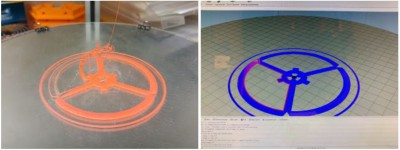

I also resliced the cal ring, and when printing it does not show the short head to bed move at x0 y0 anymore. But the shifting problem is still there. In this case there is an obvious lifting too, so not just horizontal shifting.
https://youtu.be/Ra1XzrKdtOU
If I put these pictues next to eachother, it gets clear where the problem starts (compare print path in repetier to the actual layer being laid down) The gcode for the ring is this:
All to no avail...
Any ideas left?
All to no avail...
Any ideas left?
