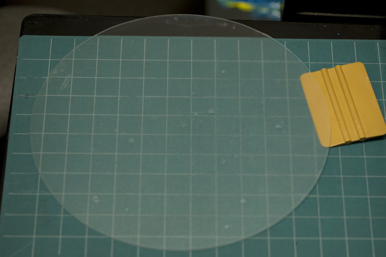

I bought a couple squares of this to test out. I figured the low price combined with adhesive back would make it less labor intensive than the PEI sheets that most people are using.
My first impression is that this stuff has the same texture and thickness as the window frosting that you buy at Home Depot to make glass offices, bathroom windows, and the like non-transparent. I have personally put that stuff on to a sliding glass door, and it is almost exactly the same. The only difference that I could find was that the window frosting didn't have a sticky back, but perhaps some is made with a sticky back.
I floated this onto the glass using Windex, so I could push all the bubbles out. It probably would have been easier if my sheet hadn't been rolled back when I received it. Flipping it upside down with some water bottles on top of it over night got it to settle flat. (Note: I have no idea how Matter Hackers shipped the material. It was repackaged by my dad and sent to me with other items).
I have only two prints under my belt with this. I was printing MHackney's 75mm calibration circle to test my first layer thickness. The adhesion was quite good with ABS at 60C. The adhesion seemed to be better than hairspray or glue stick. I was able to easily remove the prints after cooling. The finish was also much cleaner looking than I got using either glue stick or hairspray.
I will post a follow up when I try larger objects that are more prone to warping.

That's how I installed mine as well, just like window tint. Float it with Windex and squeegee out the bubbles. Wait until it's dry, and then it's easy to run a razor knife around the edge and make a nice finished looking install.DGBK wrote:I floated this onto the glass using Windex, so I could push all the bubbles out. It probably would have been easier if my sheet hadn't been rolled back when I received it. Flipping it upside down with some water bottles on top of it over night got it to settle flat. (Note: I have no idea how Matter Hackers shipped the material. It was repackaged by my dad and sent to me with other items).
