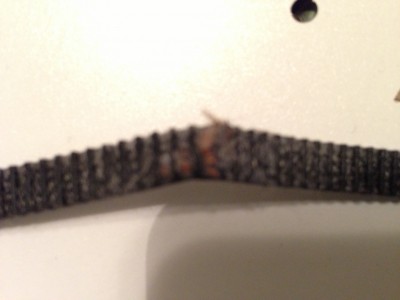

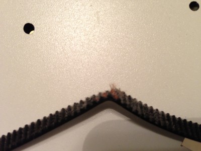

Re: First 3D Printer Build
I have some belt damage. Anyone wanna guess with axis??
Y
Can you photograph the belt damage? How many hours of operation do you estimate on the machine? How tight are the belts? Curious minds want to know!
Y is correct! I'm impressed
I estimate less than 8 in prints and at least 30hr calibrating height. Pretty depressing when you think about it....
Not really sure how to accurately convey the tightness of the belts. I pulled the belts as hard as i could then clamped them down. I also had the top bearings pulled up about halfway.
I am guessing having the belt too tight caused this?
