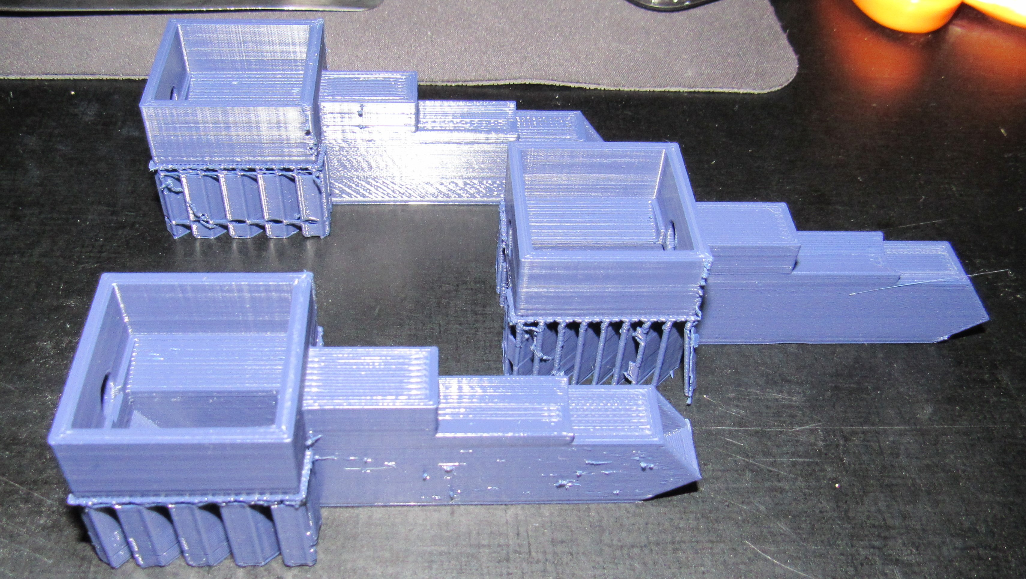

Hello All,
I'd love some feedback on this print. I am working to get the perfect PLA settings for my printer. I see defects on the side of the print and I need to find a way to make the supports easier to remove. They are too tight to the print.
These three fan shrouds were printed together. The fan shroud that sat in the middle of the build plate shows no major defects while the other two do on their outer side.
The Print: Settings:
MatterControl 1.4 with MatterSlice Engine
Material: SeeMeCNC Blue PLA
Thanks a Bunch guys!

Re: Feedback on print quality
The only thing that I would focus on is your Temperature and Gap, 210 makes it very runny so it essentially snots everywhere. My extrusion multiplier is set to 1 but that is dependent on how calibrated your extruder is. If you remove the Bowden tube from the hotend and manually extrude 100 mm, measure that it is 100 mm with calipers. If not, you'll have to do the math and save it to your machine. Yours doesn't look like it's being starved so I think you are good.
If you can test your max feedrate with the lowest possible temp that should help a lot in controlling the overflow and all the pimples you see on the surface.
As far as the spacing for support connecting to your model, you can find that setting under General-Support Material-Air Gap
Vertical banding on delta printers is symptomatic of firmware that uses segmentation and/or stepper drivers that don't do low current microstepping well.
