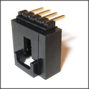

I received a duet 0.6 board last week through T3dP3d. Now it has those green screw terminals for the stepper and thermister cabling. What is the smartest way to connect everything, without just cutting off the connectors of the existing cabling? I like to keep the possibility to connect the rambo again. Not because of distrust in the duet ;-) but because of when I decide to by or make a metal frame, I can keep the old one going with the rambo...
I could make some adapter cables, but would it be smarter to use a IDE cable and go with that?

I would just make little pigtails. The only way I can think of to use an IDE cable would be on the expansion header, and you'd need stepper drivers and other hardware for that to work properly.

It seems to me that all the screwterminal positions also have a position on the IDE style pins. They are labelled identically. But I think I read a warning somewhere to not do this, because of possible problems delivering enough power for the motors. I think "pigtails" is the way to go indeed.

I make little piglets myself - that way I can swap out controllers to test new ones very easily. I use the locking molex connectors like the RAMBo uses for these since they lock.

Can you please make a suggestion to the used connectors? I am having difficulty finding the right type of molex, that I can solder or crimp to a cable instead of mounting on a pcb... Thanks!

Make sure to get the correct pins - the female side has a different pin than the male side. I assert these should be used on all controller boards - positive lock. I took my Kossel250 to a presentation I gave last night and the 4 pin PanelDue connector came loose. I forgot which of the pins it attached too so I had to look it up minutes before my presentation started.

mhackney wrote:Make sure to get the correct pins - the female side has a different pin than the male side. I assert these should be used on all controller boards - positive lock. I took my Kossel250 to a presentation I gave last night and the 4 pin PanelDue connector came loose. I forgot which of the pins it attached too so I had to look it up minutes before my presentation started.
I guess you were using a Duet 0.6 then? The 0.8.5 and the WiFi have locking connectors.

Yes, we were talking about a Duet 0.6 which I got for a nice price. Of course I never considered the connectors beforehand, and I read in your blog about desoldering the screwterminals, but I am most likely not a solderguru like you ;-) so I wil have to think up some adaptercabling.
Wouldn't these fit instantly?
But they will probably block the neighboring endstop connections...
