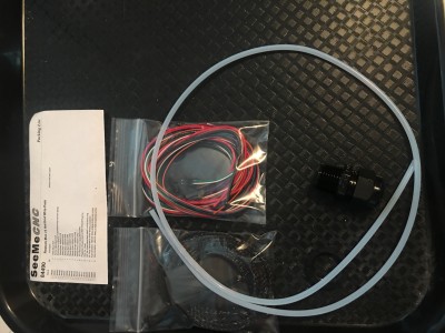

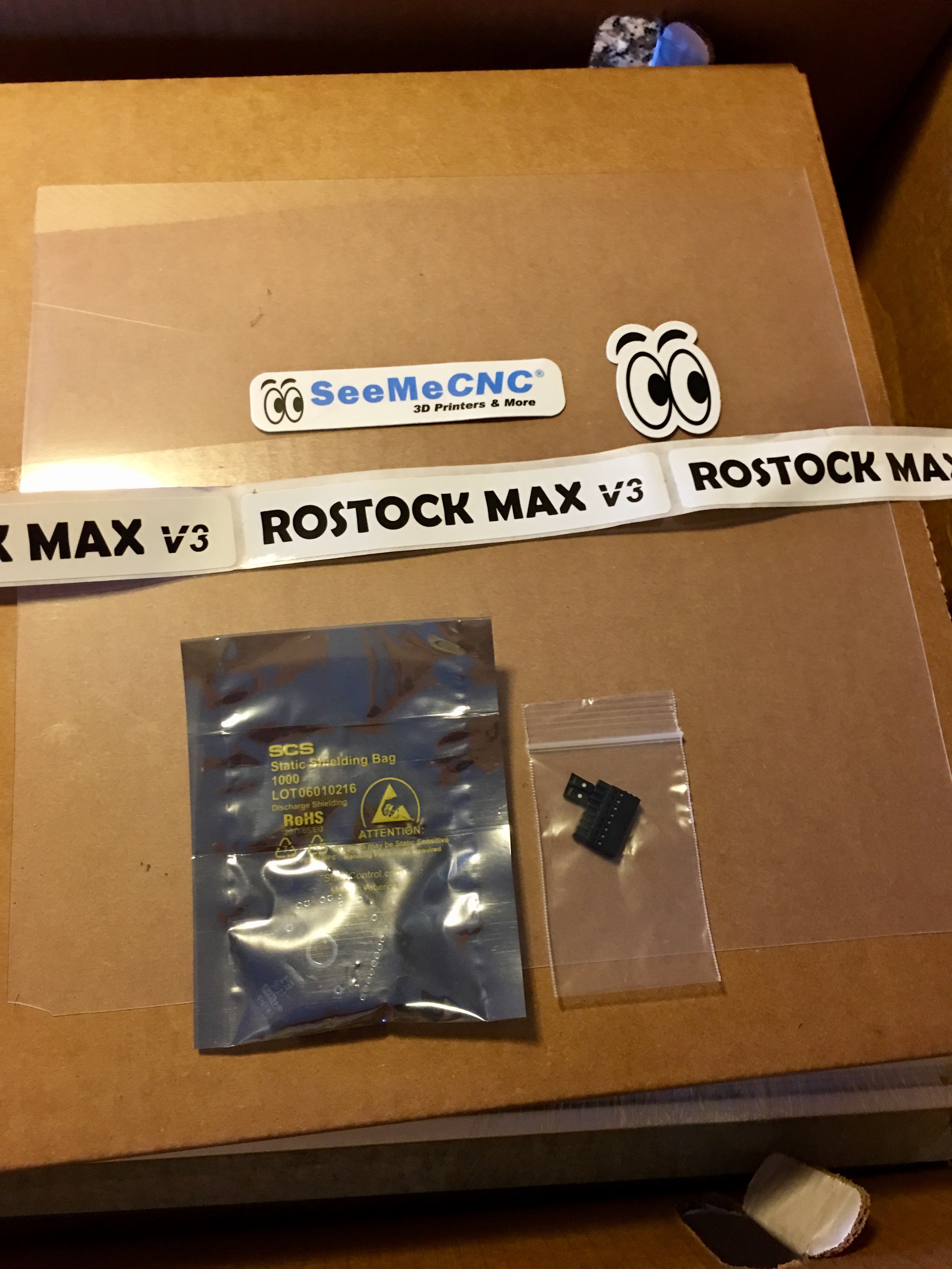

I say this with all the parts for the HE280 played out before me ready to assemble!
Step 8 on assembling the HE280 requires two 2 position terminal plugs. Which bag are these in? I don's see them looking through the sacks without opening them. They are not in #84490 or #71290.
They might be living in the RAMBo box.
Ok, I'l check there. It's not like I don't have extras laying around, just want to see if there are places for some feedback and/or to help others.
Yup, that's where they were. I edited the first step in the doc to state that.

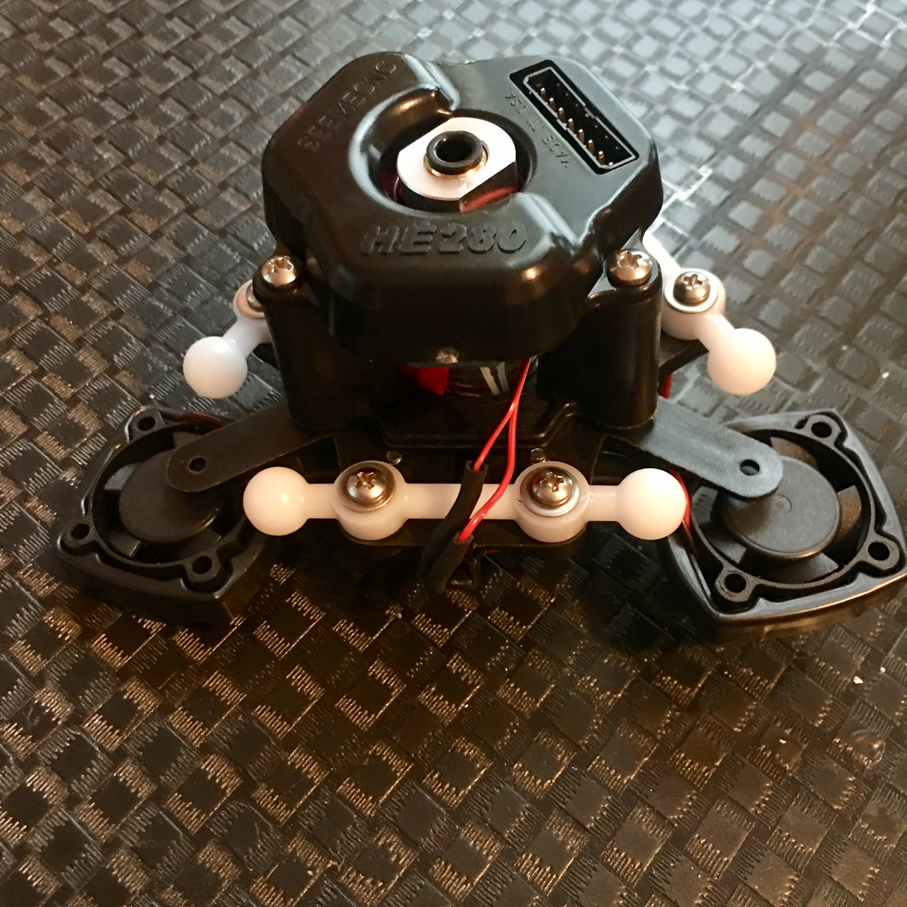

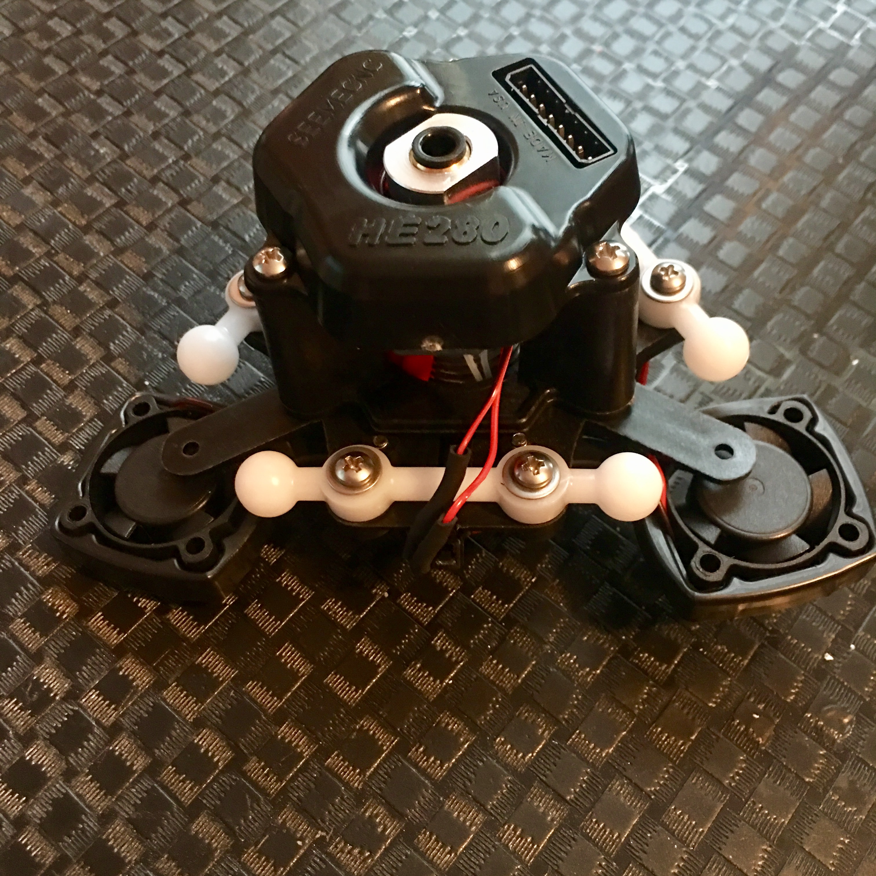

HOT end!
Ok, completed assembly of the hot end. Total time about 1hr 30minutes. I really like how nicely designed and integrated the hot end/effector/wiring/accelerometer are. Very nice, sophisticated and evolved design. I'm really looking forward to putting it through its paces. The thermal fuse is a brilliant idea and should be standard on all hot ends!
I added a tool list to the Dozuki docs so hopefully that edit will be approved. I also edited the step I mentioned above so folks know where to find the two connectors (RAMBo box).
Here is the finished unit just waiting for a printer to attach to:

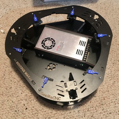

Bases Loaded
The base assembly complete. Slightly under 2 hrs.
I didn't realize the onyx/glass float like that.  Seems like a huge improvement over the screwed down v2.    Is it only one screw going through the blue locking paddle that holds those plastic tabs against the base plate?
If so, hope we can purchase those in the future. I'd gladly cut a giant hole in my v2 base.
Yes, 1 screw. I still think this is over constrained. 3 is all it takes to define a plane with no possibility of warpage. But I'm going by the book so I'll see how it performs when done. I'm just overly sensitive to overconstrained systems!
