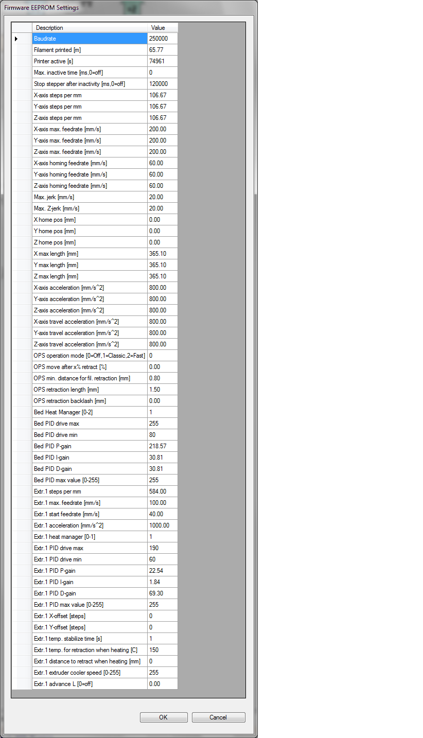

Here is what what I have my EEPROM settings:
I assume that since you reloaded the firmware that you have
#define EEPROM_MODE 1

Re: Movement distances are so off! HELP!
You can't set the motor gain in the EEPROMm, it's one of the few things that has to be set in the code.
the line reads
#define MOTOR_CURRENT {135, 135, 135, 135}
for a rambo 1.0 that's 0.75A I believe for an 1.1 it's much lower than that, I'd try 200, if it's too high the drivers will over heat and you'll either get the motors jittering or see missed steps sometimes minutes after you start a print.
the line reads
