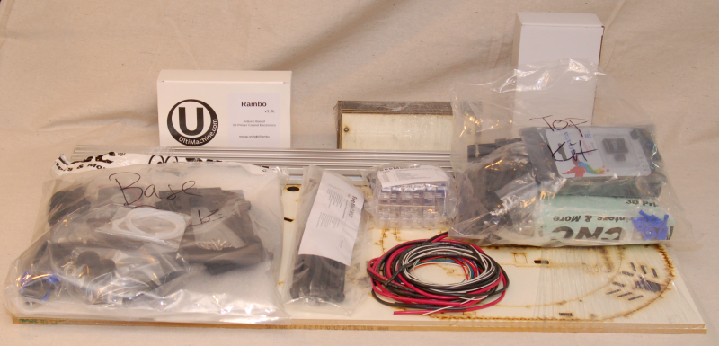

This is what the kit looks like when you get it. There may be some small packaging differences, but by and large, the image is representative of what you'll receive.
