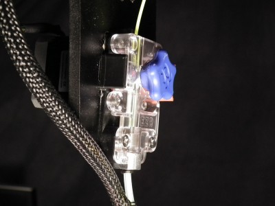

I received my EZRStruder this week and installed it today. My first impression are that it is a dramatic improvement over the EZStruder.
Initial impressions:
Very easy to install, even with no instructions. It eliminated the weird U shaped melanine spacers used for the EXStruder, and has the correct mounting screws, so the install looks a lot cleaner.
Without directions I was unsure how the align the hobbed gear with the idler. It was very hard to see how it aligns, so I put the gear on and ran some filament back and forth through the extruder by hand to "self align" the nitch with the filament path.
It aligns differently than the original hobbed gear, so you can't just swap the plastic because it does not align the same way. This meant taking off the existing hobbed gear and shattering the supplied hex key in the process (I guess the Loctite worked too good on the grub screw). I got the screw out by heating the hobbed gear with a lighter and then using a pair of pliers to hold a section of the broken hex key and turn the grub screw.
Once that was done the rest of the assembly is dead simple and obvious. It went together really quickly once I got past the hobbed gear.
Filament loading is 10000000 times easier than before. It basically self guides. You don't really even have to press the lever, just insert filament and wrist the knob. Magically the filament appears inside the Bowden tube.
It seems to grip stronger than the EZ struder. I can more easily manually extrude with the knob without slippage. Nice.
I mainly got it for the ease of entry, and loading, which is frustrating with the EXstruder, and was nicely surprised that it seems to drive better as well. I was happy with the existing EZ struder. It's well worth the investment.
I rarely print with flexible filament, but I may try this out sometime with the EZRStruder and see how it goes. The filament path is much more constrained and it looks like it will prevent binding.

I installed the new EZR Struder onto my Eris.
Turns out you have to remove the bottom of the Eris because of the way the two nuts on the far end of the extruder are mounted.
No big deal.
I reused the existing Hobbs gear, as it appeared to be identical to the new one.
The Bowden tube is long enough to reach into the extruder, so that's a non-issue
So the new extruder seems to be doing fine... much easier to load when mounted on the Eris.
Now if I can only get my Eris to calibrate properly... but that's for another thread.

Re: First look at the new EZR Struder!
The best way I've found to do this is to load a up a length of filament while the hobbed gear is loose and can slide around. Then you can kind of "floss" the filament back and forth through it to get the groove in the gear to align with the filament path, then just tighten it.U.S. Water Rockets wrote:Without directions I was unsure how the align the hobbed gear with the idler. It was very hard to see how it aligns, so I put the gear on and ran some filament back and forth through the extruder by hand to "self align" the nitch with the filament path.

Just thought I would tag back in with an update.
I discovered that the EZRstruder requires a SLIGHT modification to work with the geared steppers from TriDPrinting and their hobbed rollers. The oval hole in the red push lever needs to be modified to be more circular, otherwise the grub screw for the roller gets caught on the red arm.
I modified both of my EZRstruder red arms by dremeling the oval out to be more of a circle. So far, the added torque and stepper resolution increase has been awesome! Still just trying to dial in the proper settings for my cyclops, but that is a different story.

Can't you just loosen the grub screw, pull the hobbed roller off, flip it over and align it and then tighten the grub screw?lightninjay wrote:Just thought I would tag back in with an update.

Great question! Alas, I cannot. Once flipped, the grub screw does not come in contact with the geared stepper's shaft in order to be tightened down.
Had I just used a regular tradition EZstruder it would not have been an issue.
But since I chose to go with the newer EZ(R)struder with the geared stepper motors, the fatter stepper shaft and reconfigured 8mm ID hobbed roller create a scenario with a raised grub positioning screw.
Thus, I did something to the effect of this.
I would have preferred to just flip the roller, but I suppose one could just use shorter hob screws or attempt to grind theirs down a bit...

I actually took the time to grind down my set screws using a Dremel and a grinding disk. Now I have no issue with the set screw hitting the red release lever.bLiTzJoN wrote:Oh phew.. glad I'm not the only one that noticed the pinch point needing modification (seems flipped, should be more bite, not more roller). I got frustrated and swapped back to my old extruder that was working fine.
The EZRstruder seems to exert a more direct pressure on the filament than the EZstruder did. Could just be placebo, but, for this reason, I think the EZRstruder is a better pair for the higher torque of a geared stepper motor.
A few seconds of grinding on a set screw will get ya going in order to use the EZRstruder and a geared stepper motor with the larger hobbed gear. Or SeeMeCNC can slightly redesign their red levers, although this option may be unlikely due to the already sunk investment in their injection molds.
