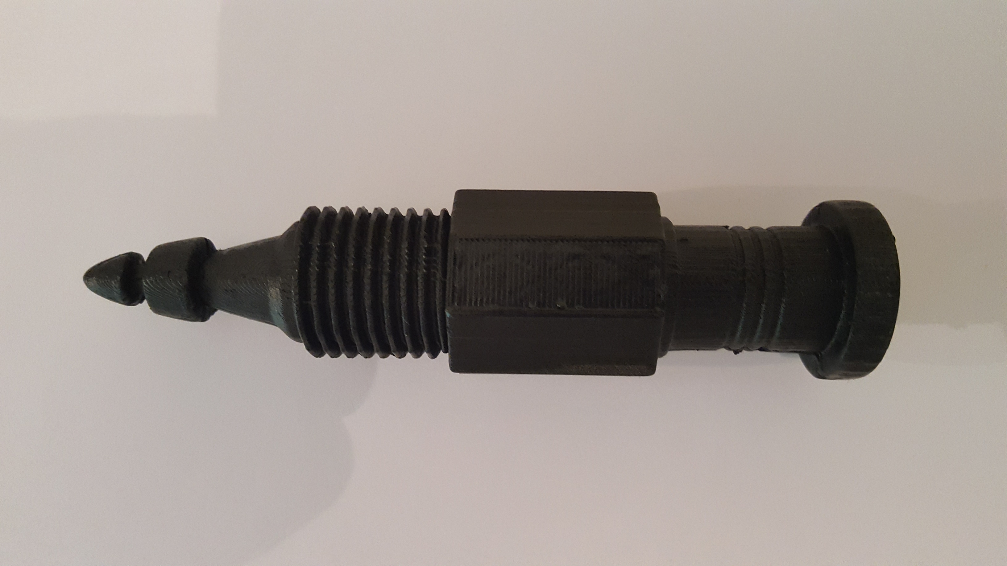

Definitely getting better quality prints with the heated enclosure.
Still some tweaking to do, but a much higher success rate

Not sure what the part is used for but you would have a nicer finish if you had oriented in upright position. With the head down touching the plate.Stevolution wrote:Definitely getting better quality prints with the heated enclosure.

I think they did it that way to avoid using support, you can kinda see it was sliced in half.

This was a 'supportless' print. If you print it vertically, then you have issues getting the support out of the thread.
Hey... its not warped, lifted, bent, unfinished or string. That can only be good

Pretty sure it will print nicely vertically with out support. The overhang is not that great. Give it a go. You may be surprised.Stevolution wrote:issues getting the support out of the thread.
Re: Max V2 heated enclosure
I think the threads would be fine (as in no support required) but I'm not sure how the larger overhang below that will turn out. It depends on which slicer you're using, It looks kinda like MatterSlice based on the top layer. I don't have a lot of experience with MatterSlice so I can't really comment.

I am using Matterslice, as Cura and Slic3r don't seem to work very well. Slic3r prints the part miles off target for some reason.
I am using Mattercontrol. I am sure there are better ways, but I don't know them yet.
The overhang is pretty big at the bottom of the hexagonal part. I doubt that will print unsupported
