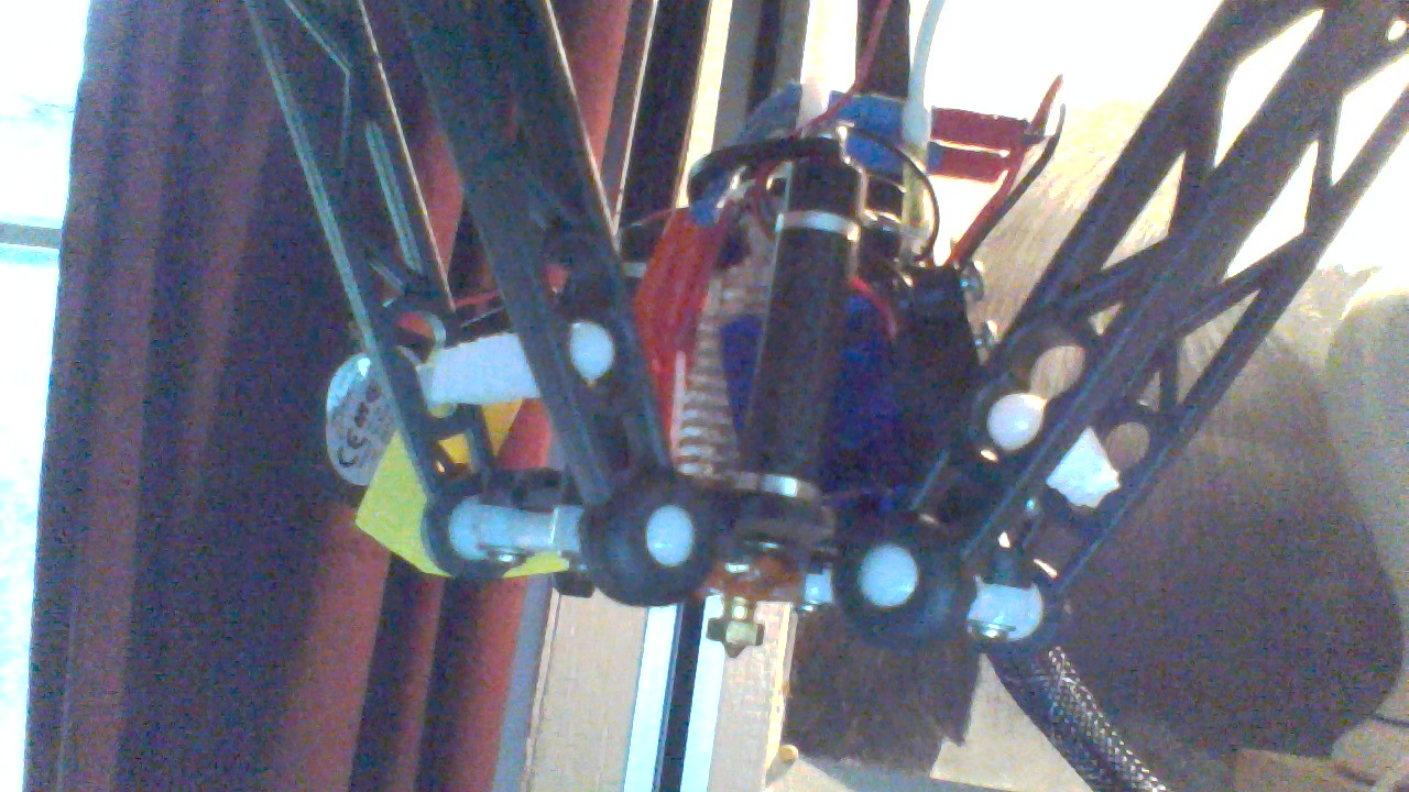

This is the best I can do, I screwed it in as much as possible. I have only used the parts the were sent to me with the e3d. Im going to attempt to get it screwed in further. I am considering upgrading to the pt100 sensor. I am not using a volcano.

OK.  I see at least two problems there.  Firstly, your fan duct is not installed flush, meaning it's directing a large amount of extra air flow onto the heater block.  Secondly, your heater block is up too high on the heatbreak.  Go ahead and remove the hotend for the moment (Unscrew the lower set of screws right now, leave it on the mount so you have an idea as to clearances).
Then go ahead and get it warm enough to remove your nozzle. Then let it cool down again. lower the heater block until the entire narrow portion of the heatbreak is visible, then warm it back up, and insert your nozzle. Let it warm up the nozzle, and then make sure it's tight. The nozzle should have minimal length visible, and no threads. Then make sure your fan is on and in place properly, with the duct entirely seated. It should look about like so when you're done.

Thank you for the walkthrough. My fan shroud melted previously, that's how it looks now. I ordered the pt100, new bowden for the e3d, and fan shroud today. I'm hoping to resume building my max v2 when the parts arrive. I'm abandoning the thermistor. I will certainly follow the directions when the newest parts arrive.
